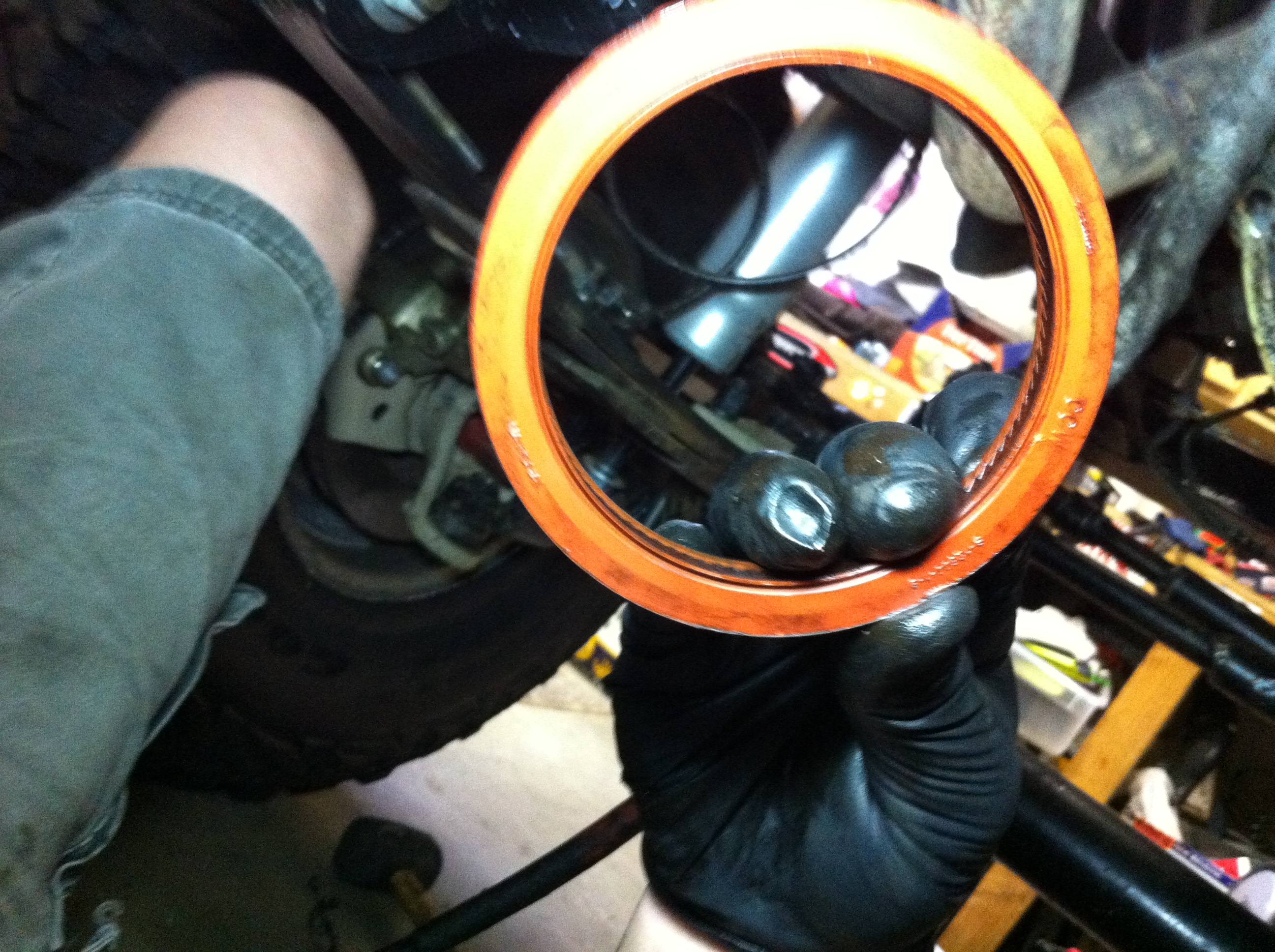

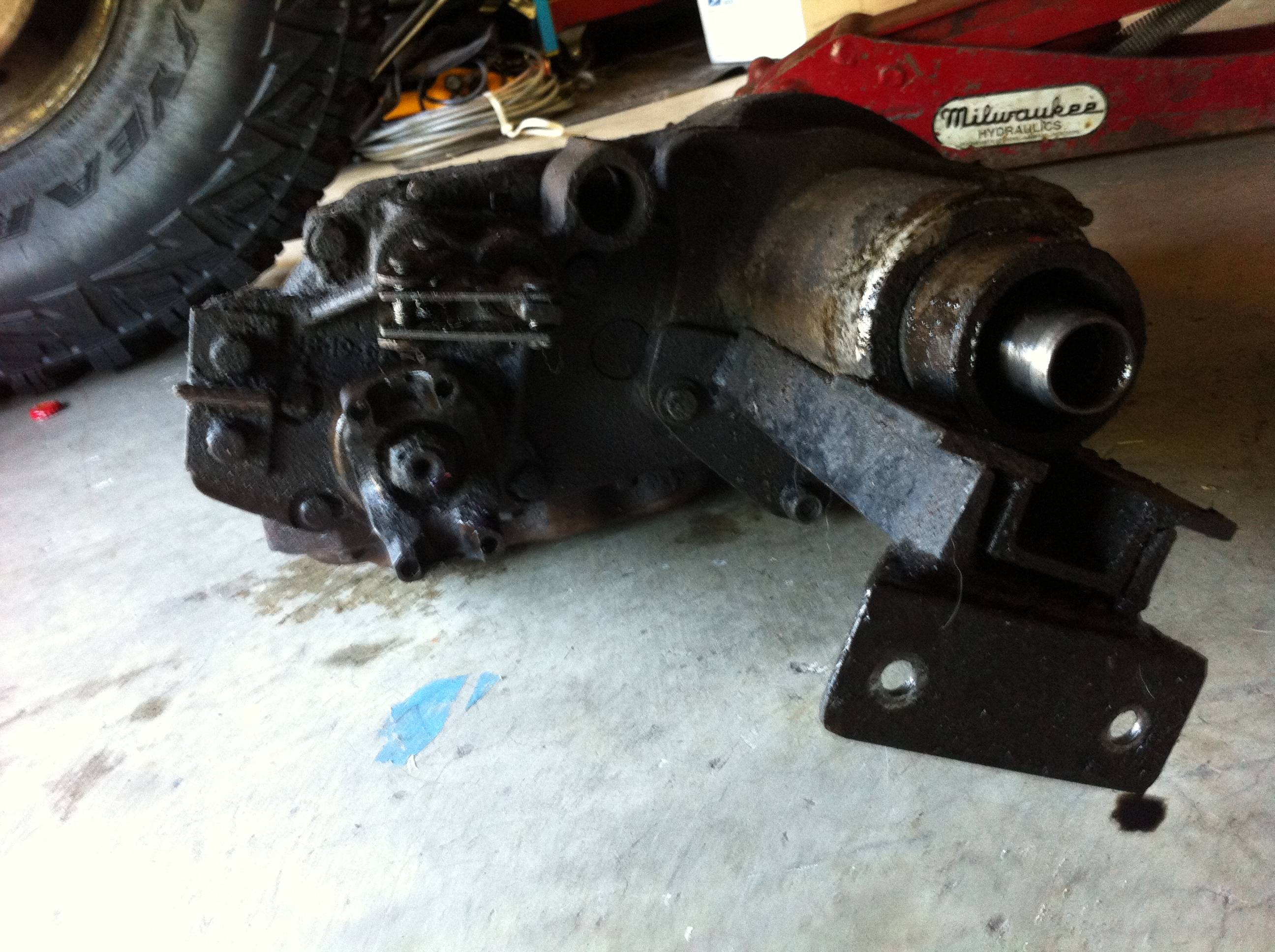

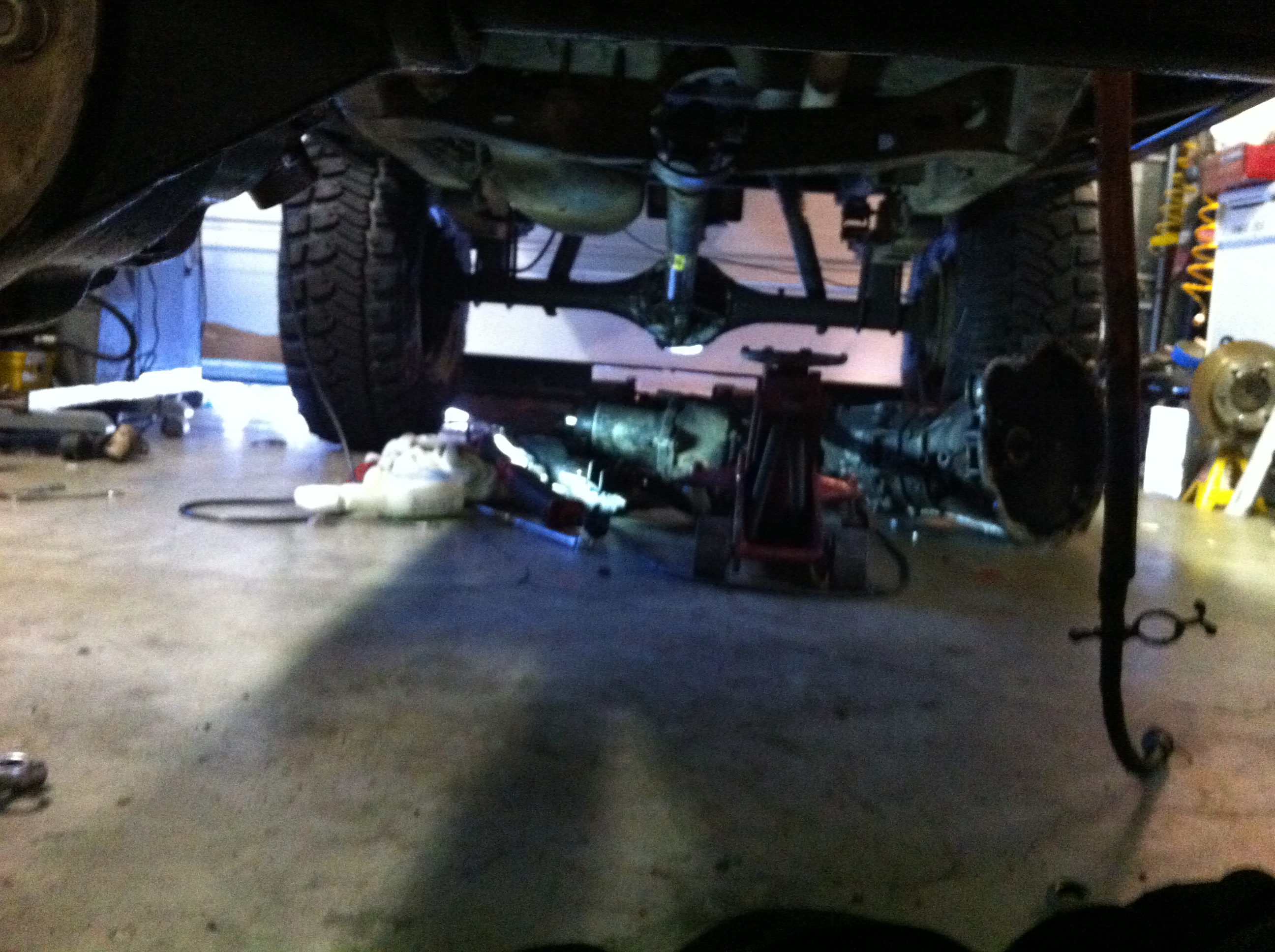

]2eDeYe Posted July 7, 2013 Author Report Share Posted July 7, 2013 Found the leak :rofl: Seal was still in perfect shape, put the new one in anyways. Random pics of the tcase adapter and drive train on the ground. :lol: Thanks again Nuff for the help. Went quick and easy. :thumbup: 1 Quote Link to comment

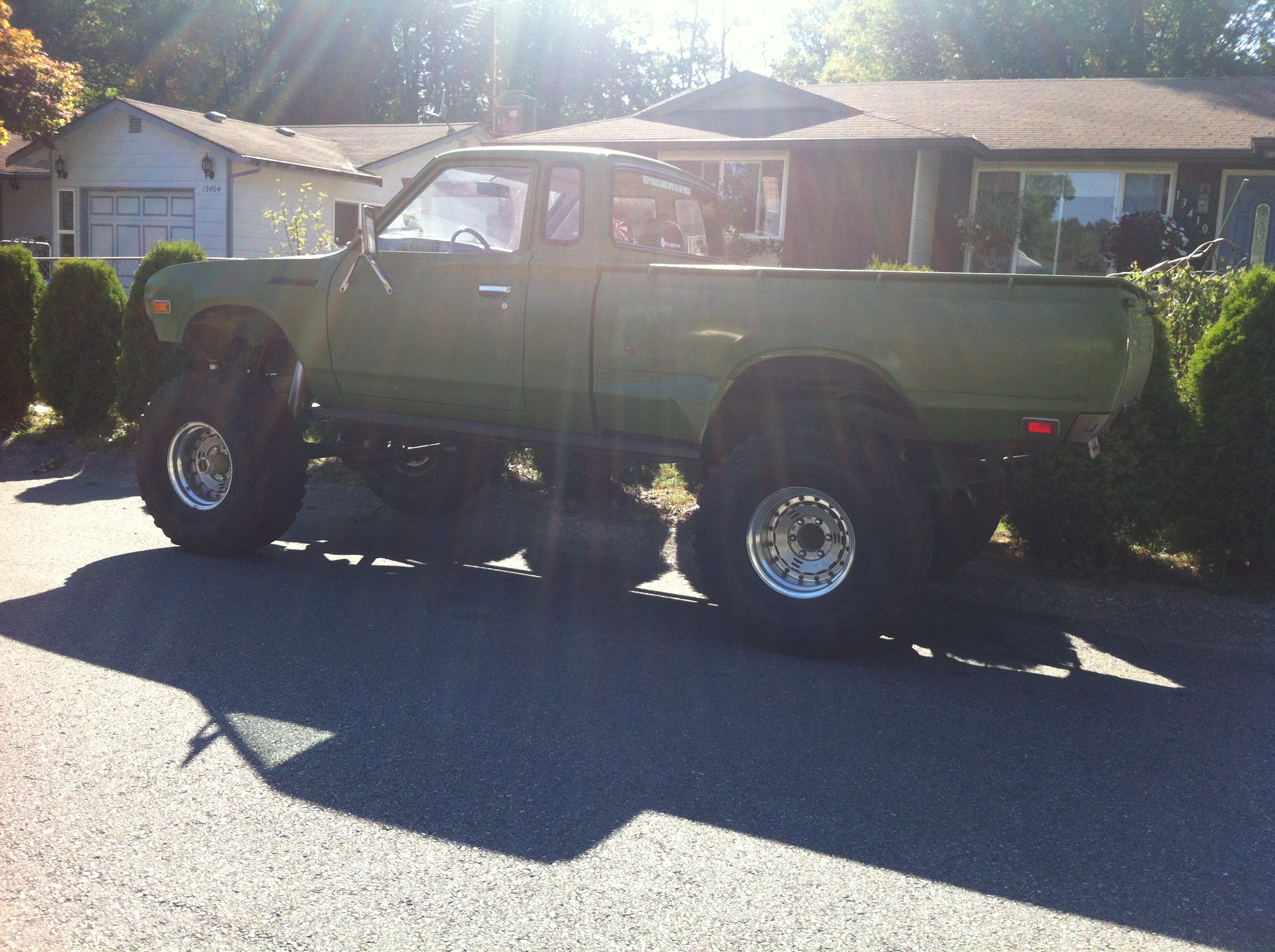

]2eDeYe Posted July 8, 2013 Author Report Share Posted July 8, 2013 No more leaks, shakedown run went well and I drove it into work today. Ready to go play in the woods. :D 4 Quote Link to comment

slodat Posted July 10, 2013 Report Share Posted July 10, 2013 So, what was the cause of the leak? I don't see it in the photo.. Quote Link to comment
q-tip Posted July 10, 2013 Report Share Posted July 10, 2013 Looks like the seal is not in its home Quote Link to comment
slodat Posted July 10, 2013 Report Share Posted July 10, 2013 Oh. I see it now. Seal wasn't in the block.. What caused that?? Quote Link to comment
philcas1987 Posted July 10, 2013 Report Share Posted July 10, 2013 I don't know but the last few orange seals I've put in ka have been loose. I can put them In easily. Quote Link to comment
Abe Froman Posted July 10, 2013 Report Share Posted July 10, 2013 2eDeYe" post="952292" timestamp="1373300610"] No more leaks, shakedown run went well and I drove it into work today. Ready to go play in the woods. :D This truck has sure been through a lot of changes, It really looks great ! Quote Link to comment
]2eDeYe Posted July 10, 2013 Author Report Share Posted July 10, 2013 Thanks man, it gets better and better. Really enjoying it. Did you replace the whole gasket and seal? my ka wont stop leaking its the second time around now, and i'm gonna be pulling the trans. trying to see if i'm missing something going on with these rear mains. The sealant on the housing was still good, the seal just popped out. I got a new one from Napa, made in Japan, that fit in there nice an tight. So, what was the cause of the leak? I don't see it in the photo.. I close looped the PCV system, it built up pressure and popped the seal right out. Got lucky, no permanent damage and no more leaks. Basically I am a lucky dumbass. :lol: I don't know but the last few orange seals I've put in ka have been loose. I can put them In easily. I was blown away when I saw it just sitting there on the crank. I thought for sure it was the sealing surface that blew out. The blue one I got from Napa was $11, $2 cheaper than the fel-pro orange one at Oreillys, said made in Japan on the UPC code sticker and was a day out. The local Nissan dealer wanted $40 and 3 days to ship. Just an FYI next time your in the market. Quote Link to comment

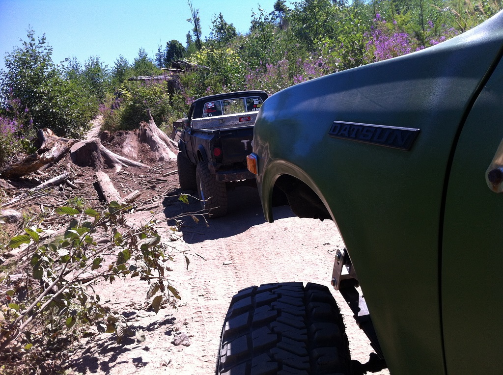

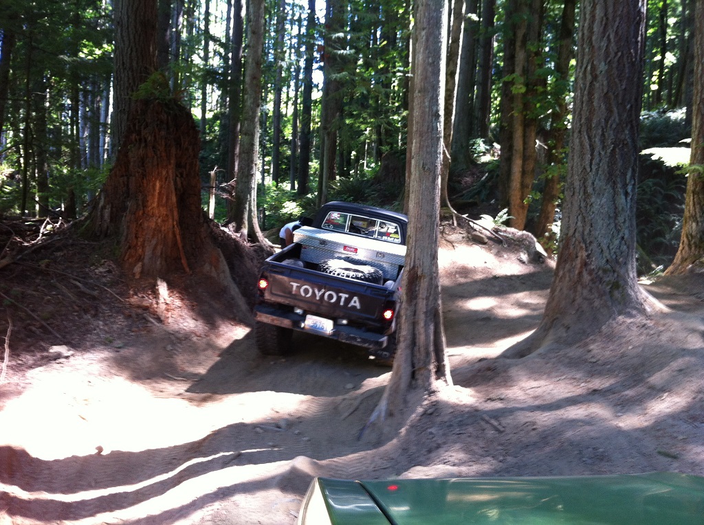

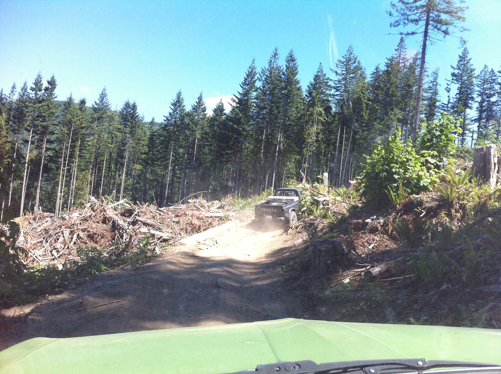

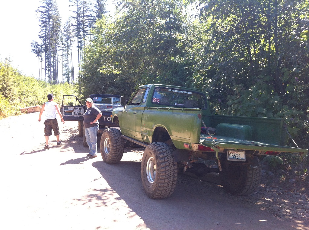

]2eDeYe Posted July 28, 2013 Author Report Share Posted July 28, 2013 Got to go play in the woods today. Me and Shonuff drove and my Mom rode along. Truck did real well, blew out the stupid rubber connector at the steering u-joint. Here's some pics. I got some good go pro video, but I need to edit it a bit. Nuff should have some good shots as well. Enjoy, I did. :) 4 Quote Link to comment

Shonuff Posted July 30, 2013 Report Share Posted July 30, 2013 wut, im recently single... are you saying that going wheeling and hiting on chicks is not what i should be doing for a weekend? :fu: anyways here is my side o the story, should hopefully be done with the short vid soon ish, im a slow editor en route ooh hey sweet datsun and swap meet i drove there, it really felt like i was way more flexed out when i parked it, posing fail. obligatory dog/wheeler shot then ratsun happend ive had one of these in my truck for years and every yota ive owned, never seen one break. im blaming the loose steering box and the surface area of the 720 column flange, yota one is flatter and has meta lthat mirrors the metal on the rag joint. if you wanna donor column lemme know then we added water to my instant yota work bench cut some shit (video) and blamo, easy bake oven looks legit... we're out i was impressed, the tires tucked in awesome. no kissing at all in the front and some bitchen self clearencing on the rear, need pics hippy :fu: 3 Quote Link to comment

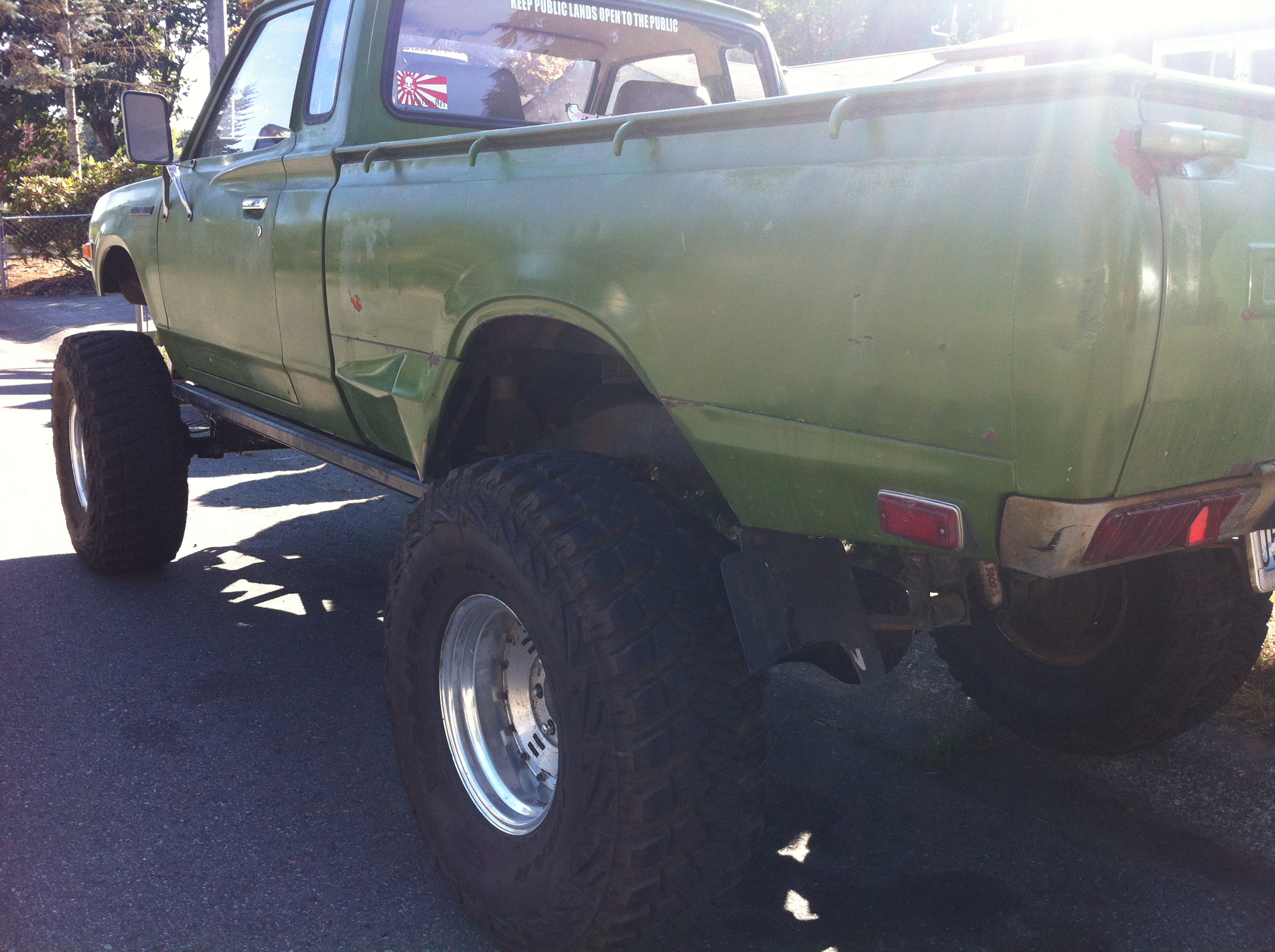

]2eDeYe Posted July 30, 2013 Author Report Share Posted July 30, 2013 ooh hey sweet datsun and swap meet ive had one of these in my truck for years and every yota ive owned, never seen one break. im blaming the loose steering box and the surface area of the 720 column flange, yota one is flatter and has meta lthat mirrors the metal on the rag joint. if you wanna donor column lemme know i was impressed, the tires tucked in awesome. no kissing at all in the front and some bitchen self clearencing on the rear, need pics hippy :fu: That red 620 was dope, quick with the camera. I didn't get mine out in time :lol: I'm hitting PaP after work today to get another yota steering joint. I can put two of the same ends on one joint as the splines are the same. I'll be sure to keep a photo record. I'll get a picture of the freshly flared bedside as well. It needs some massaging to look right. my truck sounds like yours... lol this looks like a ton of fun. i need to get the subi fixed so i can go wheelin.. :lol: KA's sound great, plenty of power too :D Quote Link to comment

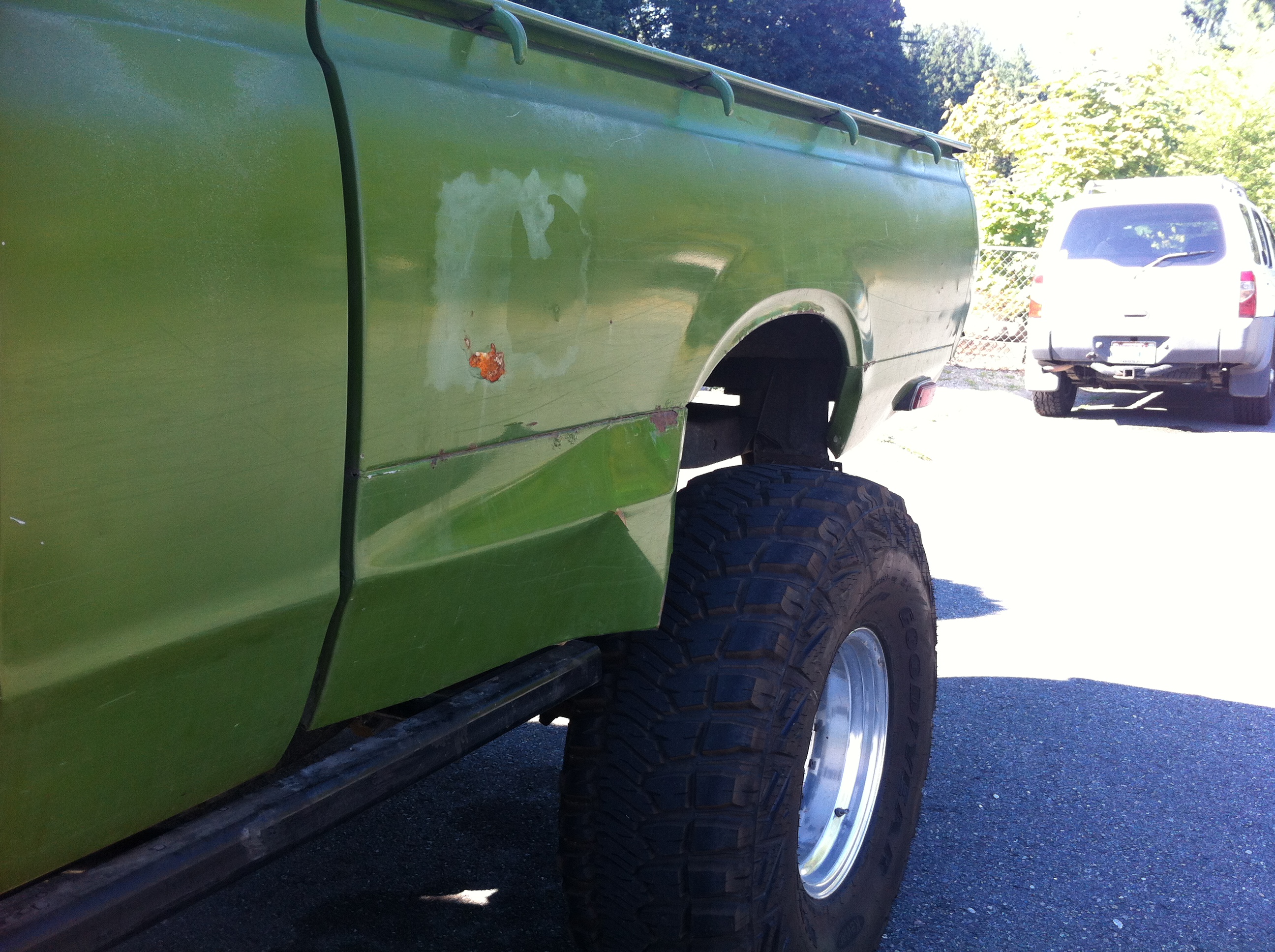

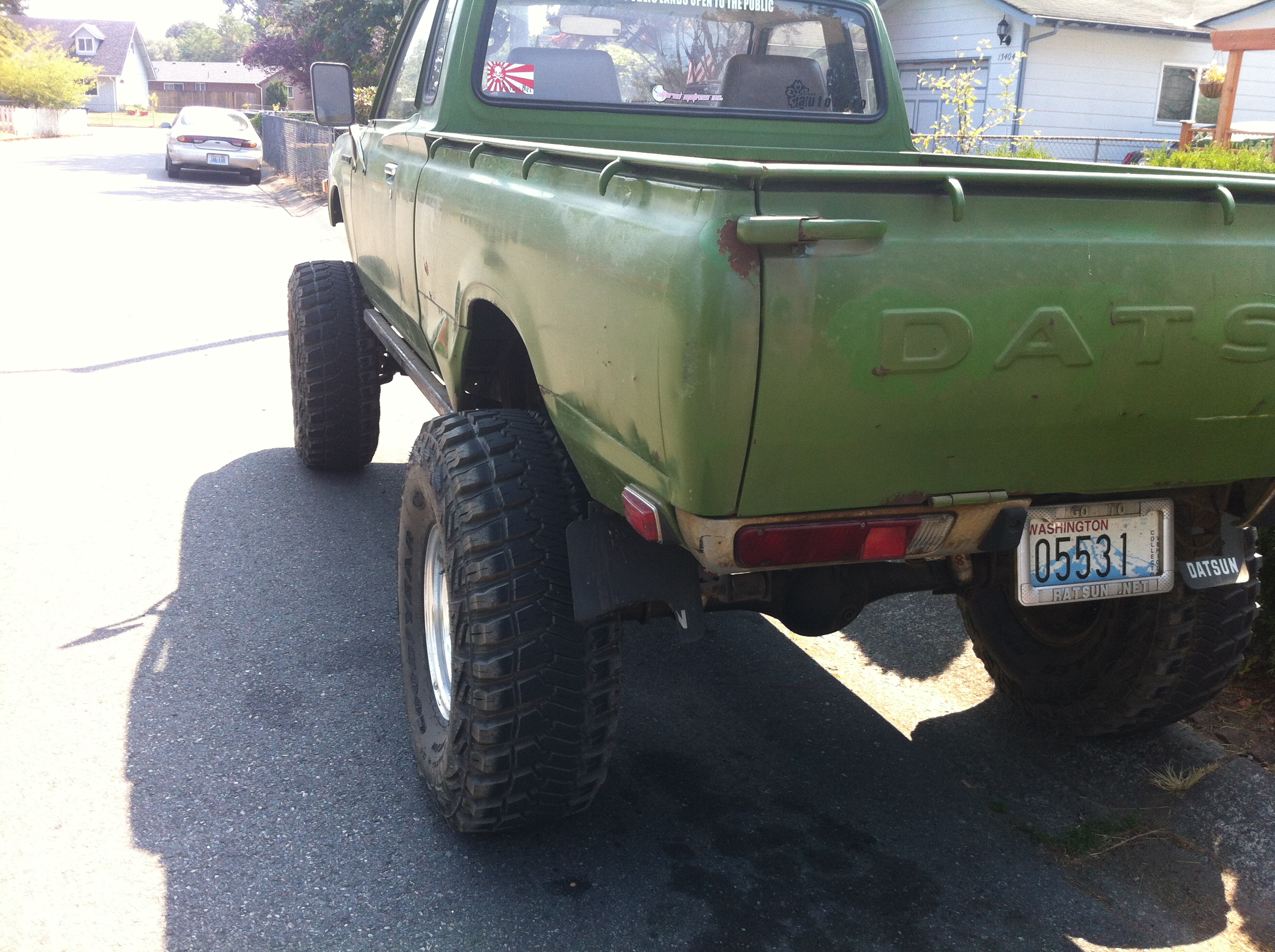

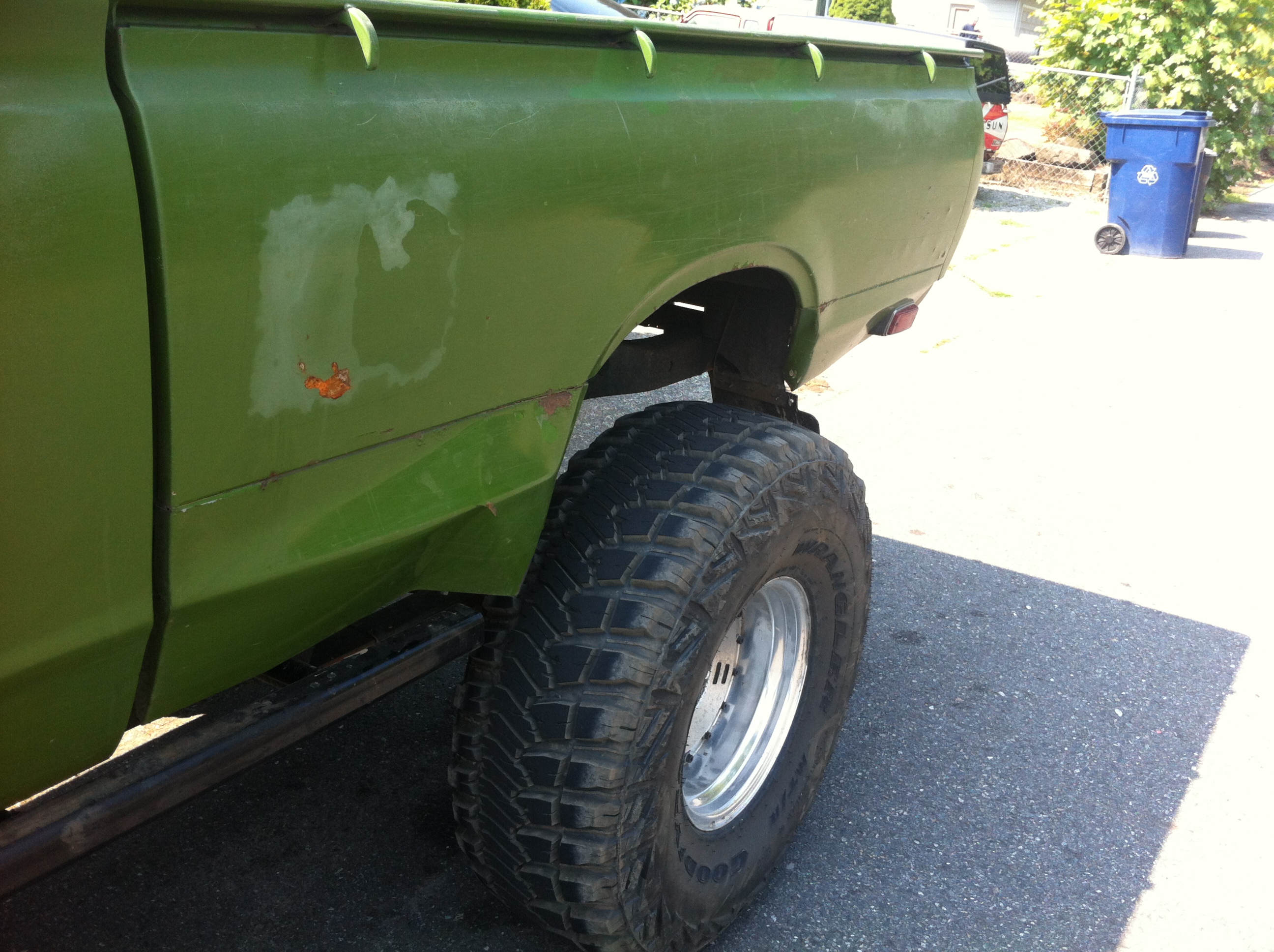

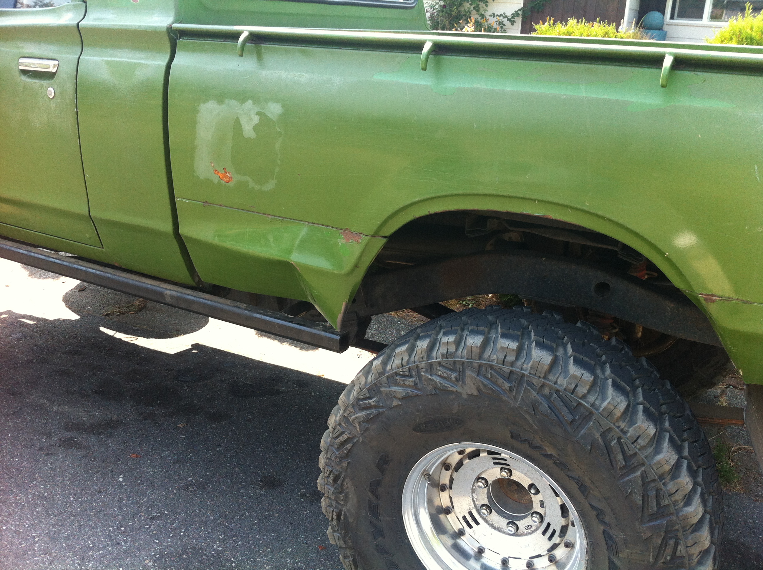

]2eDeYe Posted July 30, 2013 Author Report Share Posted July 30, 2013 Ok, got a couple shots of the self clearance/flare. This is the more dramatic side. This actually is working out pretty close to what I originally envisioned. I need to lengthen the support bar in front and pull this further out, The rear needs rolled a little and pulled out a bit. Should be good to go, if I end up not liking it I have spare lowers that I can modify more to my liking and weld on. I may end up sectioning the whole wheel well to make it longer, but this will do for now. 2 Quote Link to comment

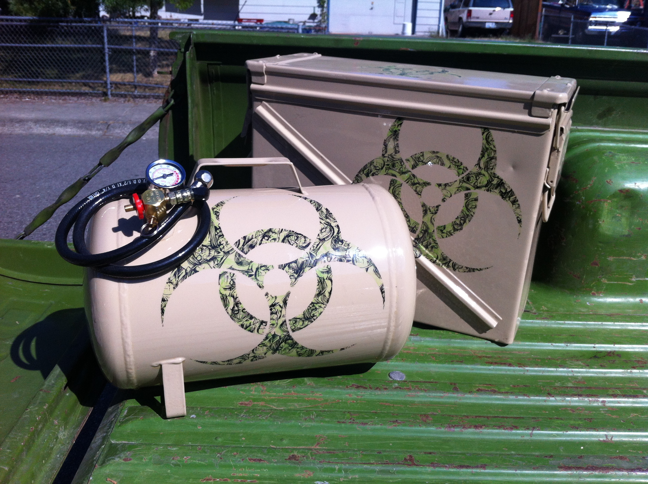

]2eDeYe Posted August 13, 2013 Author Report Share Posted August 13, 2013 Disconnected the support and gave it a pull. Not too bad. Picked some tan stuff up from Idol Rides, Brad added a bit of embellishment. :) Quote Link to comment
