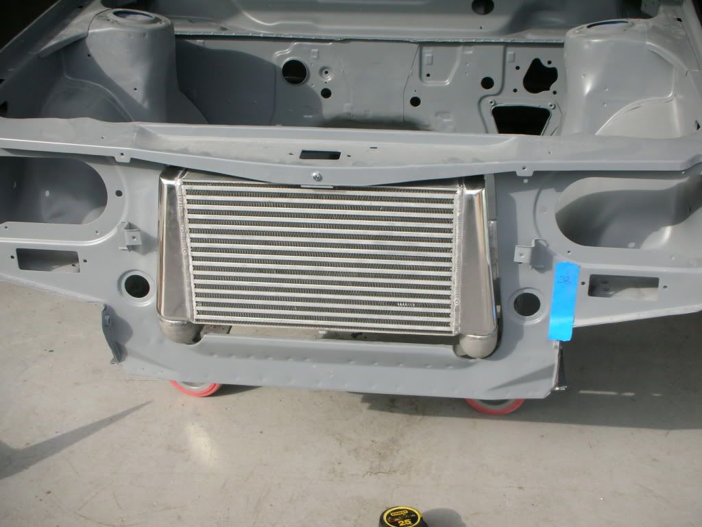

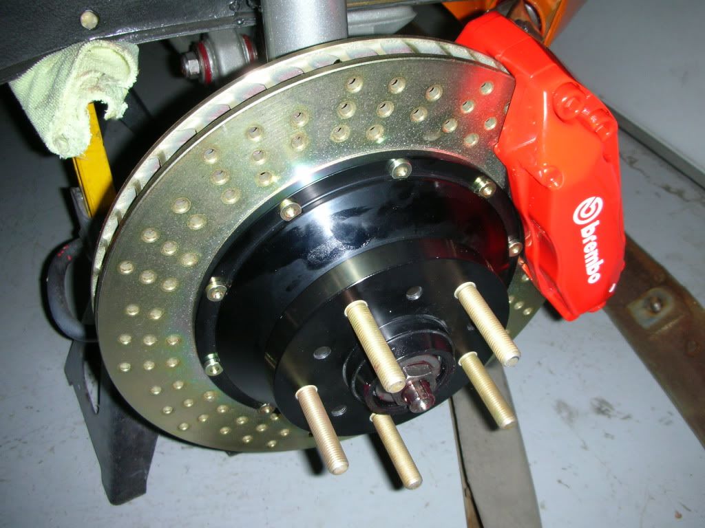

Cmac Posted January 27, 2011 Report Posted January 27, 2011 It all started with an 800.00 dollar purchase almost 5 years ago and the thought of my father and I looking at ex westwood race car for my first car and my dad telling me hell no! over 23 years ago. Its been allot of work and its still not to where I want it to be but its been fun to say the least. With the help and guidance when needed from fellow builders that have now become great friends its about time to have some fun with it this spring. In the beginning The Motor swap Back from the sand blaster TSR intercooler 3 Quote

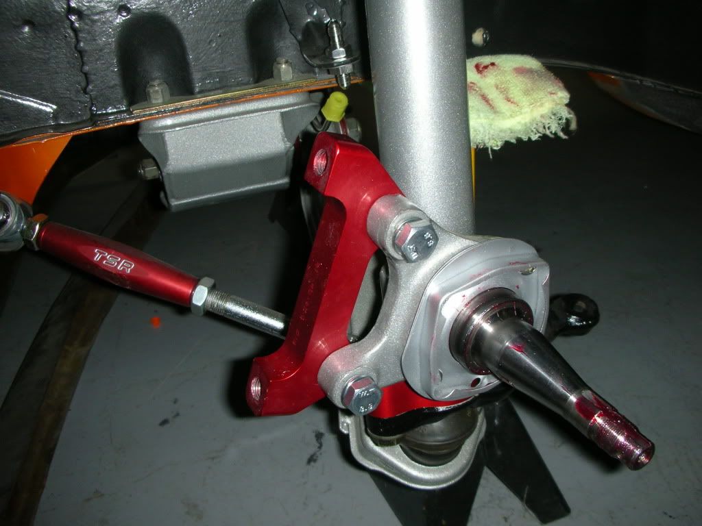

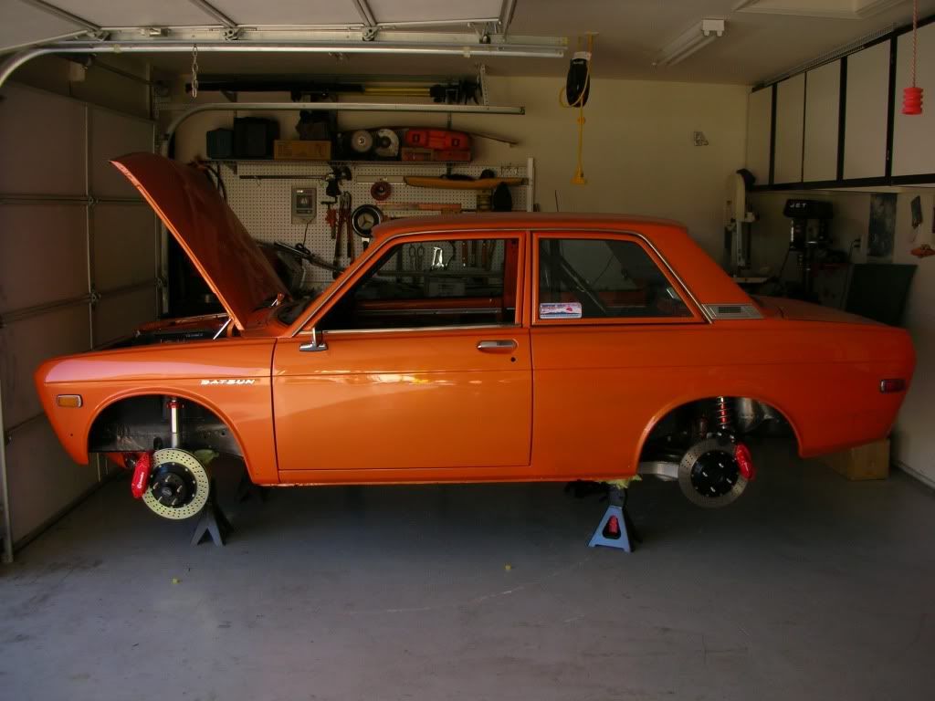

blueridgespeed Posted January 27, 2011 Report Posted January 27, 2011 WHOA! The Brembos (?) front and rear caught my eye! Can you tell us more about the brake mods. Are the TE37's 16's or did they need to be larger to clear? Quote
The Dat-side Posted January 27, 2011 Report Posted January 27, 2011 4 lug in the rear and 5 lug up front? Quote

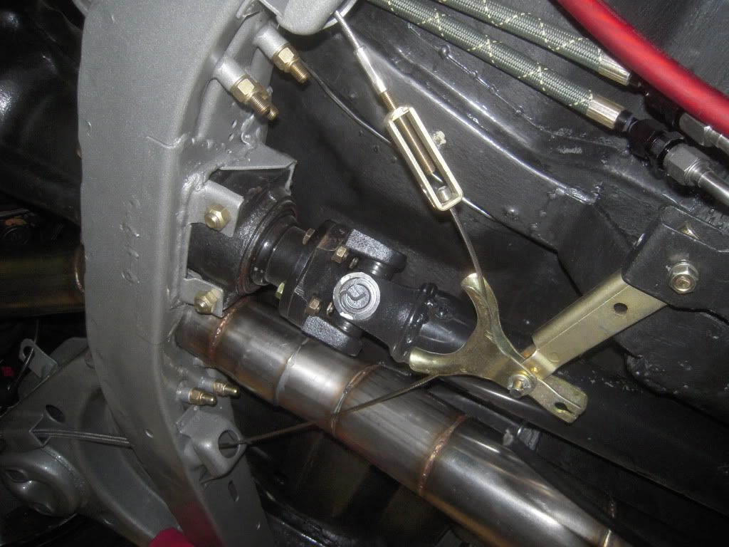

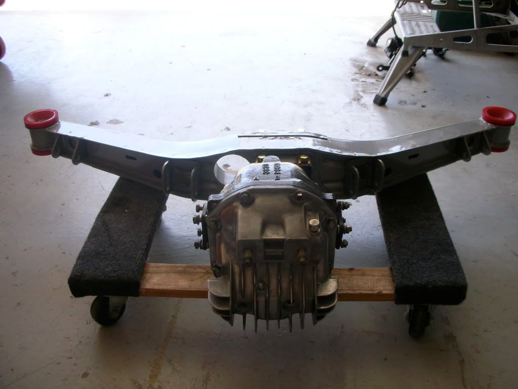

Cmac Posted January 28, 2011 Author Report Posted January 28, 2011 Wheels are 17" TE37 in Mag Blue 5 lug Brembo kits are for either 16" wheels or 17" wheels these photos are of the 16 inch kit since changed notice the gap between the rotter and caliper I dont have a photo of the rears at this time but you can either get the willwood parking brake or the brembo parking brake they are different brackets. TSR is your source Parking brakes DPR Racing rear crossmember, TSR stainless fuel lines, XRP Kevlar fuel lines Quote

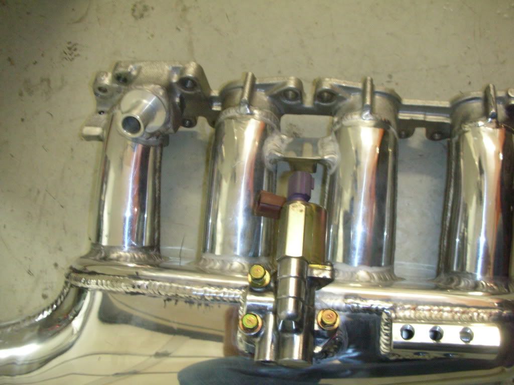

Cmac Posted January 28, 2011 Author Report Posted January 28, 2011 Log manifold in the making It was a bottom mount then changed to top mount. Intercooler piping Quote
Cmac Posted January 28, 2011 Author Report Posted January 28, 2011 escort racing intake manifold Quote

Laecaon Posted January 28, 2011 Report Posted January 28, 2011 So why did you go with opposite sided calipers? IE fronts have the caliper on the front, and backs have the caliper on the back side. Oh and this car is gorgeous! Quote
Cmac Posted January 28, 2011 Author Report Posted January 28, 2011 Ah caliper location you can mount your struts either forward or rear I mounted them forward and did not care for the look they are now mounted the other way. Others say it is better to have your brakes closer to center of gravity yet if you look at some of the super cars being built today they mount the calipers on the front, options are endless. Mario / TSR is still making parts for 510 and has never stopped he has developed some new parts as well that should be good to see this spring. He has spent most of his time completing some customers cars this year one of them requested a cv flanged carbon fiber drive shaft of all things it looks really cool. The other part is a r200 rear diff mount Quote
