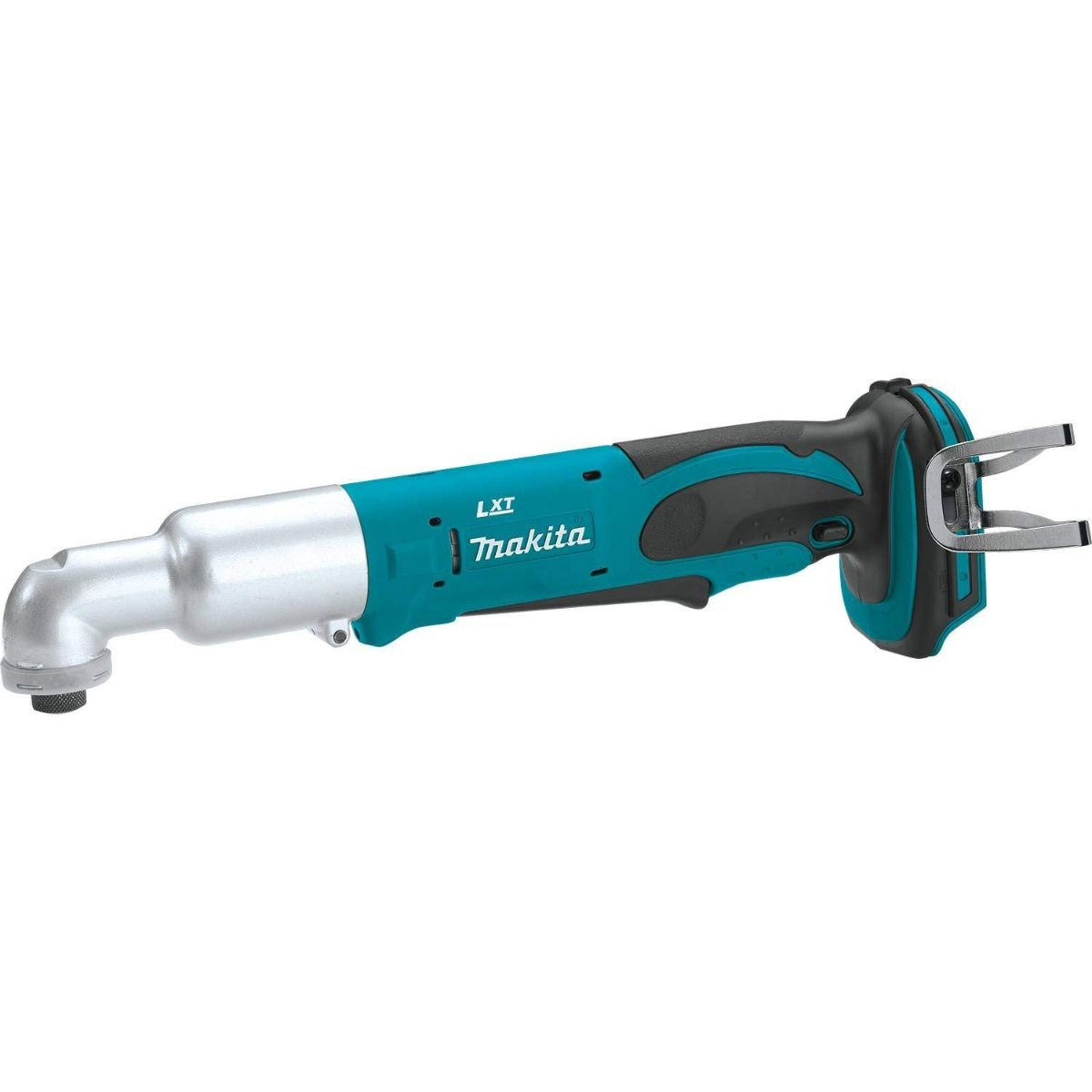

Stoffregen Motorsports Posted October 6, 2022 Report Share Posted October 6, 2022 A shorty phillips screwdriver will get in close enough to get those dash screws out. Quote Link to comment
datzenmike Posted October 6, 2022 Report Share Posted October 6, 2022 I tried that but couldn't grip it tight enough to turn and push down on it enough. I used and L shaped screwdriver. Quote Link to comment
Stoffregen Motorsports Posted October 7, 2022 Report Share Posted October 7, 2022 19 hours ago, datzenmike said: I tried that but couldn't grip it tight enough to turn and push down on it enough. I used and L shaped screwdriver. Another reason I love Snap-On tools. The screwdrivers grip better than hardware store tools. Quote Link to comment
