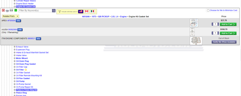

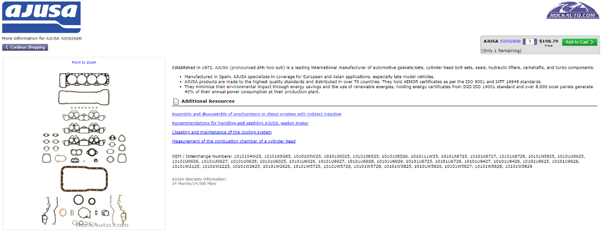

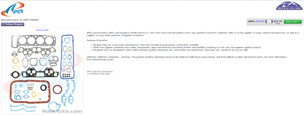

Jskinny Posted June 23, 2023 Author Report Share Posted June 23, 2023 Need to get a few gaskets, why not get a whole set? But why would there be such a big price difference between the 2?? Only seems to be a minor increase in selection for the 200$ set. Kind of sketched out by the apex set if its that cheap... Quote Link to comment

banzai510(hainz) Posted June 23, 2023 Report Share Posted June 23, 2023 200 is too much. depends on what is really needed. alot is not used. Quote Link to comment
Stoffregen Motorsports Posted June 23, 2023 Report Share Posted June 23, 2023 10 hours ago, Jskinny said: Need to get a few gaskets, why not get a whole set? But why would there be such a big price difference between the 2?? Only seems to be a minor increase in selection for the 200$ set. Kind of sketched out by the apex set if its that cheap... Those blue paper gaskets for the front cover are the first sign of crap. The oil pan gasket looks to be more paper than cork. Another bad sign. Quote Link to comment
