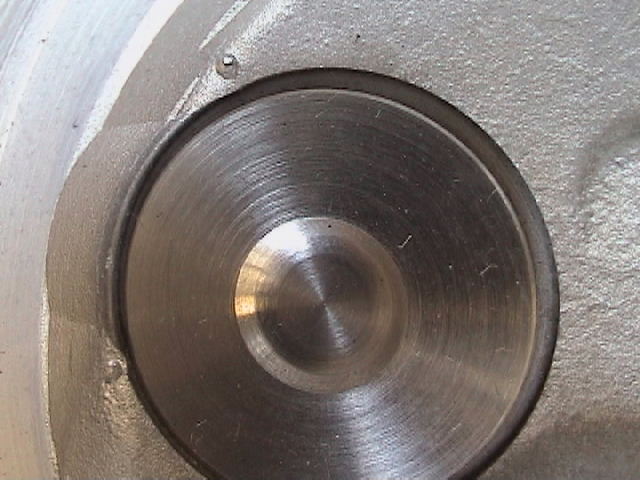

Atikin9000 Posted September 22, 2017 Report Posted September 22, 2017 Like title says, picked this truck up not to long ago, pulled plugs, found this in #3. My question is, from the picture if anyone can tell what it is. https://m.imgur.com/a/12n4f 1 Quote
datzenmike Posted September 22, 2017 Report Posted September 22, 2017 Valve seat? Get a piece of fence wire and bend a hook in the end and try to fish it out. This will tell you more. 2 Quote
Atikin9000 Posted September 22, 2017 Author Report Posted September 22, 2017 Valve seat? Get a piece of fence wire and bend a hook in the end and try to fish it out. This will tell you more. Thanks man, it's looking like a valve seat, gonna attempt to fish it tomorrow, just wondering what my next approach should be lol. 1 Quote

datzenmike Posted September 22, 2017 Report Posted September 22, 2017 Do not run the engine. It may already have already pounded the seat area to shit and the head in not repairable. Seats fall out for at least these two reasons... The engine was severely overheated. The valve seat and the head seat area are an interference fit. The heads are baked to 350F in and oven to expand the seat hole. The valve seats are frozen to shrink them and then assembled. When at room temperature they cannot be removed. The were replaced previously by an incompetent shop that didn't know how to properly do this replacement. When you remove the head, look in the combustion chamber around the valve seats. If they were staked in place and punch marks are showing this is why. 2 Quote
Atikin9000 Posted September 22, 2017 Author Report Posted September 22, 2017 Do not run the engine. It may already have already pounded the seat area to shit and the head in not repairable. Seats fall out for at least these two reasons... The engine was severely overheated. The valve seat and the head seat area are an interference fit. The heads are baked to 350F in and oven to expand the seat hole. The valve seats are frozen to shrink them and then assembled. When at room temperature they cannot be removed. The were replaced previously by an incompetent shop that didn't know how to properly do this replacement. When you remove the head, look in the combustion chamber around the valve seats. If they were staked in place and punch marks are showing this is why. PO said he checked the plugs and that they were fouled told me the carb just needed messing with,and he was running it when I showed up to buy it, I took his word(my bad), then spent all day yesterday turning it over and getting it to fire a couple times cause I was messing with the carb. Then comes today I took the plugs out and found that. Engine spins free and the piece of what ever it is is loose in there. 1 Quote

distributorguy Posted September 22, 2017 Report Posted September 22, 2017 A valve seat won't make it past the installed valve, until the head breaks off of the stem. That looks more like someone let debris get down the carb throat. Either way, the piston and cylinder wall will likely be pretty beat up - not to mention the combustion chamber, valves, seats, etc... Focus on pulling the head to make repairs. If you want to see what's wrong, lower the piston in the cylinder around an inch and take a look. 2 Quote
flyerdan Posted September 22, 2017 Report Posted September 22, 2017 It looks more like a piece of piston ring rather than valve seat, radius isn't tight enough. First step is getting it out, either a small magnet telescope tool or maybe you can grab it with a hemostat. Once it's out, it can hopefully be identified. If it's not a piece of the engine broken off, but something ingested through the carb, maybe source a borescope to check for FOD, you might luck out and not have to tear it down. 1 Quote
datzenmike Posted September 22, 2017 Report Posted September 22, 2017 Agreed the seat won't come off the valve unless something breaks but you might still easily see it through the plug hole. If it came through the carb and got past an intake valve it can only be so big to fit. If a seat, (I don't think ring fragment because a lot of piston would have come with it, someone wound have noticed the smoke and blow by) take the valve cover off. That cylinder will have a compressed valve spring because it can't close. The rocker arm and lash pad may also have flown off. 1 Quote

wayno Posted September 22, 2017 Report Posted September 22, 2017 I was thinking it could be a valve seat, but it seems like the seat would have to be broken and caught in the valve for it to get that far over to show in the spark plug hole as the valve shaft is fairly large down low, it would then hold the valve down and make the rocker arm very loose, if the seat had broken and not got caught in a valve then the valve would be very high compared to the others like what happens when they sink into the head and you lose all adjustment. If it was a ring piece I would have thought it would have less curve to it, same if it were a piece of the top edge of the piston. Is the piston holding that piece up there, or is it caught in the valve? 1 Quote

Atikin9000 Posted September 22, 2017 Author Report Posted September 22, 2017 I only had a minute to look over it this morning and upon further investigation, it looks like a valve seat and it's in one piece, turned it over by hand so the piston would drop and the ring stayed in one place looks like it's hanging off the valve, valve spring worked though, the supposed ring seems jammed hard now, tried to fish it out but it won't move and seems very whole to come out of the sprarkplug hole. Piston had some scaring. When I have some time next I'll pull the head. 1 Quote
Charlie69 Posted September 23, 2017 Report Posted September 23, 2017 Pull the head it could have scored the cylinder wall and or beat up the head and the piston. 2 Quote
distributorguy Posted September 26, 2017 Report Posted September 26, 2017 "Will have" scored the piston, likely won't have touched the cylinder walls, definitely bent the valve, definitely beat up the head. The piston may be fine, but the head is going to get expensive to repair. Likely welding to get a seat to take after it released then pounded against the head every time the valve opened and closed. You'll need someone who can weld aluminum AND has a Serdi head bench to cut the head for a new seat. Valves are cheap. 1 Quote
