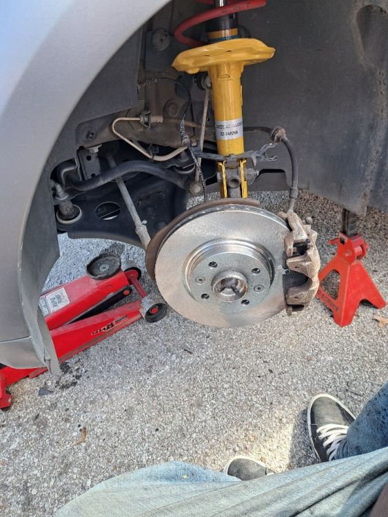

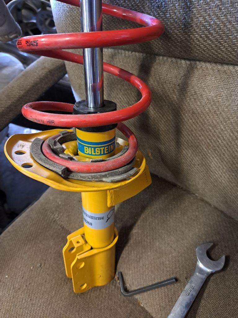

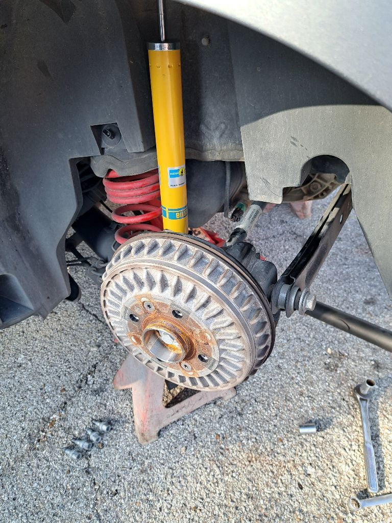

Parts arrived!
On 9/12/2023 at 7:56 PM, dimlight65 said:

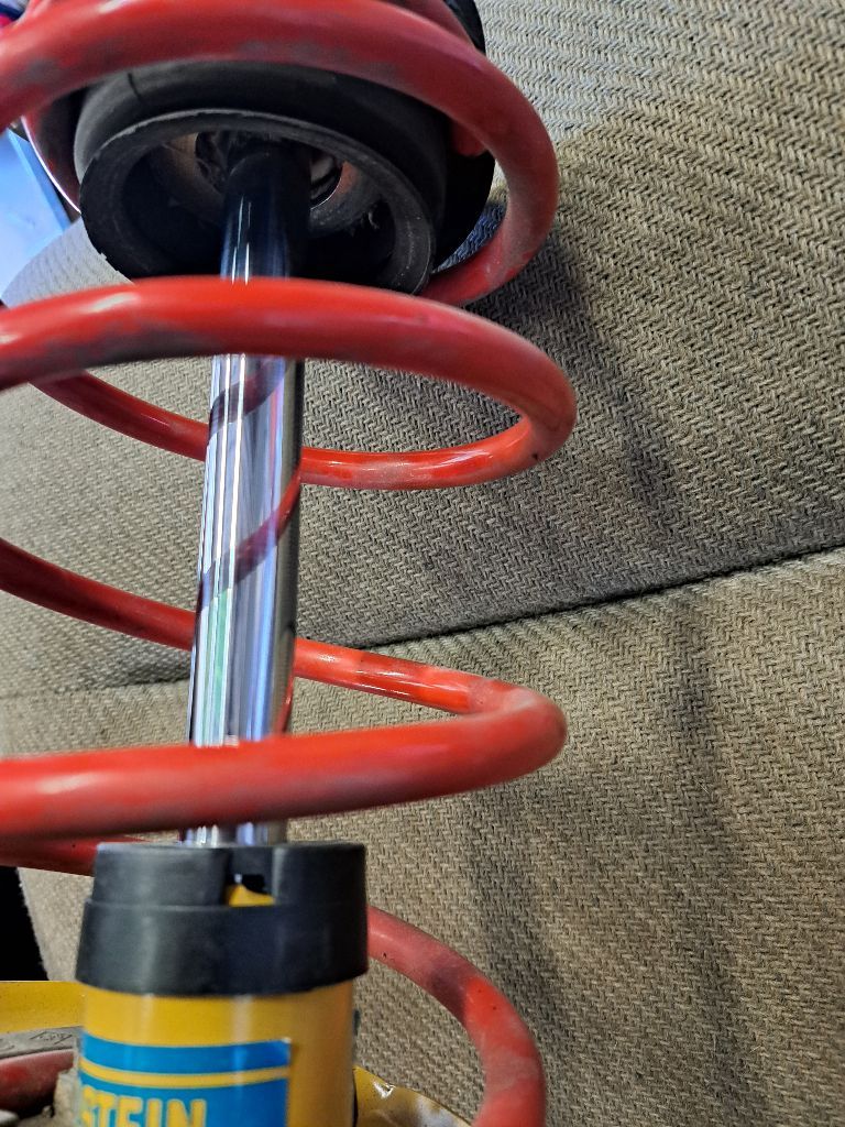

shocks & struts...
I have been sitting on these parts for almost a month now, waiting to get the Dajiban back on the road.  Well, today was 80,000 mile oil change day.  When we saw this...
John said to me, "Young lady, you are not leaving the house dressed like that!" or... something to that effect.  Needles to say, we* installed the new shocks...
as well as struts...
and front brakes...
The rear drums and shoes were fine.  I'm going to sit on the new drums and shoes until the next time we do the front brakes... probably.

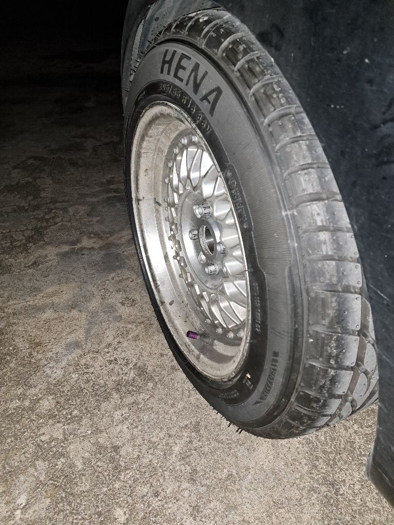

While we ate lunch, a local tire shop installed a pair of new 205-55/15 tires on the rear...
They are round, black, hold air, and make the car go around turns.  Good enough is good enough!
Speaking of going around turns, I took a detour on the way home and drove one of my favorite twisty roads.  I didn't think I was going that fast, but the electronic nannies sure did!  I probably need to check the pressure in those rears, now that I think about it.  I'll bet they are up around 60psi!
*and by "we", I mean John totally did all the hard work while I changed the oil.

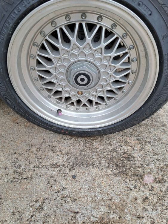

I decided to put the center caps back on finally.
The cap-head screws that came with the wheels broke through on two of the cap so I replaced them...
I'm not sure about the gold tone of my replacement bolts though...
I think they will be ok, especially if I stop pointing them out... probably.

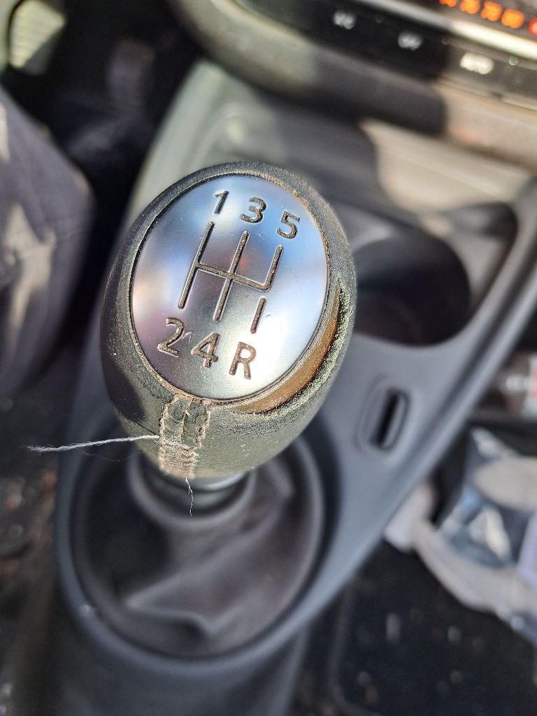

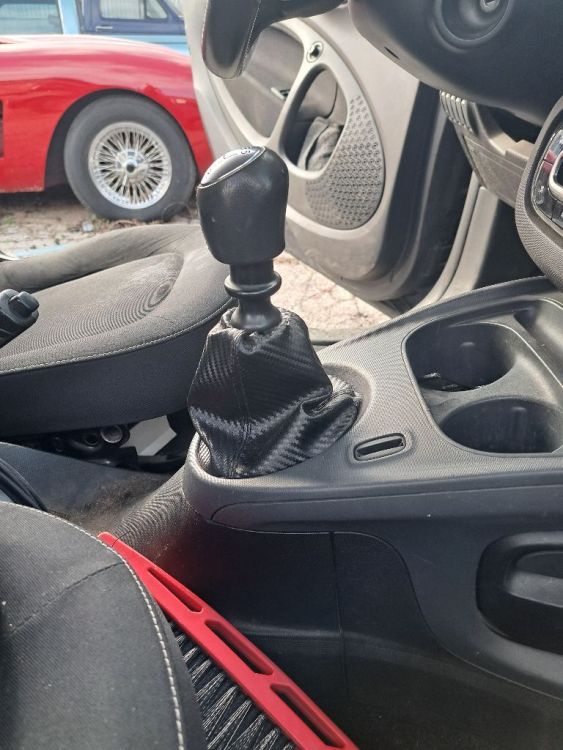

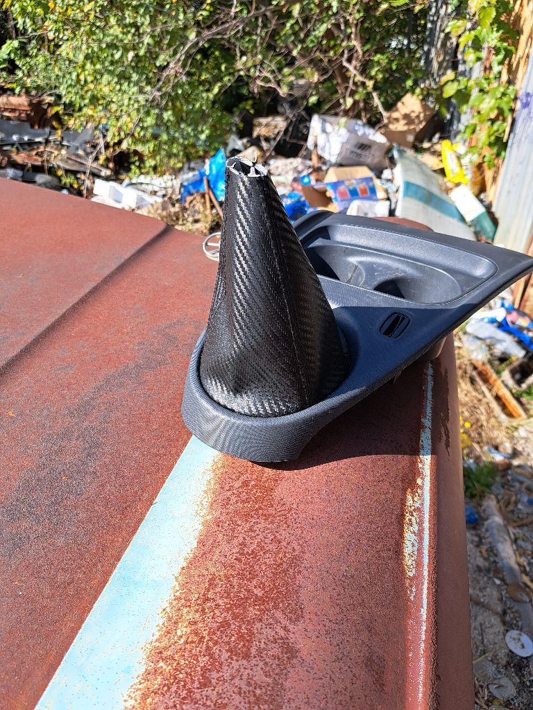

The leather on the shift ball began to separate...

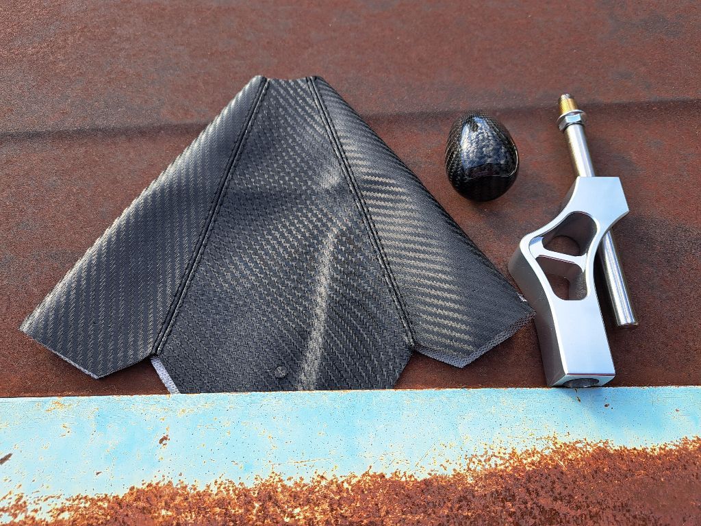

so I bought some "Mad Tight Drifter" (or "Rice Boy" if you'd rather) parts...
I cut the excess rod off...
so the "carbon fiber" ball would sit like this...

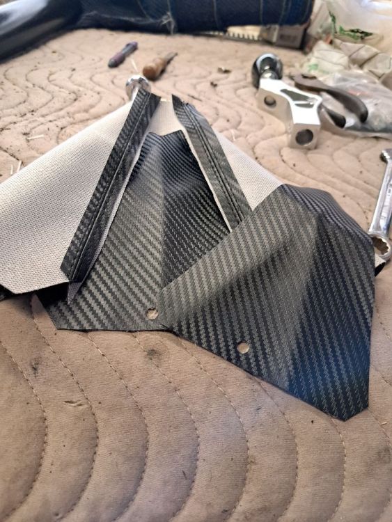

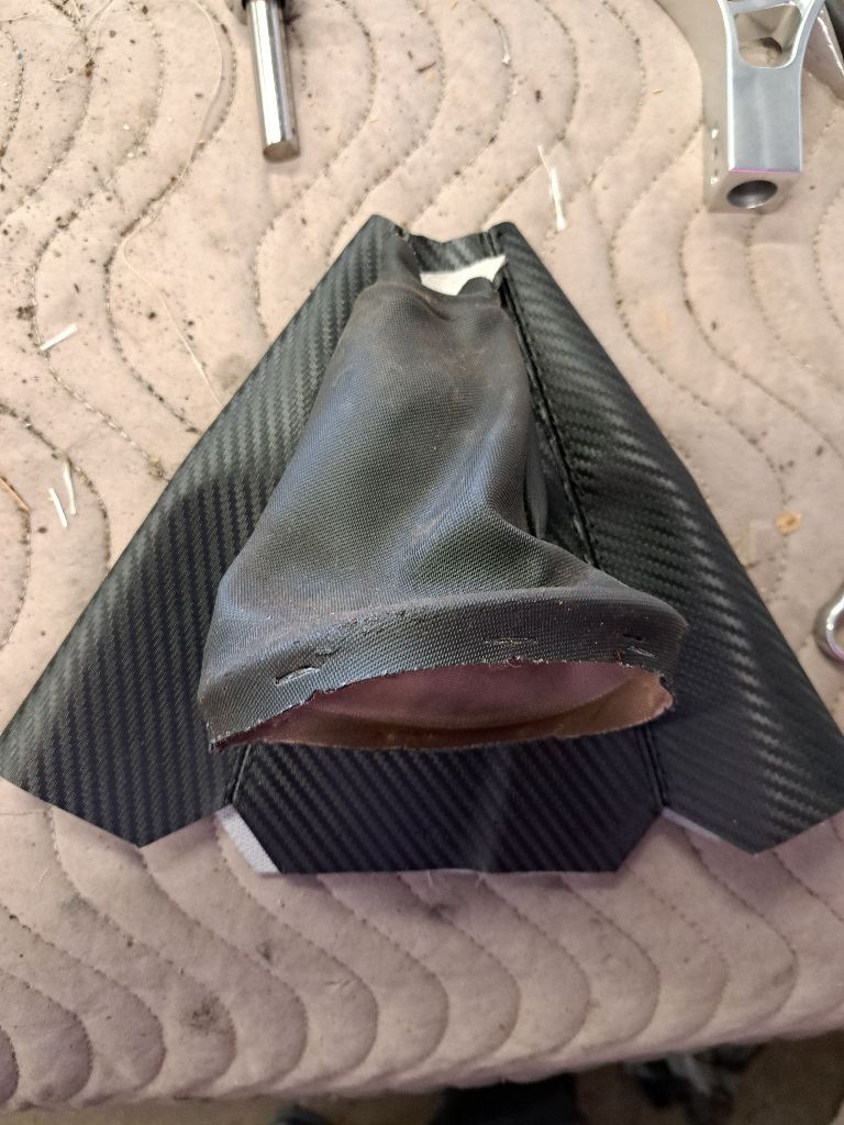

Then I pulled the console and old gaiter out...
and compared the "carbon fiber" gaiter to the original...
With the removal of one panel of "carbon fiber"...

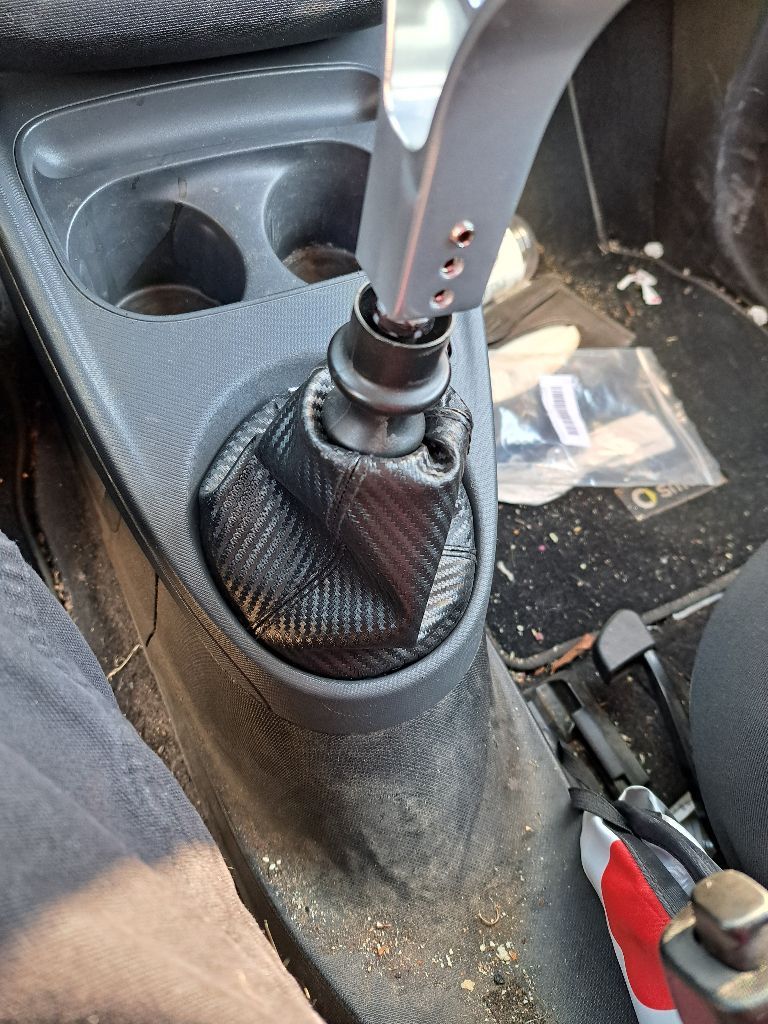

the new gaiter went into the console...
I then popped the console and new gaiter back into the car...
and installed the "MTD" (or "RB" if you prefer) shift knob bits...
As with the Bride gaiter I just put in the Dajiban, I'm not 100% happy with how I bunched up the attachment to the stick.  I may re-do it to make it "blouse" better next trip to the shop.  We'll see.

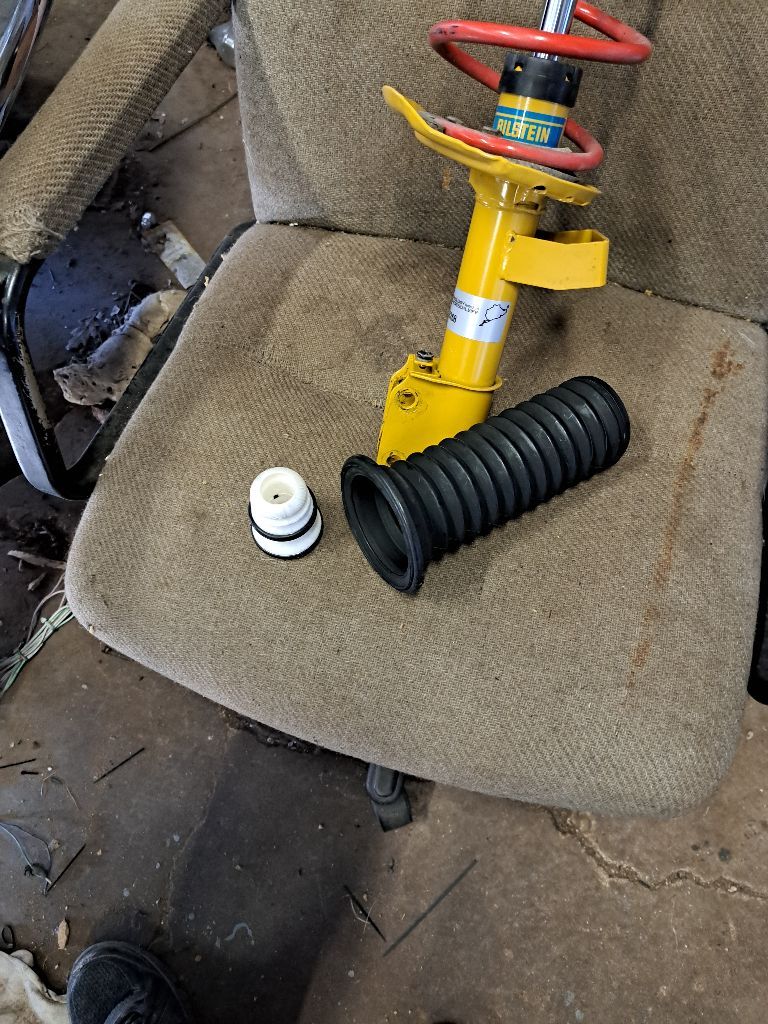

I went for a hoon a couple weeks ago and afterwards the front end started clunking at low speeds.  The freeway was fine (or at least I couldn't hear it clunking) but surface streets were really bad.  We tried lots of things to narrow down what it could be and finally decided that the bump stops and gaiters really were important.  We're getting pretty good at removing all the gubbins to access the top of the struts!
If you look closely, you can see where the bump stop is supposed to be and how not having it could cause all kinds of camber and caster movement...
So these (which for Mercedes parts were reasonable at about $50 per side)...
totally solved the clunking problem.  I'm quite chuffed.

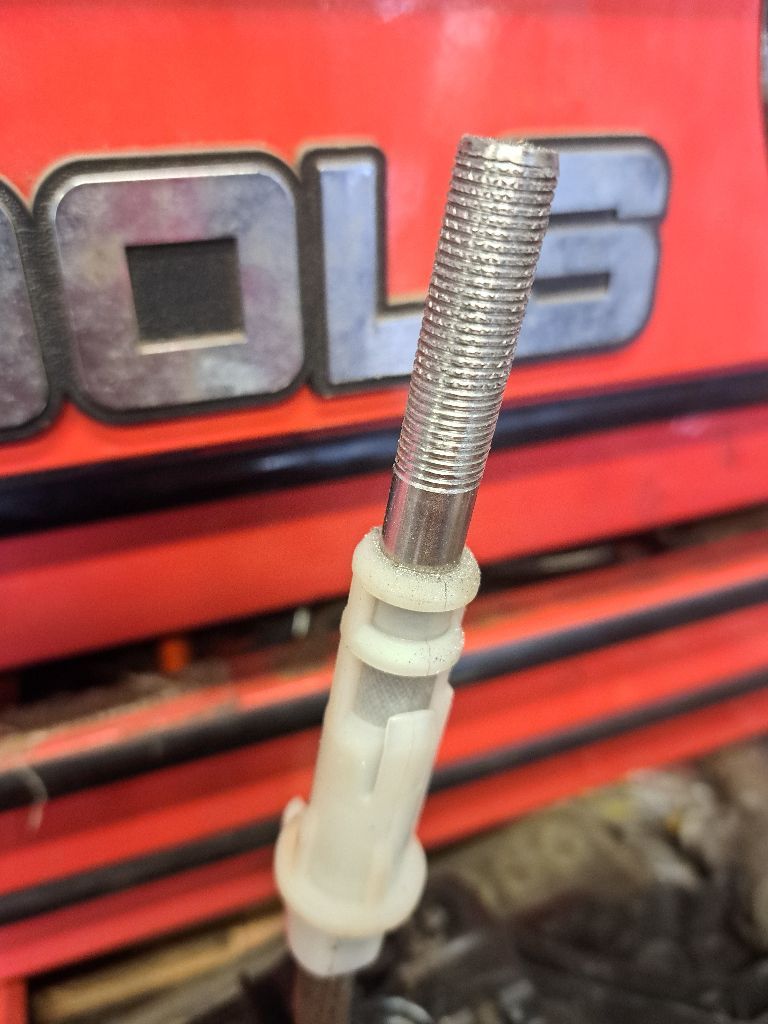

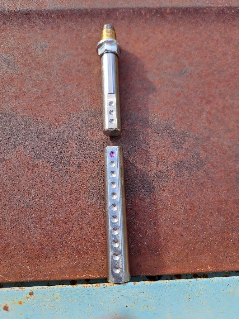

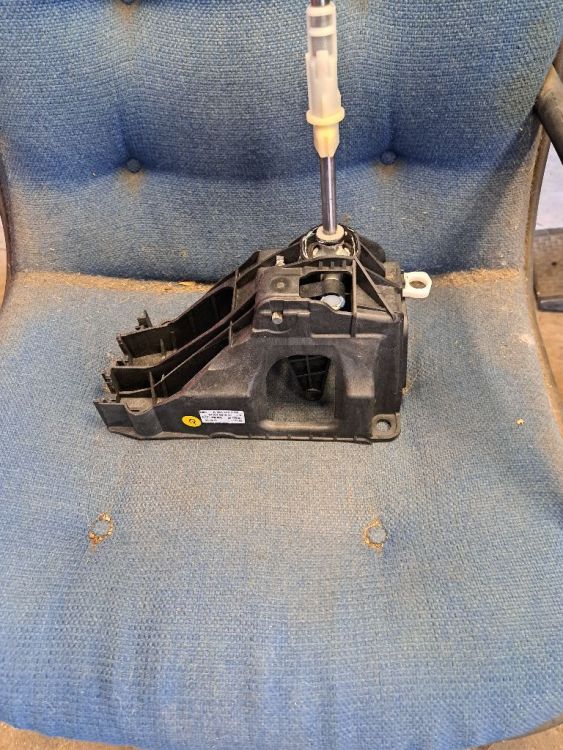

We got a spare shifter out of another 453 and tried to see if we can bend the shaft and tap it to 12x1.25. It looks like we can. Pics to follow...
We also got a spare rear view mirror out of the same wrecked 453 to see if we can extend the drop down to move the mirror down 1". It looks like we can. Pics to follow...
We also got a spare tachometer to see if we can install a small boost gauge on it. It looks like we cannot. 😋

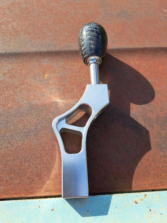

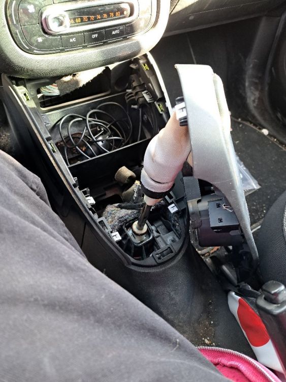

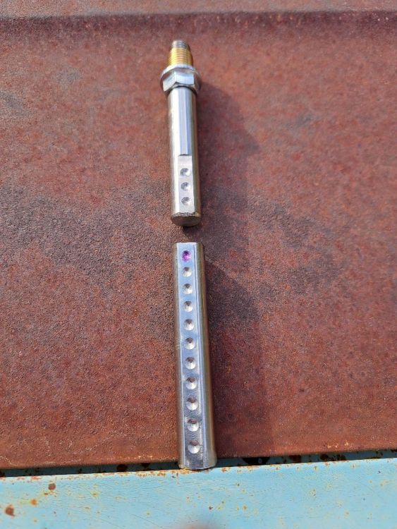

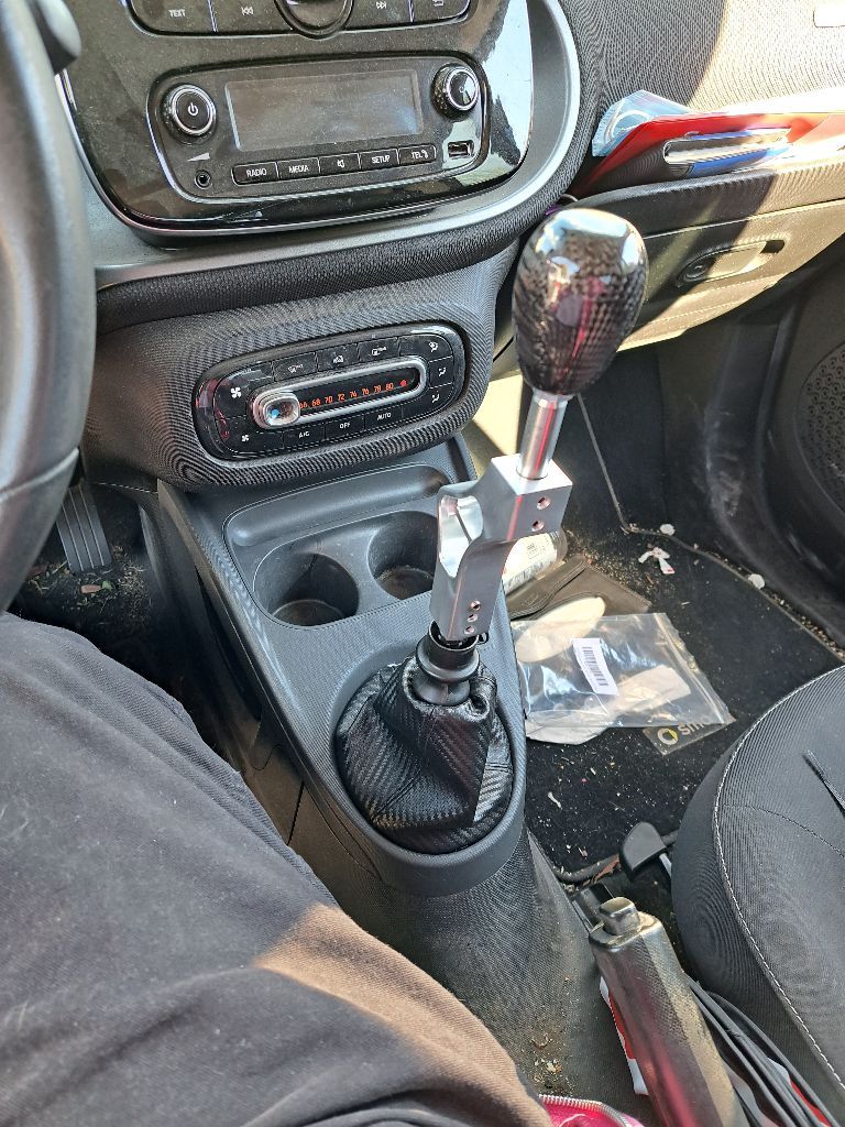

This was a thing that we did today.  First off, I removed the Mad Ti... OK, fine!  I removed the Rice Boy shifter Wednesday and put a  stock ball back on for the time being.  Oddly, the car felt quicker somehow.  Anyhoo, here's neutral stock...
And here's the mechanism in stock form...

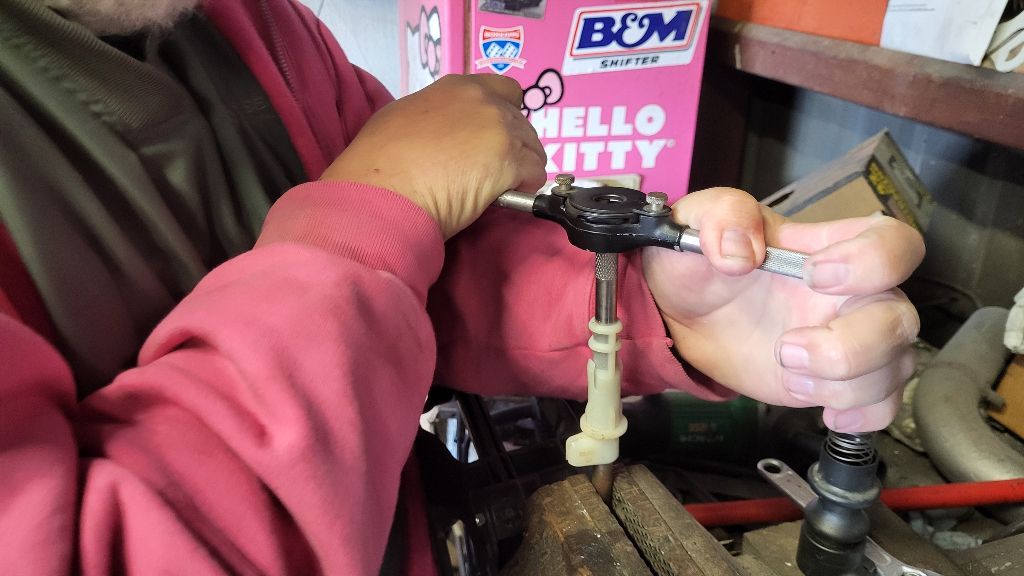

We put a bend in the rod...
and tapped it 12mmx1.25...
And after much weeping and wailing and gnashing of teeth, we got it all back together...
The new position is awesome!  I'm quite chuffed.  I am going to buy another "carbon fiber" gaiter because I want to make it... well, better than this half-assed job.  I learned a lot doing the Bride gaiter in the Chickenhawk.

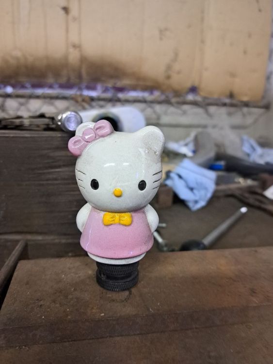

15 minutes ago, EDM620 said:
Whut? Hello Kitty shifter??? No manly men doing manly things with a Hello Kitty shifter...
LOL, I had a Hello Kitty shift knob on this car for a while.  It was too tall and ran into drinks in the cup holder so I took it off.  Maybe now with the bend...
Took a picture of the Hello Kitty shift knob...

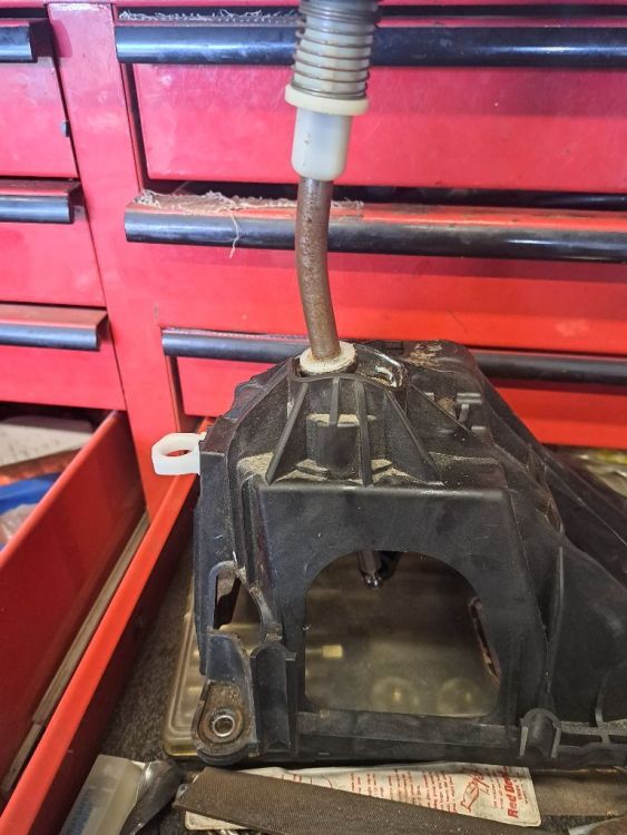

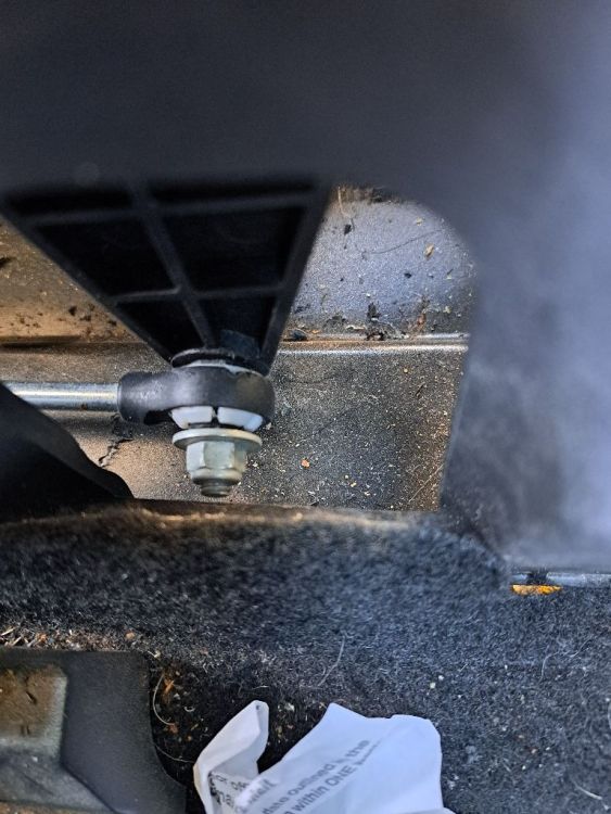

And speaking of shifters, the side-to-side gate cable came loose this morning.  Had to have it towed to the shop so I could disassemble it again and reinstall.
This time, instead of relying on the little white fingers to retain the cable, I added a nut and bolt.  It should stay together this time.

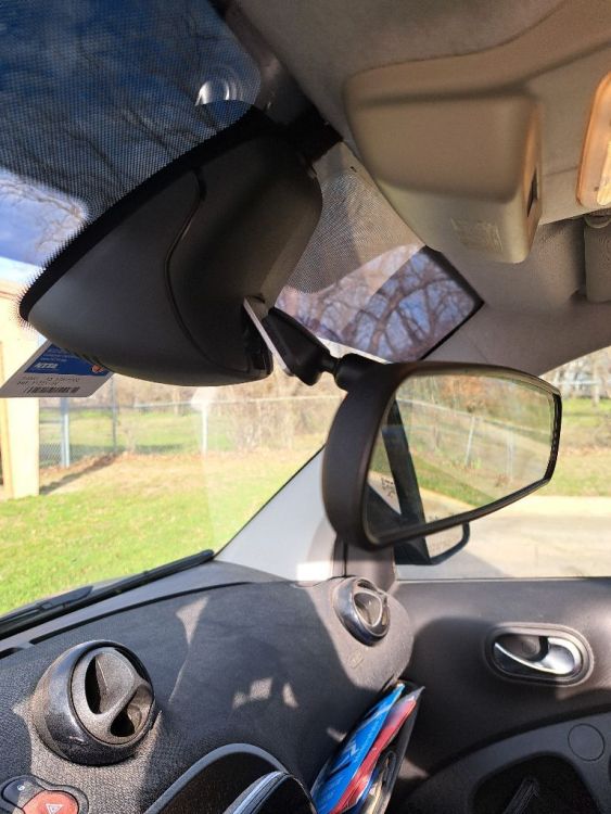

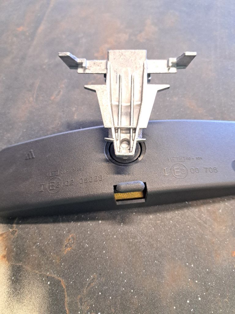

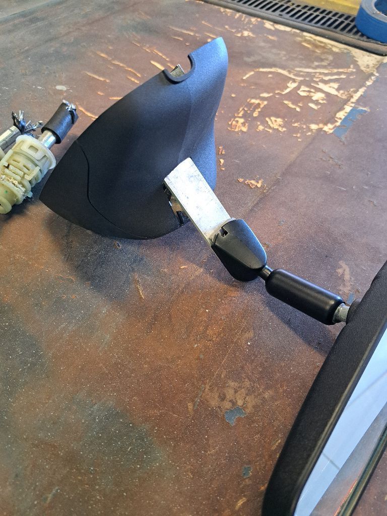

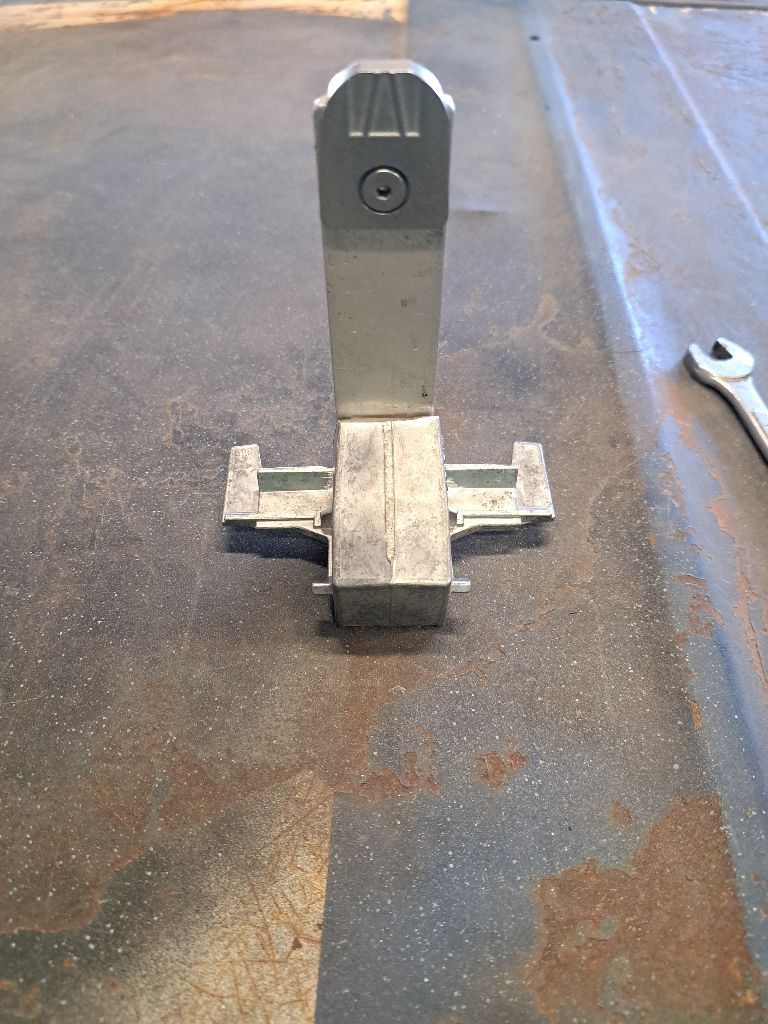

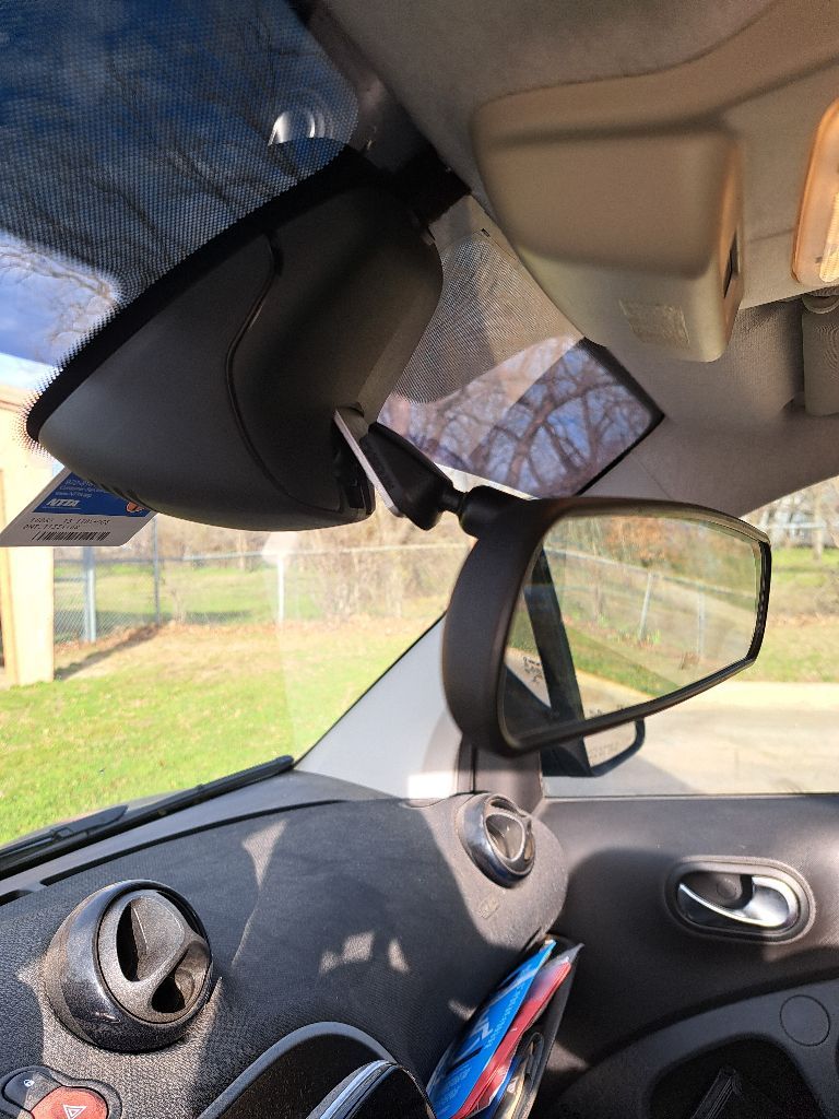

The inside mirror has always been too high.  I could only see a few feet behind the car.  Of course, I took no "before" pictures of it installed, but here's the mirror unit...
I took another mount, trimmed it a little, and added an extension...
so I could mount a Nissan goose-neck mirror...
Then I shortened the extension a little and popped it all in the car...
I can get it a lot lower than before, and therefore can see much further down the road behind me.
And before anyone asks... Yes, it does vibrate.  All headlights look like figure eights.  We'll add some damping to it later, somehow.
