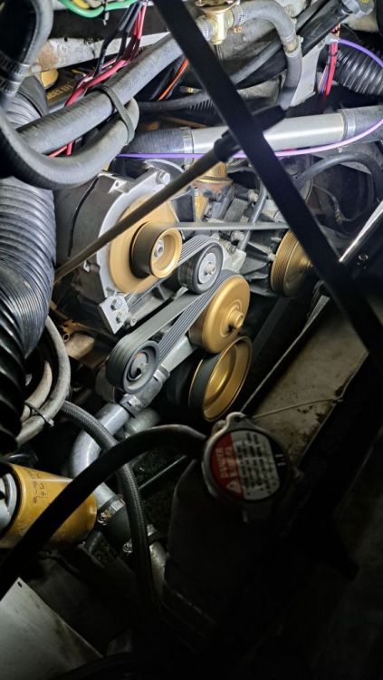

  11. Last week I relocated the oil filler pipe and secured it better in hopes that it would stop leaking oil onto the zorst. It did not. If anything, it made it worse. So I decided to ditch the pipe altogether... I saved it to use as a filler though... It was replaced with a standard fill cap... which is still easily accessible... Just don't burn your forearm on the upper radiator pipe!

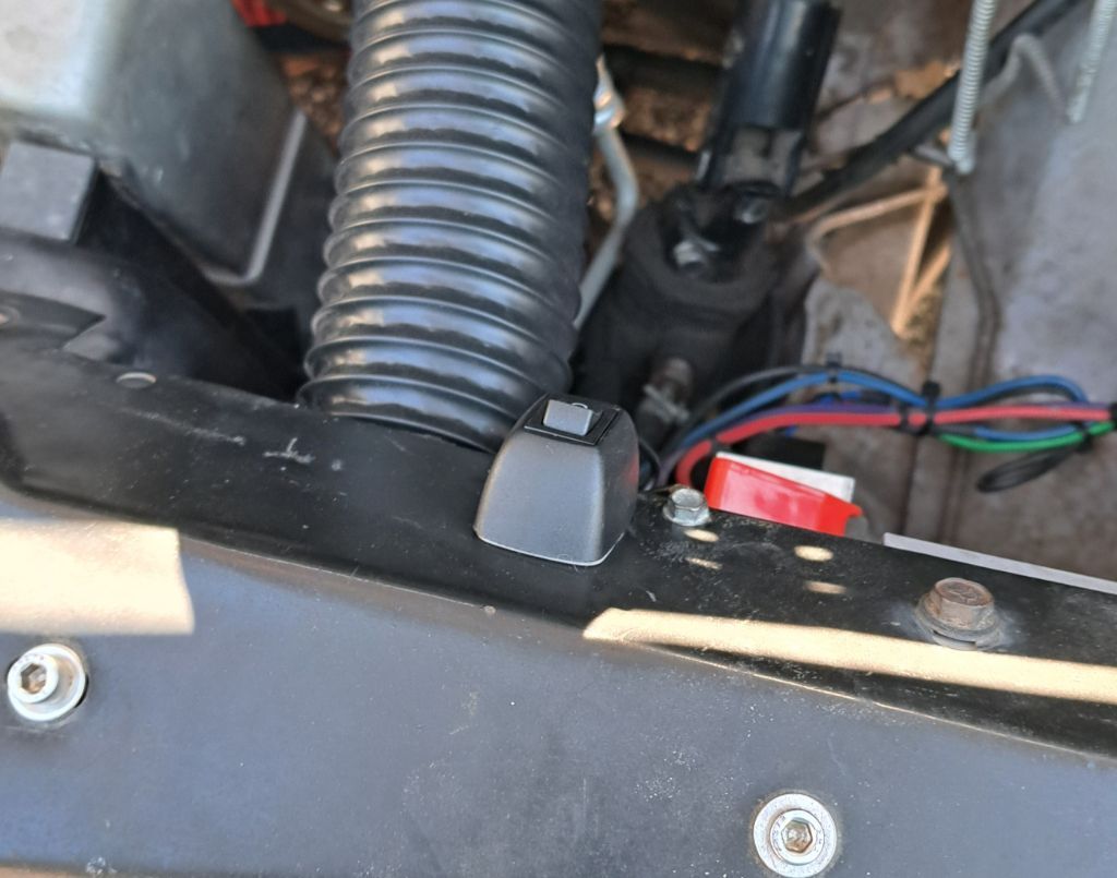

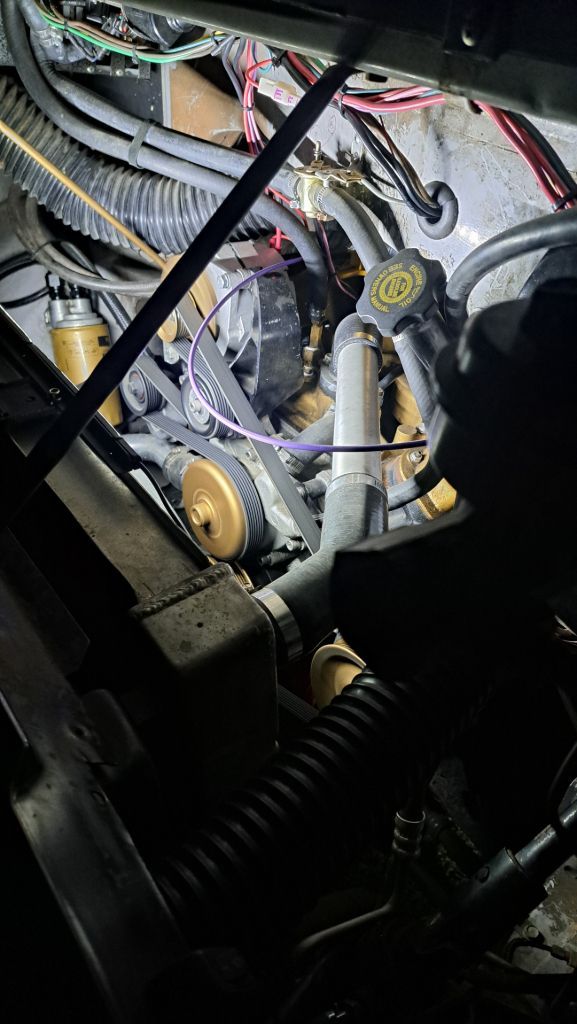

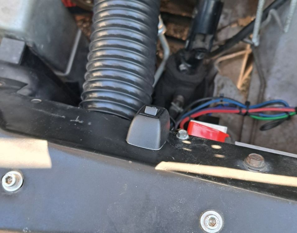

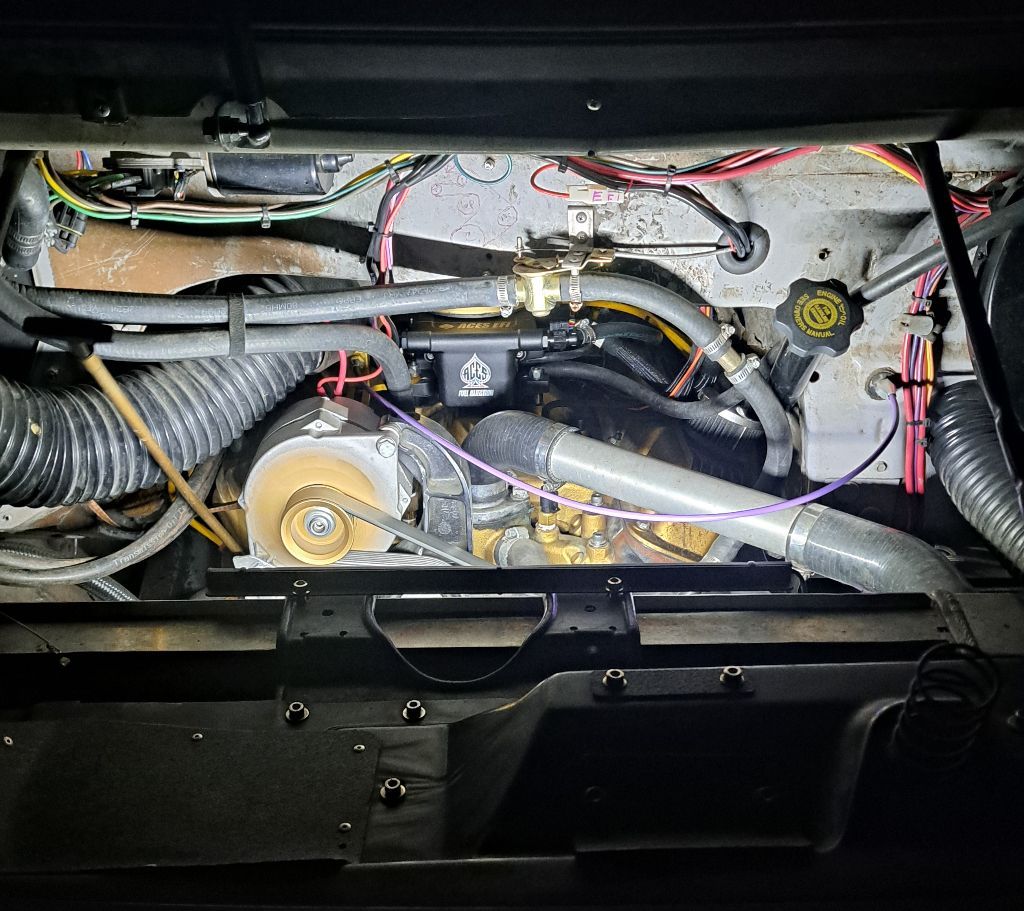

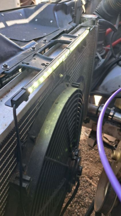

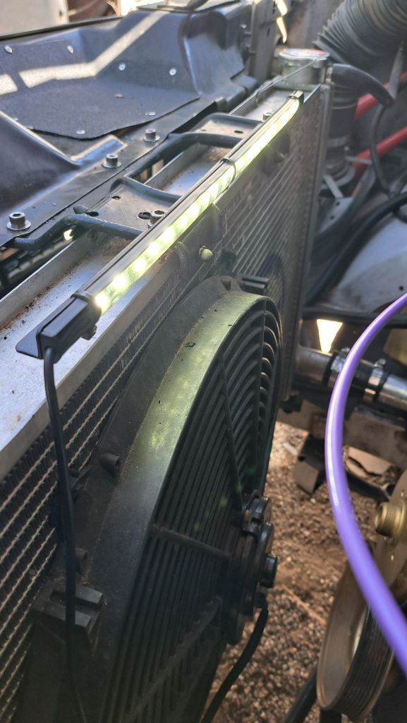

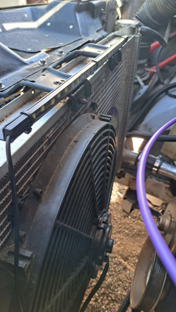

  23. The car meet the other night highlighted the need for some under hood lighting. So I bought a Chinesium LED light kit... with switch and fused harness... made a bracket and mounted it up... and lit up... But I had to wait until the sun set to really show it off... I am sure the kiddos at the next meet will appreci... Ok, you're right. They won't. I like it though.
