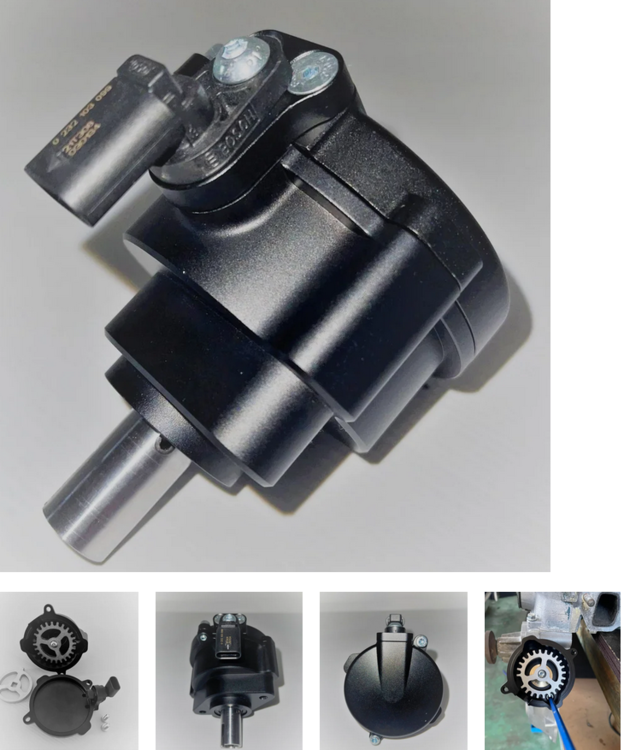

those who have gone efi are there any easy crank and cam sensor options for the l16?  I see a few ready made crank wheel options for the 6 cyl z but not certain they are the same front cover
Thanks, Im mostly wondering about the cam/crank.  Not really considering a Sniper system.
