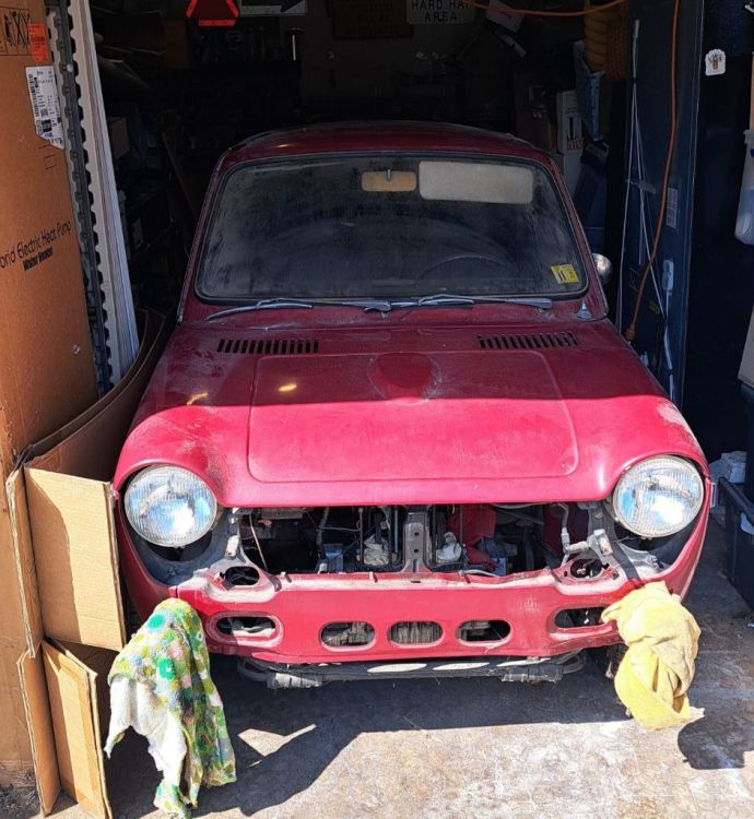

Here's how she sits at the moment

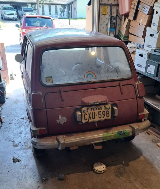

And how she was delivered
