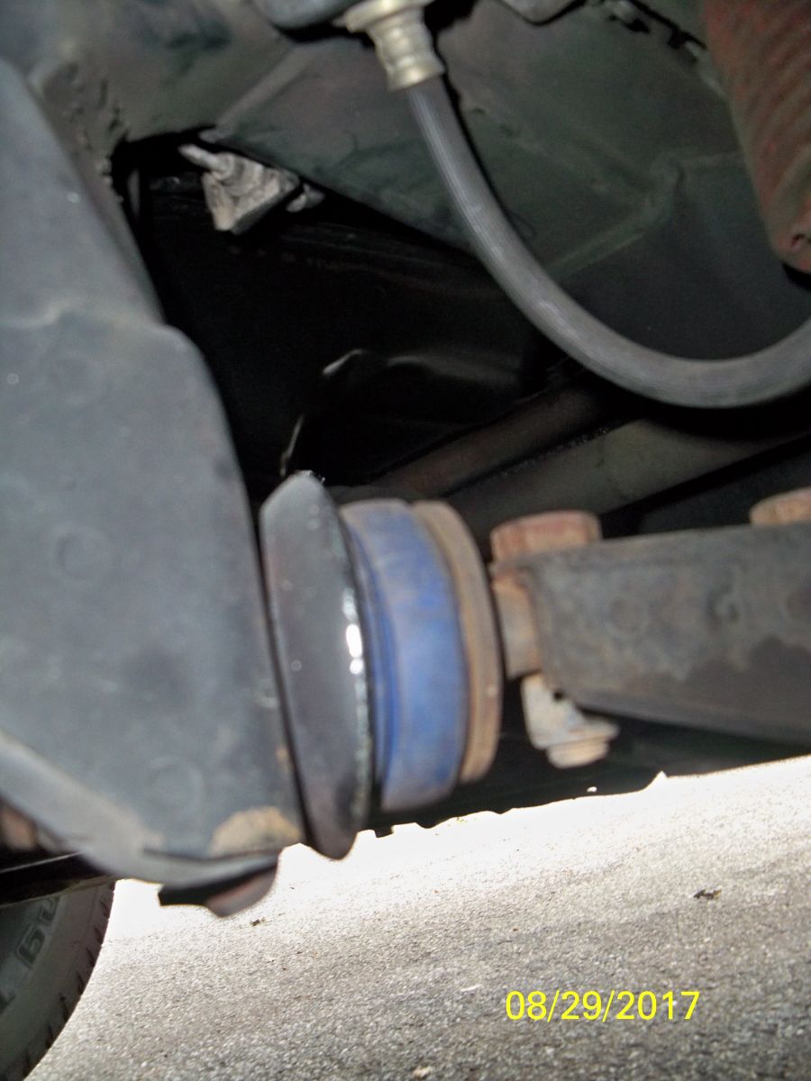

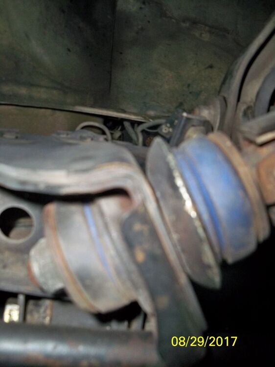

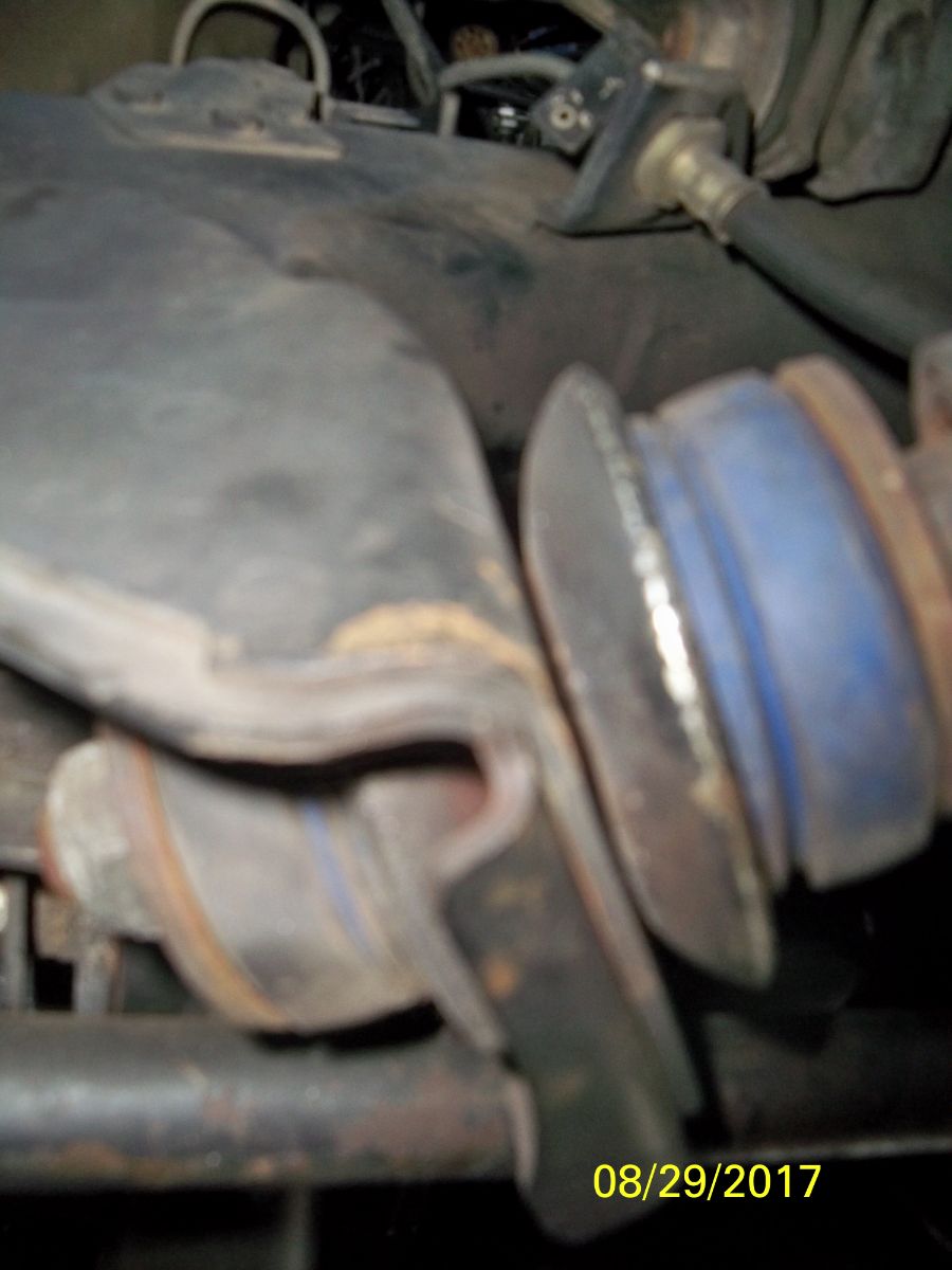

Don't use poly on that. It has to be compliant or flexible like real rubber. Poly does not compress enough so the tension rod bends around it and eventually metal fatigue can cause it to snap. The wheel now is not triangulated and the lower control arm swings to the rear when the brakes are applied. That's to be avoided.
http://i162.photobucket.com/albums/t261/Turbosidosis/Datsun/DatsunTCbroke1.jpg
You might try drilling the poly to allow it to compress but I hate the stuff and it has no place on the street. It's intended for off road and racing where it actually get regular inspections, maintenance and replacement before becoming a problem. Get rubber ones.

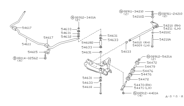

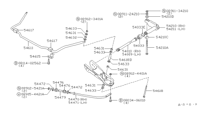

Check again carefully Matt. The top picture is '80-'82 and for the most part the same for 2 and 4wd suspensions and includes tension rods. The bottom picture is for '83 and on and again is more or less the same for 2 and 4wd and without tension rods.
