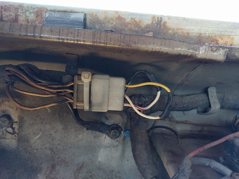

andyZ00m Posted November 10, 2023 Author Report Share Posted November 10, 2023 9 minutes ago, mainer311 said: Yes, it’s internally regulated. A true one-wire hookup. Fat wire from the charge post to starter post. One fat ground wire from the case to chassis. I would NOT use the stock alternator wires. Run larger gauge. I think I used 4AWG ultraflex, with a fusible link inline. Alternately, the stock voltage regulator can handle a larger amperage alternator no problem. Pick one or the other. Awesome! This seems like the way. This means I can cut out the regulator but will still need to run the star ground to the alternator ground (rest of the grounding scheme goes through the regulator harness). Theres also the WhiteRed and Whiteblue from the regulator harness that go to the combo meter and the combo lamp. Im assuming that 12 VDC and I would need to connect those somehow. Mike recommended if going with a regulated alternator you would connect yellow/WR but there is another lead in this truck. Quote Link to comment

datzenmike Posted November 11, 2023 Report Share Posted November 11, 2023 In the regulator plug all you need are the White, Yellow, White/Black and White/Red wires. Any left over wires remove from the plug. If you have a later car or truck with an electric choke there are a couple of more things to change. Quote Link to comment
