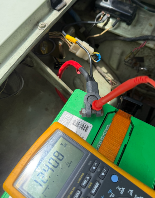

So I charged my battery and drove the truck back to the house. Did the tests from the service manual and everything is checking out correctly.
What I did notice is the belt to the fan/alternator was SUPER loose (like 2" play). According to the book its supposed to be .3-.5" depression @ 22lbs. My 22lb finger says its correct now. Maybe that's what happened last night, loose butthole belt meant my battery wasn't being charged and finally drained it down.
Tested for proper impedance on the alternator which is at 3.6Ohm, which is close to the 5 Ohm its supposed to be, and then tested the voltage output when running at 1100 RPM (aprox) and with the light on (says the book) and its showing the proper voltage of 12.something VDC.
So while I still think getting modern alternator with regulation is the move, it might not be an immediate problem.

A good fully charged battery is about 12.6 v not running. A charging alternator should be over 14v.
Next time running pull one of the battery cables off. (for no more than a couple of seconds) If engine quits it's not charging.

Alt must be putting out around 13.5v or more to charge a battery. Anything less only maintains current battery level which gets lower every start.

This is what’s happening. Fully charged battery was 12.6V and after driving around a bit and a couple starts it’s 12.1.
