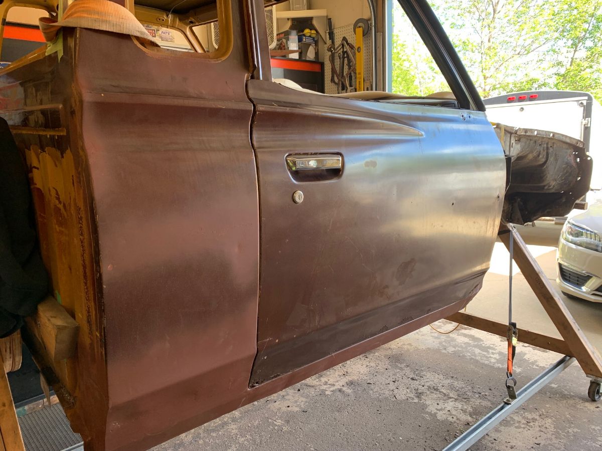

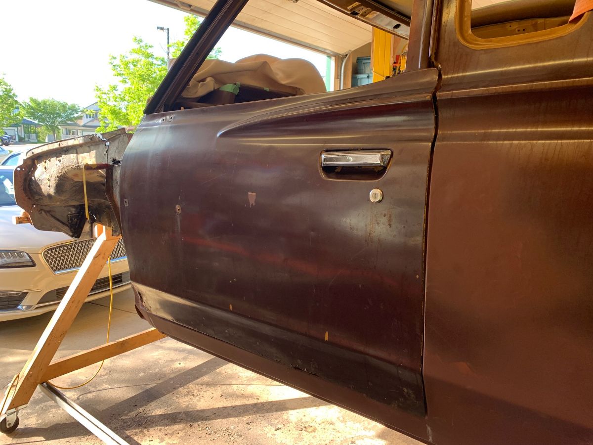

Did an initial fit up of the doors to make certain that my rockers and door openings were good before officially moving on, happy to say that careful work has resulted in a pretty acceptable fit and the body lines are good.
Now I can do the sheet metal repairs on the doors, noting the drivers door has the worse rust, along much of the bottom edge.

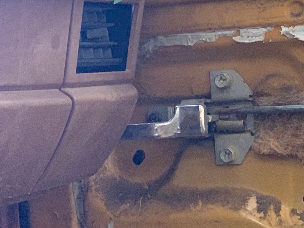

Murphy's law did raise it's head, as in no task can be totally simple. With the 720 dash in, I discovered a new issue
This explains why on the 720 the handle is located 2" further away from the front of the door. Not a big problem to resolve, just an added one to the list.
Mike, you had put a 720 dash in yours, what did you do?
New door cards were already planned as the originals were slightly tattered and the 720 panels are a slightly different profile. Like I said, not a problem just an addition to the "To Do" list that wasn't expected - one step forward and one step sideways. The pulls function to maybe 1/2 the required travel. One of those DUH moments for sure!
Going to look at options of doing different door handles/pulls since I have to mess with it anyway, maybe something swapped from something else or might get creative...
What would you consider for a different pull? Something from within the Nissan family or?
