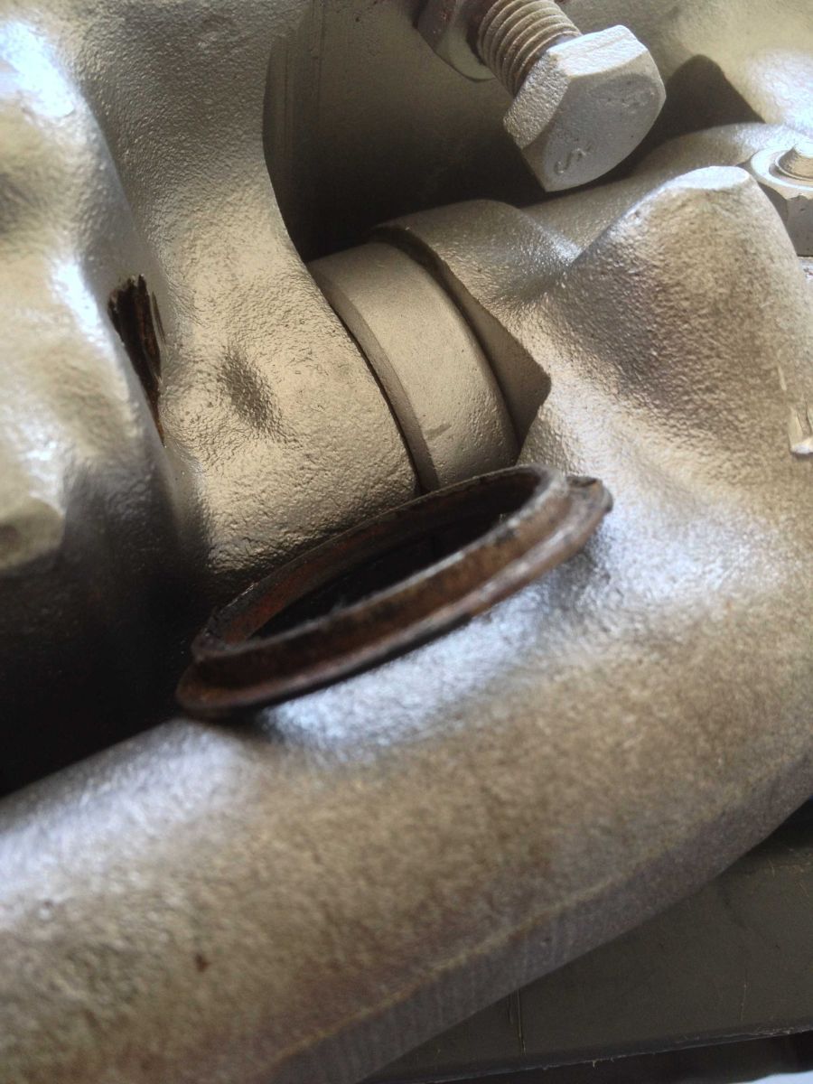

uberkevin Posted July 22, 2023 Author Report Share Posted July 22, 2023 The head gasket I replaced years back. Maybe 8 years ago. But yeah this is my clutch disc making its way out of my transmission.. Crazy part about it is I didn't hear a thing! Just al a sudden... pedal to the floor.. pulled it back up with my foot and pumped it a few times... nothing.. First I thought oh, slave must have went.. but it was still holding pressure so that wasn't it.. I took a closer looks as my wife pushed in the clutch pedal and as I take off the air filter housing (the slave is under the cover) there was this hole.. So I'll pull the trans. Hope the transmission is okay if so I'll just replace the clutch.. and weld the hole.. I was able to find a large piece of the trans.. lol. Fun times. Quote Link to comment

datzenmike Posted July 24, 2023 Report Share Posted July 24, 2023 Isn't that called a 'puck' clutch disc? Hows the flywheel look? Been broken for a long time. Were the rivets worn into it? Was driving a Fiat diesel one time and after a long down hill I stepped on the gas an the engine just revved up. The center broke out of the disc with no warning, no sound. Quote Link to comment

uberkevin Posted July 24, 2023 Author Report Share Posted July 24, 2023 2 hours ago, datzenmike said: Isn't that called a 'puck' clutch disc? Hows the flywheel look? Been broken for a long time. Were the rivets worn into it? Was driving a Fiat diesel one time and after a long down hill I stepped on the gas an the engine just revved up. The center broke out of the disc with no warning, no sound. Flywheel needs resurfaced but isn't to bad. Pressure plate is okay too. The puck just happened to find the only way out. This clutch definitely had a bite to it at the beginning but it was something you got used too. Quote Link to comment

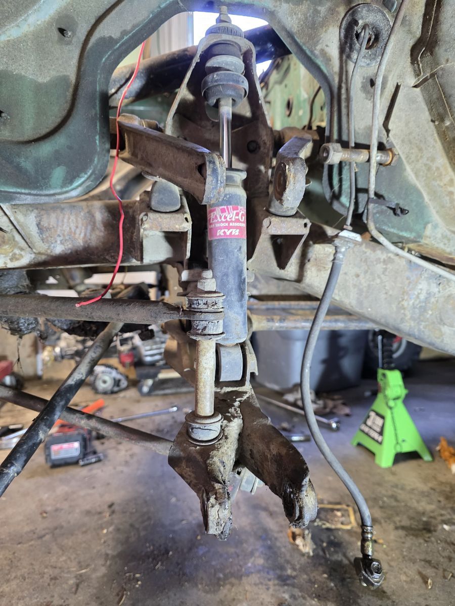

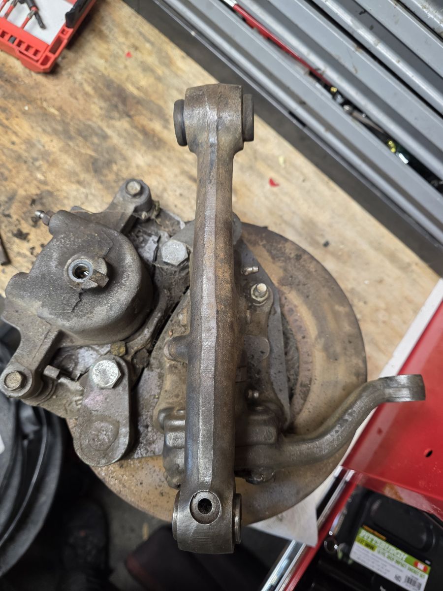

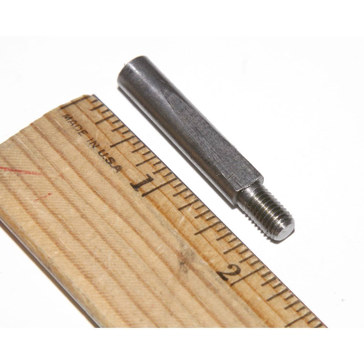

uberkevin Posted April 25, 2025 Author Report Share Posted April 25, 2025 (edited) Been a while. Now thats its warming up im driving the Datsun more and more. Let's call the 521 iv been driving O.G for now.. mostly stock other than the L20b and 5speed. My other 521, my first one. With a KADE in it has been sitting waiting for love forever... and well.. you know how that goes.. Well I had parked it 'my old one' in my garage to keep it out of the weather annnnd I started taking some of the few good part off it and swapping them over to O.G. and that got me thinking, I should take the disc brakes off and put them on the truck im driving kinda daily driving now. So here I am. and here is my original Mklotz disk brake steel brackets kit, that Jrock and a few other Oly guys helped put on for me year and years ago. just going to be cleaning up niceand get some small parts, https://mossmotors.com/661-890-pin-cotter-unf ive gotta thank Ratsun and the real OGs For helping find the lower dog bone seal N/A problem. Edited April 25, 2025 by uberkevin Quote Link to comment
