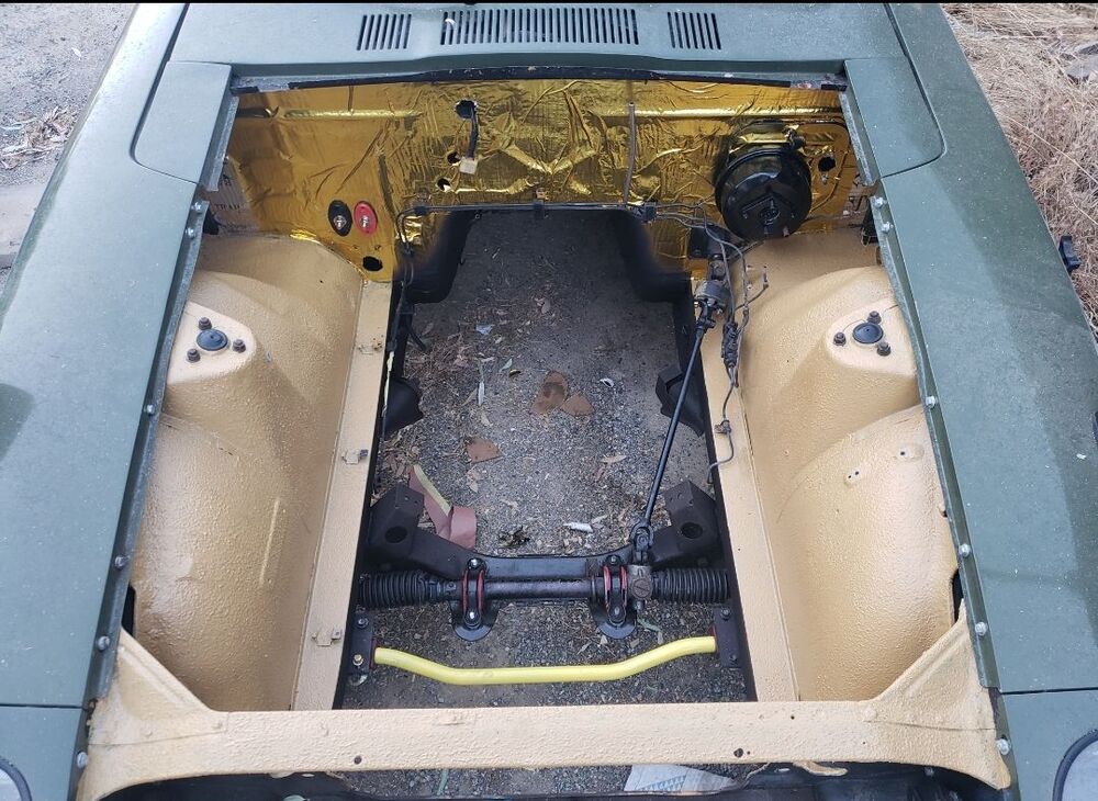

Skib Posted December 1, 2020 Author Report Share Posted December 1, 2020 Engine bay is starting to look halfway decent... 8 Quote Link to comment
Z23T Posted December 2, 2020 Report Share Posted December 2, 2020 Hey, that cleaned up really well, nice work. How in the hell does an entire brake booster end up rusty like that? Quote Link to comment
Skib Posted December 2, 2020 Author Report Share Posted December 2, 2020 No clue lol it's all just that surface dusting of rust, looks like it was painted silver at one time. 1 Quote Link to comment

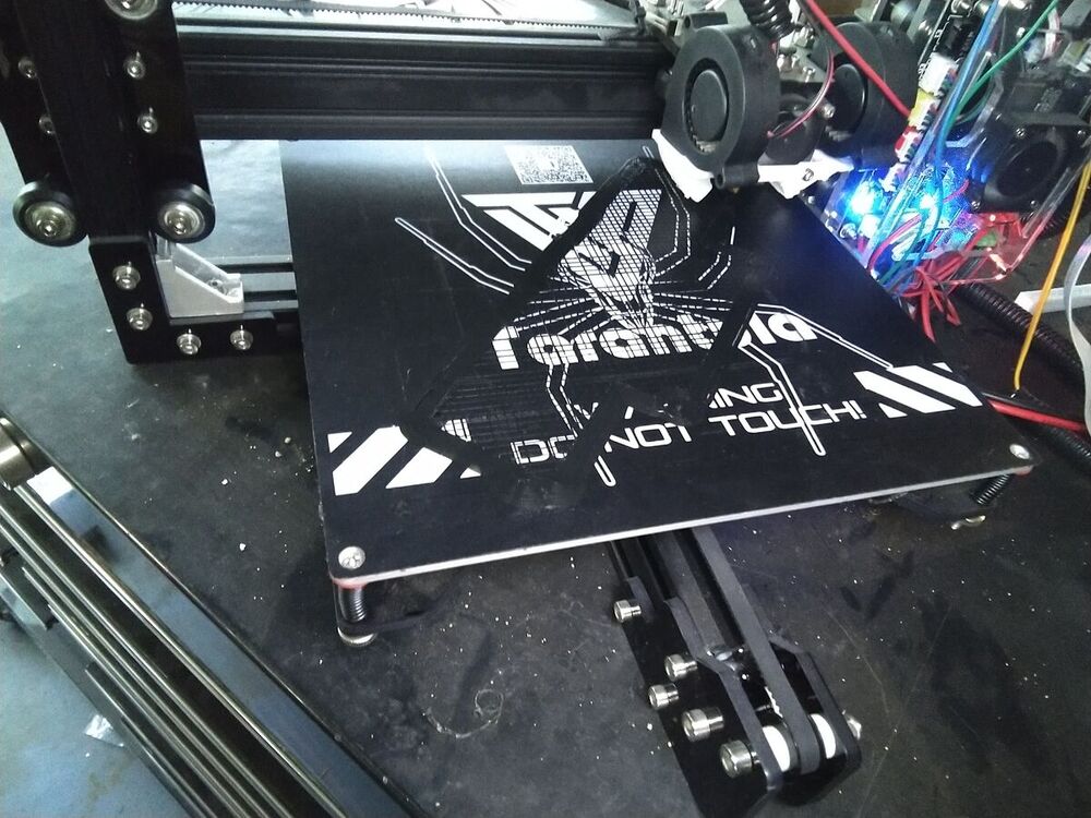

Skib Posted December 4, 2020 Author Report Share Posted December 4, 2020 Since I'm not using the stock heater anymore I don't need this area for the heater controls So I'll be 3D printing a little gauge pod insert I did up on Fusion360 Just need to get the printer out again and calibrated lol 1 Quote Link to comment

Skib Posted December 5, 2020 Author Report Share Posted December 5, 2020 Welp this thing will run for the next 7 hours or so lol and hopefully a decent gauge pod comes out of it 😂 6 Quote Link to comment
