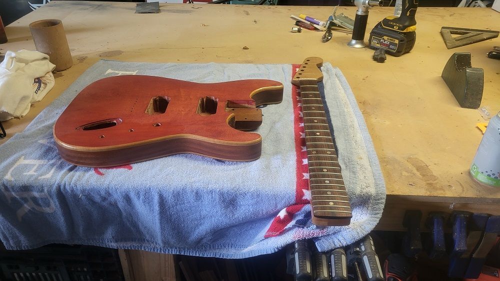

datsunfreak Posted January 20, 2020 Author Report Share Posted January 20, 2020 Nowhere near finished, but starting to look like an actual guitar now... The body is mahogany with a maple top. still trying to decide if I want to do actual binding on it, or a "faux" binding like this... 1 Quote Link to comment
Duncan Posted January 22, 2020 Report Share Posted January 22, 2020 I like the way binding looks, but top-bound guitars bug the shit out of me as it scrapes my arm. I have a natural Korina Robben Ford model that was made for me, and I have only played it once at a gig due to the binding. The natural binding looks good, and you can roll the edge ever-so-slightly so it doesn't irritate so much. Quote Link to comment
datsunfreak Posted January 23, 2020 Author Report Share Posted January 23, 2020 20 hours ago, Duncan said: I like the way binding looks, but top-bound guitars bug the shit out of me as it scrapes my arm. Same. 😃 They are good sit down guitars, and terrible stand up guitars. 20 hours ago, Duncan said: The natural binding looks good, and you can roll the edge ever-so-slightly so it doesn't irritate so much. I think what I am going to due is a step beyond that with similar results. I ordered 20, 30, and 45 degree chamfer bits for my router so I am going to stain the whole thing, then run the chamfer bit around the edge to expose the raw wood underneath, and hopefully increase the comfort level at the same time. I see a few acoustic builders doing this now for the same reasons you described. Except mine will go all the way around... 2 Quote Link to comment
datsunfreak Posted January 25, 2020 Author Report Share Posted January 25, 2020 One last mock-up before drilling holes that can't be undrilled... 😁 After drilling holes for the pots and pickup switch I attempted my first rear cavity route (that sounds dirty), and it went decent... 2 Quote Link to comment
datsunfreak Posted January 27, 2020 Author Report Share Posted January 27, 2020 I made a cover plate for the control cavity, then did the bevel route on the back side, then stained both cherry red, and put on a couple of coats of lacquer just to protect the stain from scratches. Should start on the front tomorrow. 2 Quote Link to comment
