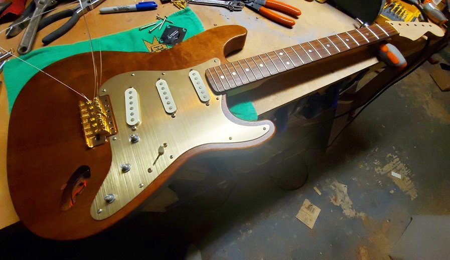

datsunfreak Posted April 3, 2020 Author Report Posted April 3, 2020 Made this body out of some leftover mahogany I had. Turned out pretty decent, so I decided to go ahead and build it. Still waiting on a gold input jack and gold tuners, though... 1 Quote

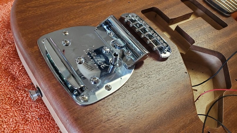

datsunfreak Posted May 13, 2020 Author Report Posted May 13, 2020 Got all my routing done last night. Decided the Filtertron pickups and a Jazzmaster tremolo would be the go... 1 Quote

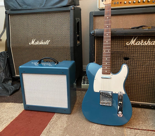

Guest Posted May 21, 2020 Report Posted May 21, 2020 Got my matching guitar and amp finished. The guitar is a '61 Custom Shop Tele. The amp is a Fender Pro Jr. A friend of mine built a hardwood case out of poplar so I could paint it. Both pieces together sound quite nice. Quote
KELMO Posted May 21, 2020 Report Posted May 21, 2020 Sofa King Cool. They look damn good together as well. 1 Quote

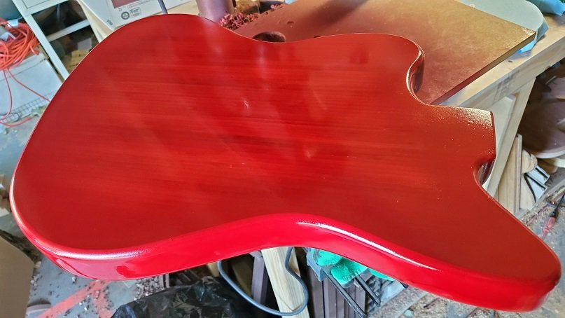

datsunfreak Posted June 1, 2020 Author Report Posted June 1, 2020 Got back on the bamboo jazzmaster this weekend... Masked off the face and back, then painted the edges red (weird lighting, it's really red not a funky pink/orange)... Then I painted the edges of the face/back in the same red in a bit of a "burst", then painted the whole thing transparent red... Then piled on a shitload of clear, and waited for that to fully cure/dry. I did the final wet sand and buff today... I am digging it... 👍 2 Quote
datsunfreak Posted June 2, 2020 Author Report Posted June 2, 2020 And those vertical stripes you see near the tremolo are just a reflection of my garage door. It is very shiny. 😁 Quote

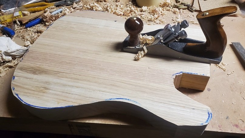

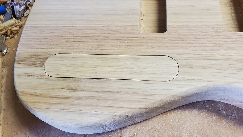

datsunfreak Posted September 18, 2020 Author Report Posted September 18, 2020 Good to go, and it sounds killer... So killer in fact, I immediately started on making a guitar for myself with the same pickups... 😄 My neighbor makes cool custom furniture, and was recently making a dining table from red oak. When I saw his pile of "scraps" I said, "hey, whatchu gonna do with all that?"... 😁 Bits cut into 1.5" wide strips and glued together... Top did not come out perfectly dead flat, so it was time to learn how to properly use a hand plane... 👍 Then a bit of quality time with the router... And I used some of the leftover bits to make a matching cavity cover... Thinking of staining it either dark brown or black, but not filling the grain, just putting a satin clear on it. Thoughts? 1 Quote
Lockleaf Posted September 22, 2020 Report Posted September 22, 2020 All the trim in my house is painted raw 1x4 or 1x6. I love how the natural texture stands out through the color. So i say do it. 1 Quote
