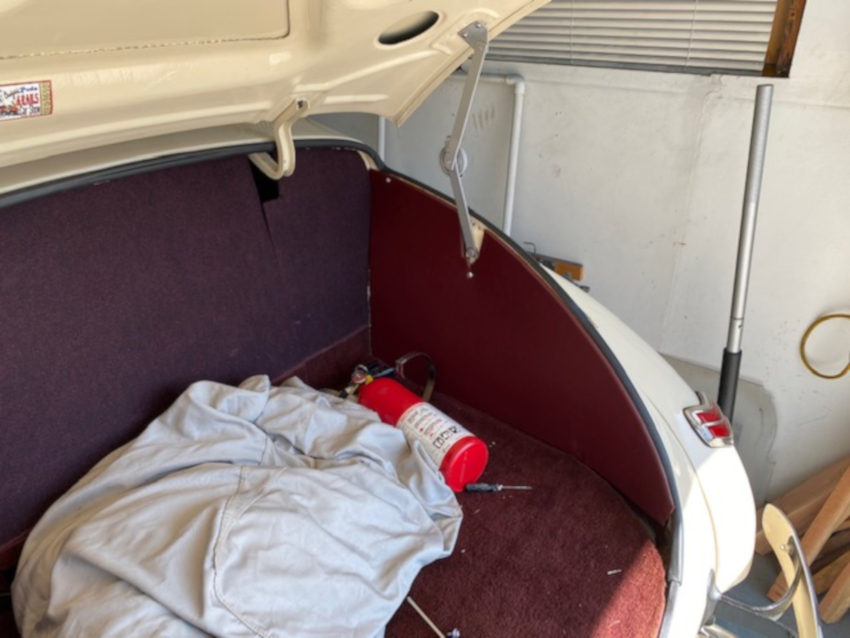

Duncan Posted August 28, 2021 Author Report Share Posted August 28, 2021 Well, it's been a long time since I've done this type of thing, so I started in the trunk 🙂 Like everything else, the trunk in the '40 has panels that don't match anything in the interior.. Here's the drivers side with a reddish maroon indoor/outdoor carpet with the bottom strip done with the carpet to match the carpet in the trunk.. This is the right side panel and it was mostly coming undone. The right side panel was stripped down, and it was not in the best of shape. My intention was to strip it down to bare wood, and use it to make a template for the replacement. It was not in good shape. On the Home Depot and Lowes websites, they only have 1/8" stuff in 4'x'8' sheets, and I can't fit that into my car, so I went ahead and recovered the old one. I glued up some 1/8" foam padding followed by the vinyl. Despite the damage, it came out okay. It took a bit before I got the knack (again) of trimming and gluing down the backside, but I think it came out fine, especially for a trunk 🙂 That color maroon never comes across right in the photos I've taken of it... And this showed up for the carpet... 1 Quote Link to comment

Duncan Posted September 6, 2021 Author Report Share Posted September 6, 2021 (edited) Finally got this install done. I took this pic while all the wiring was still loose in case I had problems and had to trouble shoot. It all worked as planned, so all the wiring was bundled up, heat shrink was applied on all the connectors, and it was all squared away neatly. I also got to install my trunk makeover. It was done last week, but obviously I couldn't throw it all back in until the fan install was done. It really is more of a dark maroon or burgundy color and it photographs terribly. My phone camera hates it. The over exposure shows the burgundy nap in the carpet, but it does not show in person. When I see these bad photos, I get picky and have to remind myself that it's a fucking trunk. Anyway, for $150 in materials and about 3-4 days of labor, it's a really big improvement... Edited September 6, 2021 by Duncan 2 Quote Link to comment
