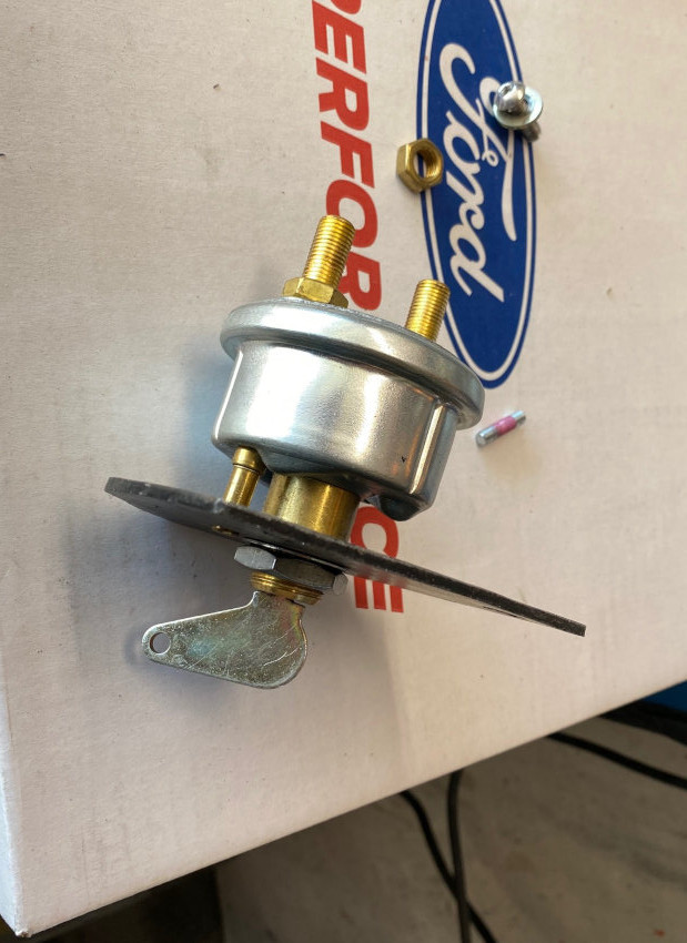

Duncan Posted October 28, 2021 Author Report Share Posted October 28, 2021 So I had this battery cutoff switch in my trunk. Looked bitchin, didn't work. Old switch. Had a key and was kinda wimpy. I put a real beefy switch into my wagon, and it was rated at 250 amp surge, and a total of 1250 or so constant. So I bought the same one for my Coupe. The old switch was mounted to a custom bracket on the floor, so I welded on a piece on the new bracket to make this one work with the existing bracket. (Why reinvent the wheel) It was nice to actually turn up my welder and burn a thick piece of metal. The last 6-7 years was spent doing 95% sheet metal tacking. I felt like a man again actually running a solid weld bead 🙂 3 Quote Link to comment
Duncan Posted October 28, 2021 Author Report Share Posted October 28, 2021 (edited) This is rather curious... This was attached to both terminals of the old cutoff switch. I was wrapping up the install of my new cutoff switch this morning, and noticed my trunk light didn't go out with the switch being turned off. I started looking at the wiring and discovered this inline fuse that was attached to both side of the switch. Someone in the past did this to bypass the switch. I don't understand having a switch and wanting to bypass it completely. I pulled out my battery charger and a test light and checked the old switch. Sure enough, the old switch worked fine. I moved the extra hookups over to the other side of the switch, so now everything turns off with the switch. Yet another thing I have never seen before.. Edited October 28, 2021 by Duncan 3 Quote Link to comment
datsunfreak Posted October 29, 2021 Report Share Posted October 29, 2021 23 hours ago, Duncan said: Someone in the past did this to bypass the switch. I don't understand having a switch and wanting to bypass it completely. If you have things in the car that need constant power for a memory (like a radio, etc), then you "need" this. The circuit breaker keeps you from accidentally using this wire to actually start the car because the amp load from the starter will just trigger the breaker. Quote Link to comment
Duncan Posted October 29, 2021 Author Report Share Posted October 29, 2021 (edited) 1 hour ago, datsunfreak said: If you have things in the car that need constant power for a memory (like a radio, etc), then you "need" this. The circuit breaker keeps you from accidentally using this wire to actually start the car because the amp load from the starter will just trigger the breaker. I thought about that, but by connecting it across the two posts on the switch itself, it renders the entire switch useless. The jumper didn't feed anything, it was just a terminal jump. If you needed constant power, you could always hook it to the battery side of the cutoff switch, or the battery itself. (With an inline fuse, also) As an an additional thought, I have never had to use one of these switches for any emergency. I've had a couple of these in other cars, and only used them when changing a starter, alternator, etc which requires disconnecting the battery, anyway. Which reminds me I still need to reset my radio stations and clock 🙂 Edited October 29, 2021 by Duncan Quote Link to comment

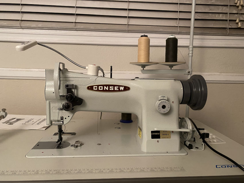

Duncan Posted December 13, 2021 Author Report Share Posted December 13, 2021 Been cramming my brain with learning about upholstery machines, and literally stole this one today. Bought it from a nice older couple. They bought it brand new a year ago, and the wife did some canvas and vinyl work on their boat. I was the first one to answer their ad and told them that I would gladly pay their asking price in cash if the machine was as they said. It was, and I did. I paid quite a bit less for this than I paid the upholsterer to do the carpet in my wagon. Anyway, I have a lot to learn, but I'm up for the challenge. Once I start doing some stuff, I'll probably start a sewing/upholstery thread. 4 1 Quote Link to comment

KELMO Posted February 10, 2022 Report Share Posted February 10, 2022 " literally stole this one today" And the brand name is "Consew". Bro, really, you couldn't have even made that up. All that aside, the carpet piece above looks pretty good from here. 1 Quote Link to comment
Duncan Posted February 10, 2022 Author Report Share Posted February 10, 2022 (edited) 3 hours ago, KELMO said: " literally stole this one today" And the brand name is "Consew". Good one, Kelly. It's stands for Consolidated Sewing from Japan. 🙂 Although I could have easily become a con at a few points in my life.... As far as the sewing, if I was doing the binding "for real" I would have used black thread on the top stitches. I'm using the white so I can see what the stitches look like and (hopefully) learn from my mistakes. I've started re-doing the trunk and haven't gotten too far yet. I'll stick up some photos once I get just a bit father down the road, warts and all... Edited February 10, 2022 by Duncan Quote Link to comment

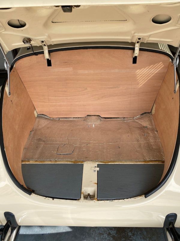

Duncan Posted February 14, 2022 Author Report Share Posted February 14, 2022 (edited) Trying the Ratsun upload for photos. Appears I lost yet another free photo hosting site. My existing photos are still there, but it appears they are holding them ransom until I pay a fee. I can't even download them, either.. Oh well. I'm re-doing my trunk. I didn't like the three boards along the back, so I'm changing it to a single piece. I'm somewhat wood-working challenged, so it was a lot of back-and-forth for me to get it right. I broke up the rear area into three templates, then I taped them together to make one wood template. I'm sure there's a better way to do this, but it worked out. I still have to trim a bit here and there, (then come up with some design for the upholstery) but I'm enjoying the process. If I was a badass, I could upholster the inside of the truck lid to match, but don't want to get carried away.. Edited February 14, 2022 by Duncan 1 Quote Link to comment

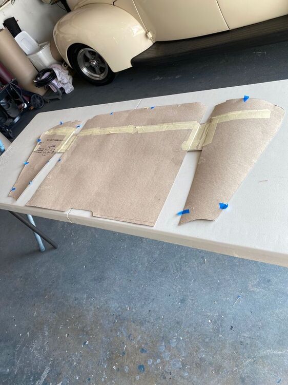

Duncan Posted March 6, 2022 Author Report Share Posted March 6, 2022 (edited) If you asked me if I would be doing my own upholstery a year ago, I would have thought you were crazy, but here's first upholstered panel of three for my '40 trunk. The new carpet and trunk mat have been done for a bit. That rear panel was the hardest piece I needed to do, so I did it first.. Depending on the cost, I decided to replace the two 1/8" plywood side panels with aluminum panels. The side pieces are under tension to hold their shape, and I think in cold or hot weather, they would probably tend to shrink and expand causing problems. I have some curved interior panels in the car that are .060 aluminum, and they do fine. I'm thinking spend a bit more now, prevent headaches later. The rear panel is 5.2mm plywood which is roughly 3/8" or so, and it's quite robust... Edited March 8, 2022 by Duncan 6 Quote Link to comment

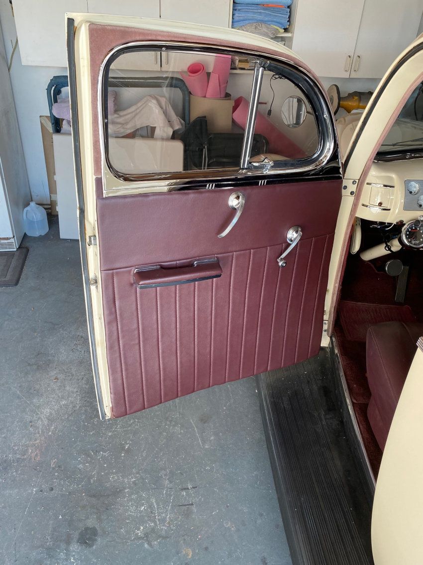

Duncan Posted March 21, 2022 Author Report Share Posted March 21, 2022 (edited) Thanks guys. Working on door panels next. Similar design. Pleats on the lower portion, plain material on the top. Based on what I learned from doing the trunk, I'm sure I can improve and make the door panels better. I hope so, anyway... Edited March 21, 2022 by Duncan 5 Quote Link to comment
Duncan Posted March 27, 2022 Author Report Share Posted March 27, 2022 I'm pleased how this turned out. 3 Quote Link to comment
mrbigtanker Posted March 28, 2022 Report Share Posted March 28, 2022 Wow those all came out beautiful Quote Link to comment
Duncan Posted March 28, 2022 Author Report Share Posted March 28, 2022 (edited) 13 hours ago, mrbigtanker said: Wow those all came out beautiful Thanks Ray. Just removing that red tweed material made it look better The color always looks washed out in the photos, but it's a dark Burgundy. Edited March 28, 2022 by Duncan 1 Quote Link to comment
