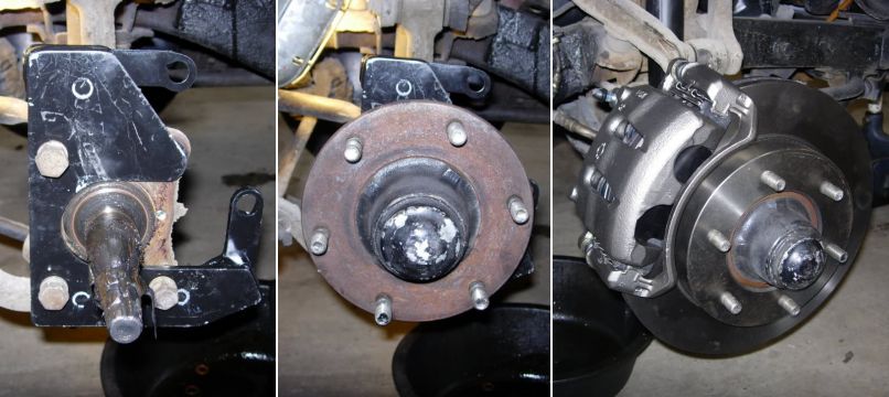

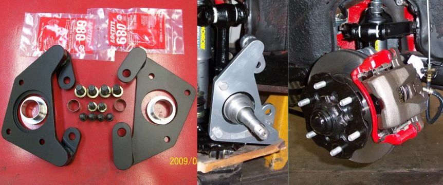

Bleach Posted March 31, 2010 Report Posted March 31, 2010 There are no bolt-on brakes from a newer Nissan truck to the older Datsun trucksYou must buy a custom made bracket or a-arm and then a caliper and rotor from a specific vehicle [Updated March 30, 2016]620 Truck Front BrakesBeebani's - Disc brakes for your Kingpin Truck http://community.ratsun.net/topic/25124-hardbody-disc-brake-brackets-for-620521520320Beebani has taken over productionHardbody disc brake brackets for 620/521/520/320 - Front Bracket = $160+ These brackets bolt to your existing hubs. You will receive the brackets in bare metal so you can paint or powder coat them any color you like. The rears will include the necessary spacers. All you will have to do is supply the brake parts.Must use 15" wheels or larger. If anyone with this conversion has found a set fo 14s that fit please post details521 owners: yes, these brackets will bolt right up to a 521 without any spacer provided....1. You want to use the z32 calipers.2. You are using the stock 521 inner bearings with the 521 spindleBack Brakes - Brackets for sale from Beebani $90The rears use the rotors and calipers from an 88-91 Isuzu Trooper, 89-93 Amigo, or 88-95 Pickup. Kragen online has the rotors for $15.99 a piece- - - - - - - - - - - - - - - - - - - - - - - - - - - - - - - - - - - - - - - - - - - - - - - - - - - - - - - - -Brackets that use Nissan calipersBeebani's - Front brackets to put disc brakes on your kingpinsBrackets = $160FrontRotors: 2002 Honda passport 2001-2004 Isuzu Rodeo 2002-2003 Rodeo sport Calipers: 1988-1997 D21 (Hardbody) calipers for 4wd, 2.4L Pads: 1988-1997 D21 (Hardbody) pads for 4wd, 2.4L Lines: Use the rubber hoses for the Hardbody calipers, and make new steel lines for the truck on the pre-1973 trucks only. The 620’s have the right thread on the hardlines and will hook right up. Hardware: 12mm bolts are required to mount the caliper to the brackets, and 10mm bolts are required to mount the bracket to the spindle assy.Master Cylinder: 7/8” or 15/16” bore 1979-83 280zx with vertical mounting tabs. The 620 master cylinder will also work, but the mount has to be modified to fit the firewall on the pre-1973 trucksDatDoug's thread on installing this kit- - - - - - - - - - - - - - - - - - - - - - - - - - - - - - - - - - - - - - - - - - - - - - - - - - - - - - - - -Option 2 for front brakes Bracket for 521/520/320 trucksMike Klotz's - Custom disc brake brackets = $200Thread for install, pictures, and ordering info Send a message to Mike to see if these are still in production if interested- - - - - - - - - - - - - - - - - - - - - - - - - - - - - - - - - - - - - - - - - - - - - - - - - - - - - - - - -Option 3 for front brakes Custom upper control arm to convert to ball jointsBeebani's - Front Disc & Ball Joint Swapcustom upper arm - all other parts are various Nissan factory piecesGlengeman's install writeup 4 Quote

BEEBANI Posted October 29, 2010 Report Posted October 29, 2010 Glenn's truck was set up for hardbody spindles/hubs/brakes. You can't just bolt 300zx brakes to that setup. I have 2 different brackets for the 2 different brake setups. 1 Quote

Radiant-Designer Posted October 17, 2011 Report Posted October 17, 2011 Just for anyone who is interested I bought a set of fronts from BEEBANI and they came in super fast. He has been AWESOME to deal with and been helping with my insane amount of questions... to add some info for anyone looking to do this: If you want to use the Nissan 300ZX calipers it should be a 26mm pair, the 1990 NA (not turbo) had the 26 mm. And use the rear brake lines from a 1997 D21 hardbody. (yeah use the rear lines for the front) I just ordered the rears! Quote

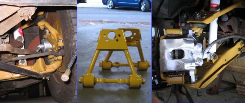

mklotz70 Posted August 9, 2012 Report Posted August 9, 2012 Are you asking me or just in general? There's a couple of options on ebay. Mine will work on the 620's, but the inner bearing adapter is modified a bit to work.....but I don't have any at present. Beebani's will work on the 620. Datsun-parts.llc? on ebay has an option. Krecs on here makes brackets. If you need/want to run stock rims, mine are the only option....pm me and I'll put you on the list for the next batch. 1 Quote

mklotz70 Posted March 22, 2013 Report Posted March 22, 2013 The 4x calipers have the same bolt spacing on the mounts, but I'm pretty sure they're 2 piston and much wider. At least with my kit, they won't fit because of the mounting bracket that holds the calipers is too big. I've looked into it and the 4x caliper on the small rotor is a really tight squeeze. If I ever redesign mine, I'll look into them again, but it will be awhile. Quote
