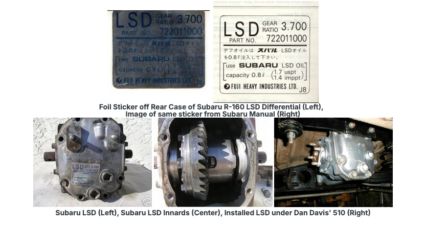

How can you tell if the rear is a VLSD?
Anyone have any pics of a VLSD with the cover plate removed to show what the internals look like?
I have a newer Subi R160 Rear that I think is a VLSD but I am not sure. I do know the ratio is 4.11:1
According to the info Kurt provided, it could be from an Impreza or a WRX.
I got it with a car I bought. I would like to know for sure. It has been sitting in my garage for a few years.

Im in the process of fixing all the editing, formatting, and possibly adding pictures to "spice up" the original article... but here is what was linked to originally. It wont be going anywhere like the previous pages
http://www.garagebluebird.com/articles/subaru-lsds-into-510s/

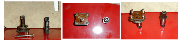

In '99 Subaru changed their VLSD design to no longer require the longer extra set of splines on one axle to engage it.
This means all you have to do is have some c-clip gooves machined into the end of your factory Datsun axle stubs and they will clip right into any '99 and up Subaru R160 VLSD and will engage the VLSD and work just fine! The machining cost only 60-100$
This makes the total cost for a 4.11 VLSD under 200$!!
Thats a real ratsun price for an LSD!
some pics of the machinging: http://www.the510realm.com/viewtopic.php?f=3&t=3881
