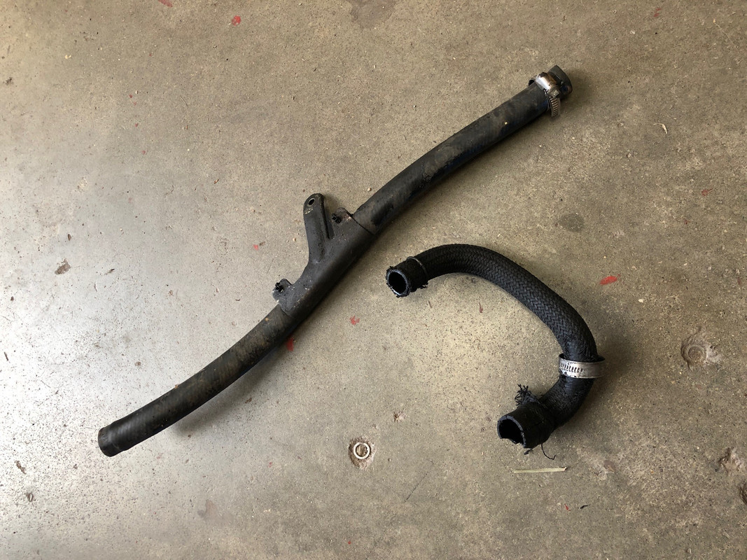

Labubre Posted August 8, 2022 Report Share Posted August 8, 2022 Hi, Any update one this one? Neel L16 PCV Hose or any validated altarnative Quote Link to comment
banzai510(hainz) Posted August 8, 2022 Report Share Posted August 8, 2022 is this for a SSS motor or a stock as they are different I believe Quote Link to comment
KELMO Posted August 9, 2022 Report Share Posted August 9, 2022 1969 Datsun 510 2 door - "ZPZ 046" - Page 5 - Project Datto - Ratsun Forums Take a look at this thread (page 5 I think). It looks like they used one from a "Z" and altered it. Quote Link to comment
Labubre Posted August 9, 2022 Report Share Posted August 9, 2022 23 hours ago, banzai510(hainz) said: is this for a SSS motor or a stock as they are different I believe Yes have a SSS engine Looking like attached Should be identified as 11828-22001 Quote Link to comment
