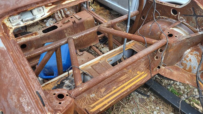

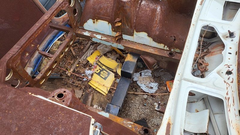

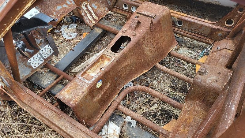

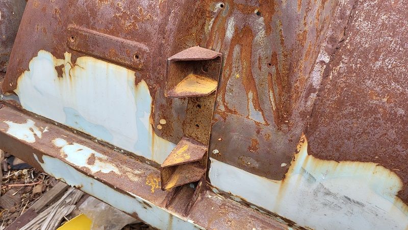

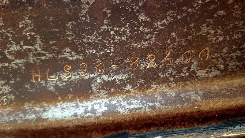

datsunfreak Posted January 30, 2023 Report Share Posted January 30, 2023 (edited) Been hankering for another S30 for awhile now. A friend had this abandoned race car project taking up space, so I went and looked at it yesterday. VIN looks to be a mid-year 1972 build, and the title says 1972... The previous owner elected to have the car media blasted, but then it got left outside. So I see lots of work ahead before I can even start on the build portion... 😄 It has an interesting cage in it. The floor was rusty so he cut it out and built the cage into the car, reenforcing all the bulkheads and frame rails... Removed spare tire well also... Cage ties into front frame rails on the bottom... Also made these weird engine mounts on the strut towers. Those will be first to go... Not sure if I want to get it blasted again, or if I just want to work all the surface rust off one panel at a time. Guess it depends on how much I can get it blasted (or dipped) for... I know it looks like it is missing a ton of parts, but they are all coming with the car. Thankfully, the doors were not disassembled or blasted, but the tailgate was. It's gonna be a little while before I can pick it up and get started, but I am stoked. There's no engine/trans, so I can kind do whatever I want there. Still undecided but thinking either 302 V8, or SR20DET. It'll be awhile before a decision needs to be made on engine though... 😁 Edited February 1, 2023 by datsunfreak 1 Quote Link to comment
Stoffregen Motorsports Posted January 30, 2023 Report Share Posted January 30, 2023 I would definitely have it blasted again, but maybe not before you do some fab. Grinding flings residue that sticks to blasted surfaces. I have them blasted twice. Once in the beginning to make the work easier and reveal rot, and then a second time after all repairs and fab are done. I've also been having the bodies powder coated with a zinc rich coating that is better than factory applied e-coat, though it may not reach all the spots that a dip can. 1 Quote Link to comment
Duncan Posted January 30, 2023 Report Share Posted January 30, 2023 (edited) Wow! I can't believe someone paid to have it all stripped and did nothing to protect the bare metal. Looks like quite a big project. I'll be following along. In your search for parts, if you happen to run across a manual pedal box, or the parts to convert the existing setup to a manual, please give me a shout. I have a clean donor and a parts S30 and I have been toying using 2 to make 1. Unfortunately, both are auto trans. 😞 Edited January 30, 2023 by Duncan 2 Quote Link to comment

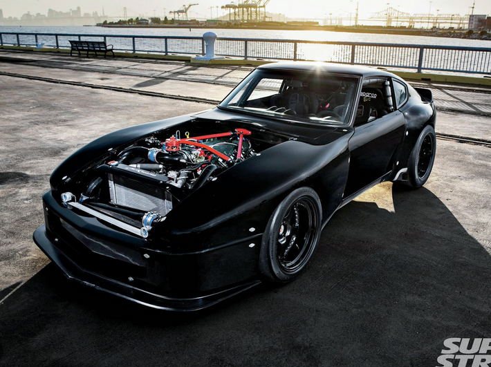

paradime Posted February 2, 2023 Report Share Posted February 2, 2023 Although a 302's torque would be better under 2.5K rpm and likely cheeper, I'm a fan of the SR20DET with top mount GTX2867R. Got one in my 510 making an easy 400hp on stock internals with some head work, and it pulls F'n hard up to 8K. Stupid fun in a 510, but in a Z chassis it would be obscene. Z Car Garage did one for Larry Chen, the guy from Hoonigan. I'm sure you've seen it, but DAMN I was drooling the whole time watch the VT vid. Larry ChenLarry Che Quote Link to comment
datsunfreak Posted February 2, 2023 Author Report Share Posted February 2, 2023 (edited) 12 hours ago, paradime said: Although a 302's torque would be better under 2.5K rpm and likely cheeper, I'm a fan of the SR20DET with top mount GTX2867R. Got one in my 510 making an easy 400hp on stock internals... I'm sure you've seen it, but DAMN I was drooling the whole time watch the VT vid.Larry henLarry Che Did see it, and I think an SR would be killer in the car. Problem is, have you priced an SR lately? 😄 There is no fucking way I'm spending $6000+ on a used 30 year old engine. That's just dumb. A few years ago when they were selling for $2500, sure. Not now. For fuck's sake, I could spend less money on an ecoboost Mustang engine that's 3-4 years old and make the same power, and have a better transmission. https://www.ebay.com/itm/314343768705?chn=ps&mkevt=1&mkcid=28&srsltid=Ad5pg_HJAF7E26wCCRKP7z_6csIC_qvRpNc_urZZF8soS5BLbHLL6_FfdUU https://www.ebay.com/itm/275621871834?epid=1066624487&hash=item402c5800da:g:D08AAOSwK~hjwgYk&amdata=enc%3AAQAHAAAAoNnKYJNS0s0GCWkNIHXrm9oIhnUJnqjO%2BH1Y5SddAm5Lu7ZwpLFPTQf47HrLaog7d5tFHYDFawNd%2FOugrYPibs%2Fa5YbaQAICKN81rtlcGbDstRAl%2BZ9skwGZxGfWO%2B9ZoxSiYaMc4BUmnkPw0X%2BQPo9zODkc0rHjs6EW52wEyo%2By5iyYK%2BDXm5TCnpJjiV%2F8ShMST2CUD%2BKosAmIvwjGJ2o%3D|tkp%3ABk9SR6bF5KHCYQ Unfortunately they were priced a lot more sensibly back when you bought yours. Heck, the red top I put in my S13 ten years ago was $2000 shipped to my door. I think (at this point) for the sake of budget, ease of install, torque, etc I am going to buy the turbo KA24DE from my buddy. It ran great in his car and comes with just about everything I need to get it up and going (minus fuel pump). 👍 It's 1/4 the price of an SR and is ready to run, not a guarantee you'd get these days with the used SR. Edited February 2, 2023 by datsunfreak Quote Link to comment
