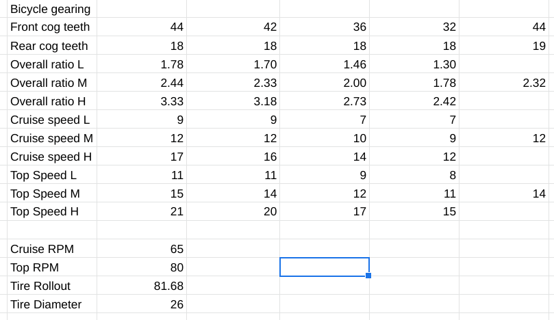

Ok, so I did a little spread sheeting to finger out what gears I think I want.
Stock gearing was the far right column: 44 tooth front, 19 tooth rear, giving a 1:2.32 ratio at the wheel.
What I have now is the far left column: 44t front, 18t rear, yielding 1:1.78 low, 1:2.44 mid, and 1:3.33 hi ratios at the wheel.
I believe these numbers to be accurate based on how the thing rode.  Low was easier than before, mid was a little harder than before, and hi was nigh impossible to use at parking lot speed.
So, looking at the sprockets I have ordered (yes, I know I should have done this spreadsheet before buying gears), I think I am going to go with the 36 tooth front cog until I get into a little better shape.  Once I'm able to pull third with that gear, I'll swap over to the 42 tooth, and maybe eventually back to the 44.
Ok, having ridden it a few more times, I think I'm ready for a gear change.  I realized I'm not even fit enough to pull the 36 tooth front cog just yet (and the stroker cranks make it worse), so I'm going to install the 32 tooth gear.  I'm going to hate that it is silver, but it's what it's.

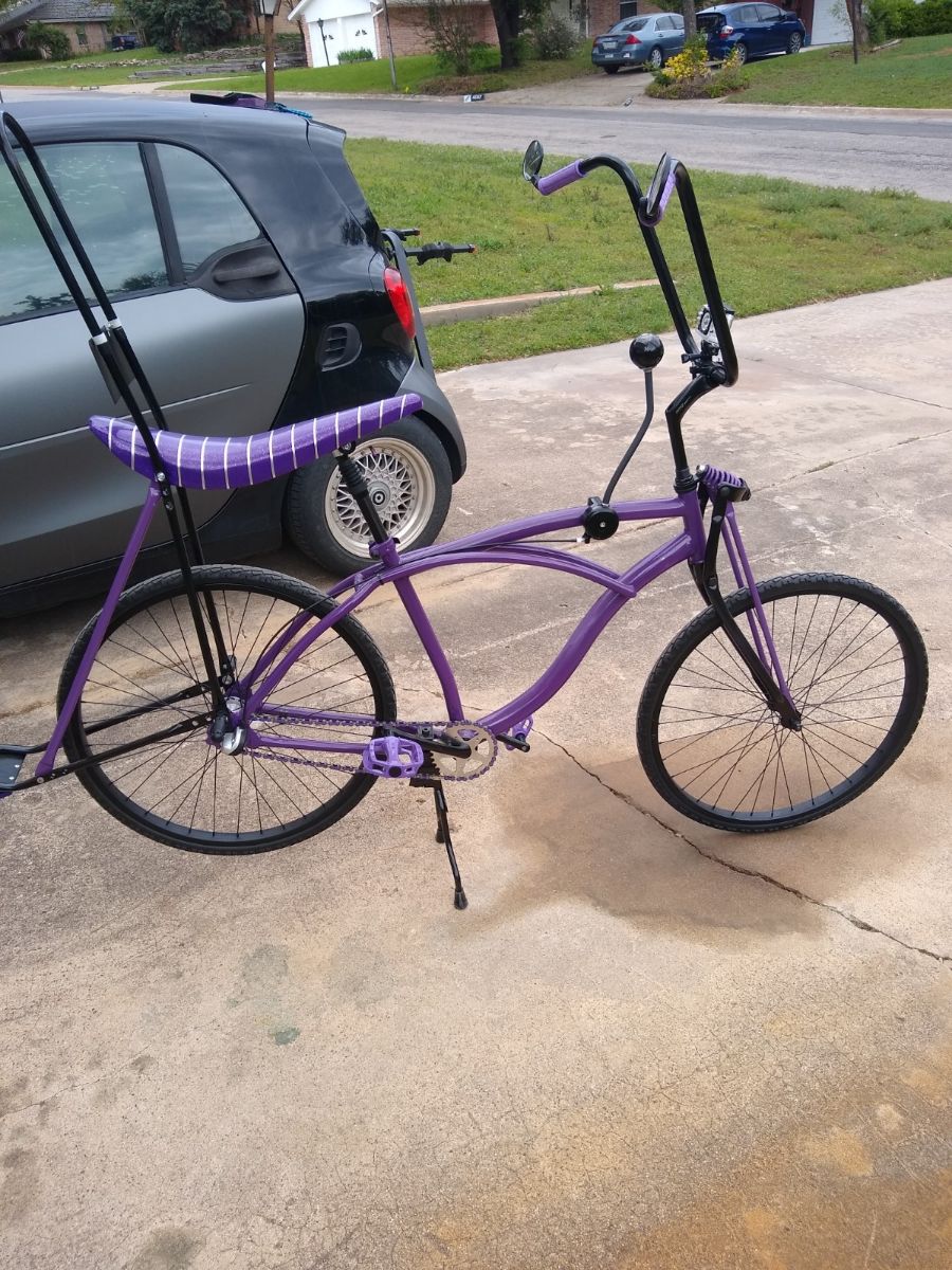

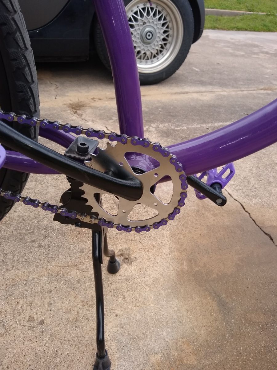

Popped on the 32 tooth sprocket today.
I knew I would hate that it is silver, but since John won't let me near the spray paint, I'm just going to have to live with it.
I guess it's not too bad from a distance though.
And from the other side...
... you can't even tell.

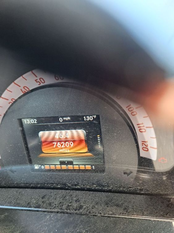

Is it really 130 degrees, or is that in a closed car or building that's been in the sun?  I think Death Valley is the hottest place on earth, and I don't it's ever hit 130 there..
I believe the OAT sensor is under some black bodywork.  It always reads about 10-20 (or probably more sometimes) degrees higher than the actual air temp until I get rolling.

My Yota sitting in the Sun always read about 10 degrees hotter than actual, but after it gets moving for a few minutes starts reading correctly. More accurate than any storefront temp display

On our 2006 Subaru and 2010 Yota, the exterior temp sensor is behind the bumper, and not used by the engine ECU
I wouldn't be surprised if GM re-uses the engine air inlet temp sensor for same purpose, and in that case I wonder how accurate it would be for external air temperature
1 hour ago, datzenmike said:
Car temperature readings are from the throttle body sensor so the EFI can compute the mixture. Under hood temps, specially heat soak will read higher just for a while on start up.

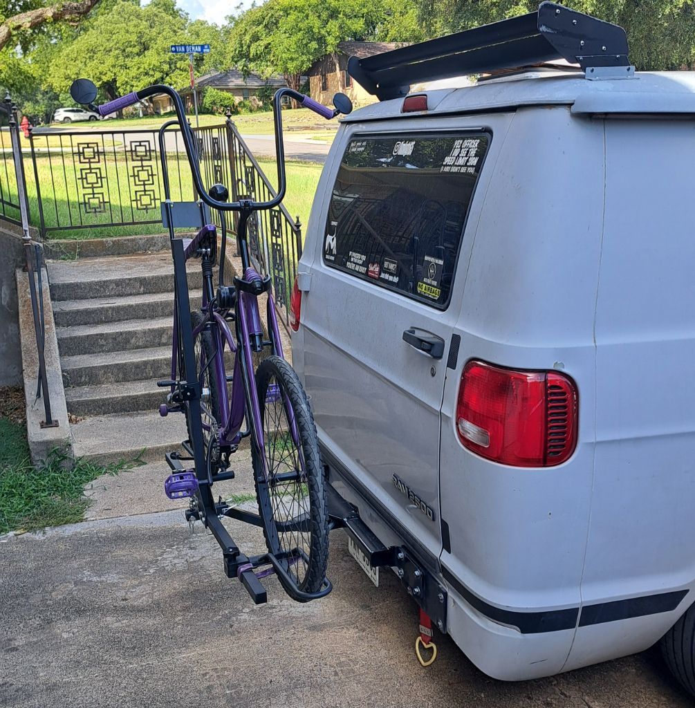

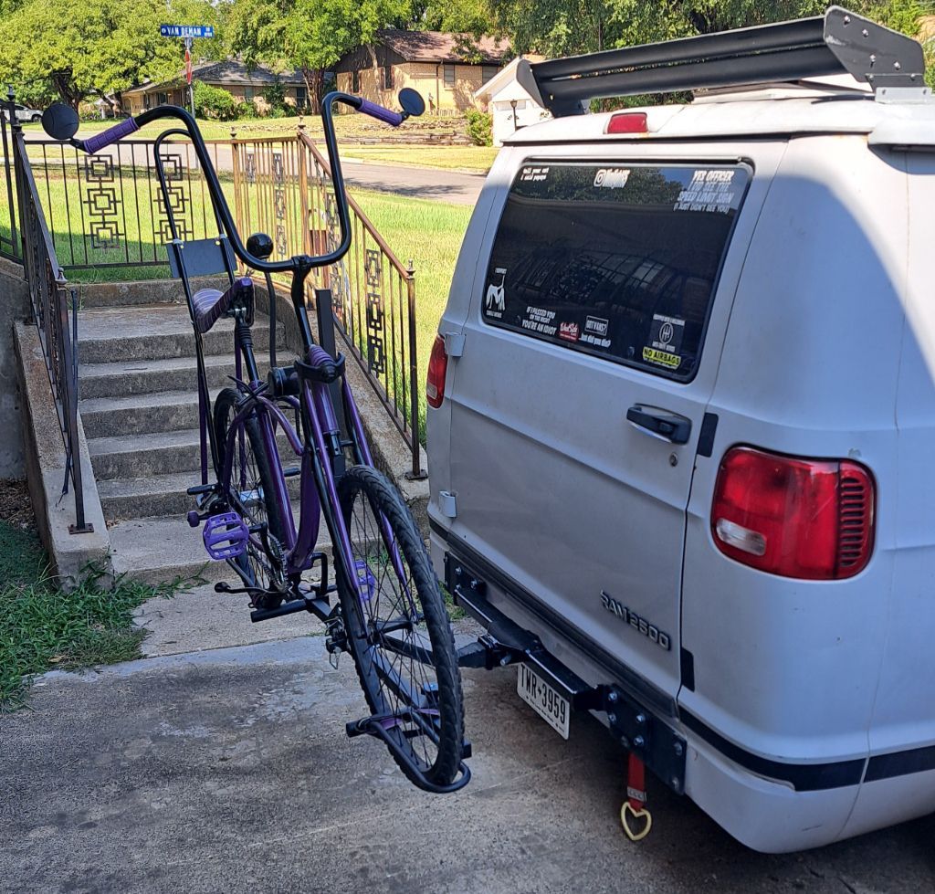

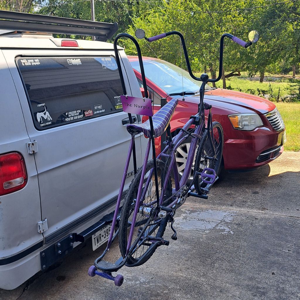

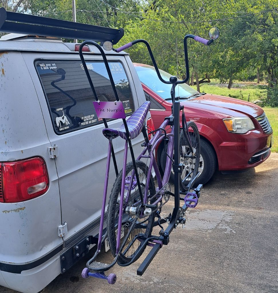

I took the bike around the block today!  Oh, I didn't ride it, it rode on the back of the Dajiban!
See, today I drove the Dajiban home and fitted the bike to the rack.  First attempt, on the "Outside"...
which was a lot easier to load and unload, but was sketchy as hell!

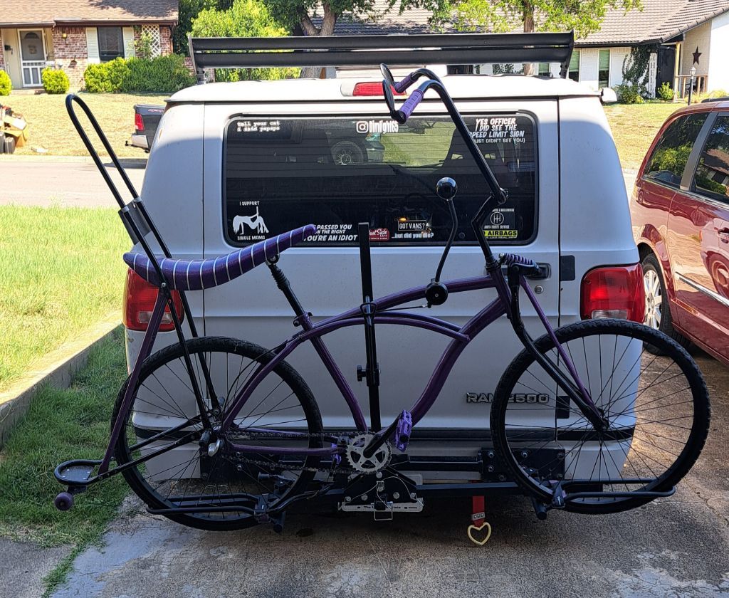

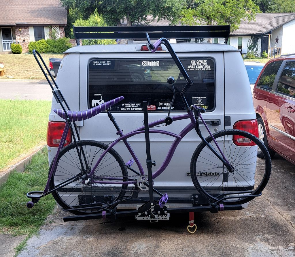

So I reconfigured it to ride on the "Inside"...
which I like much better, even if it is a bit fiddly to load and unload.   We're ready for car shows now!
And before you comment, it does not stick out on the sides.  Yes, it looks like it does, but it does not.

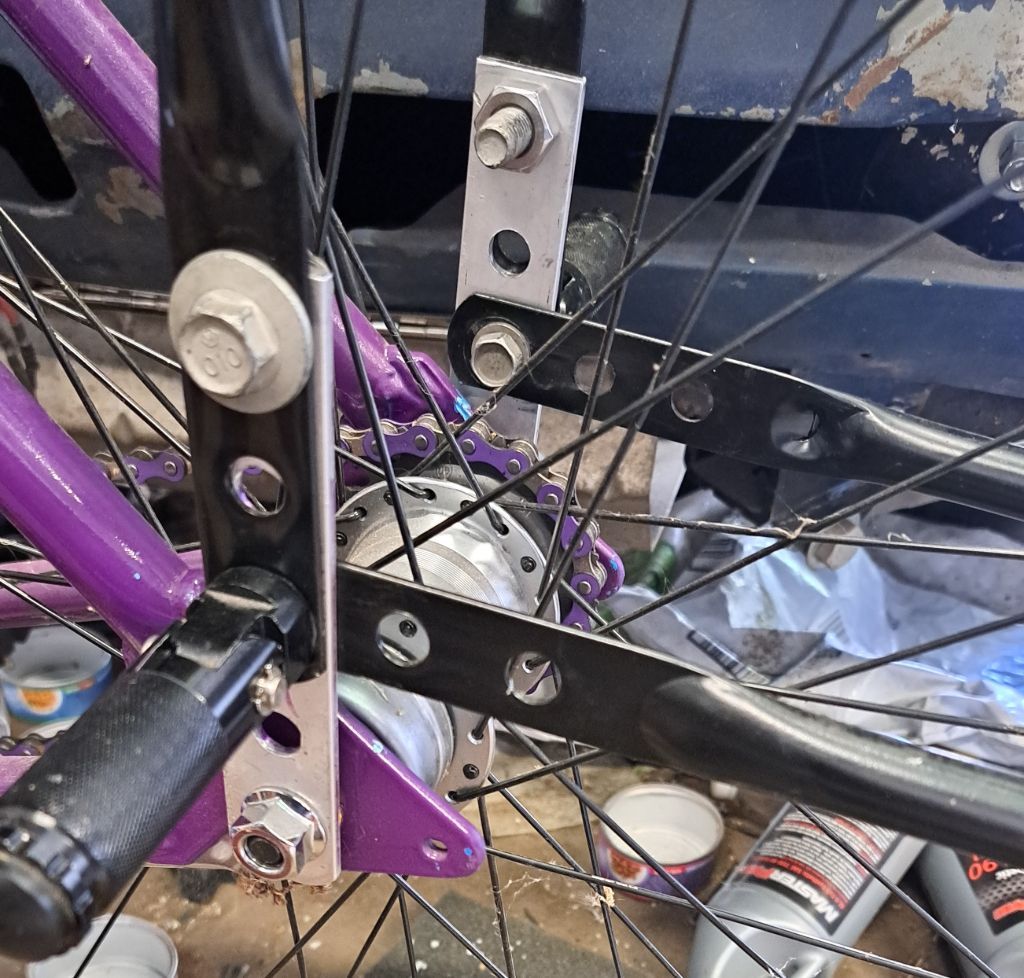

I took the bike back to the shop so I could make a modification to the rack... but then forgot to take pictures of that modification.  Next time.

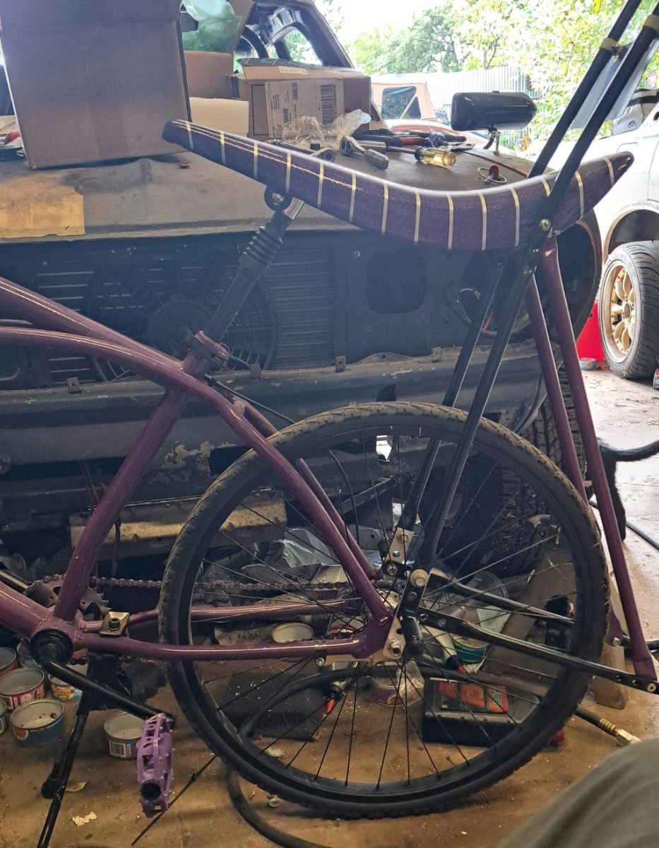

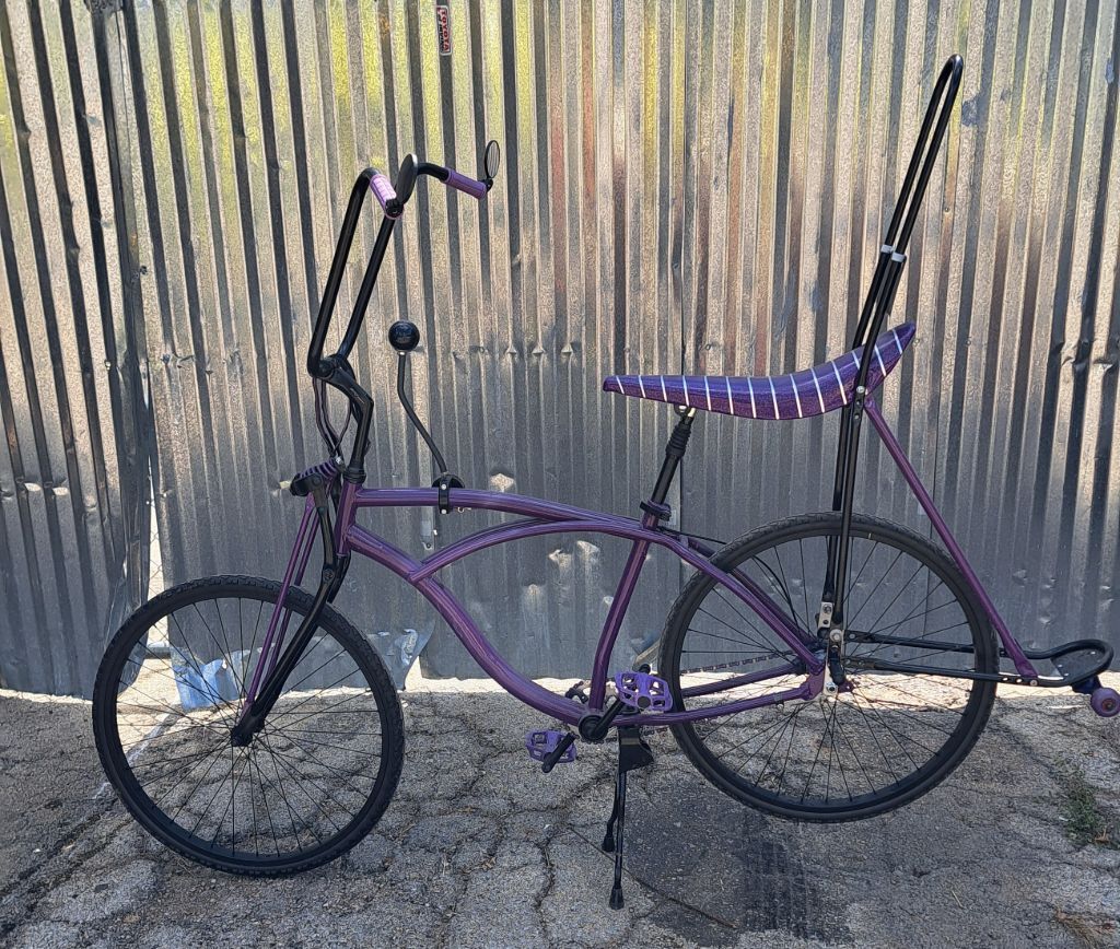

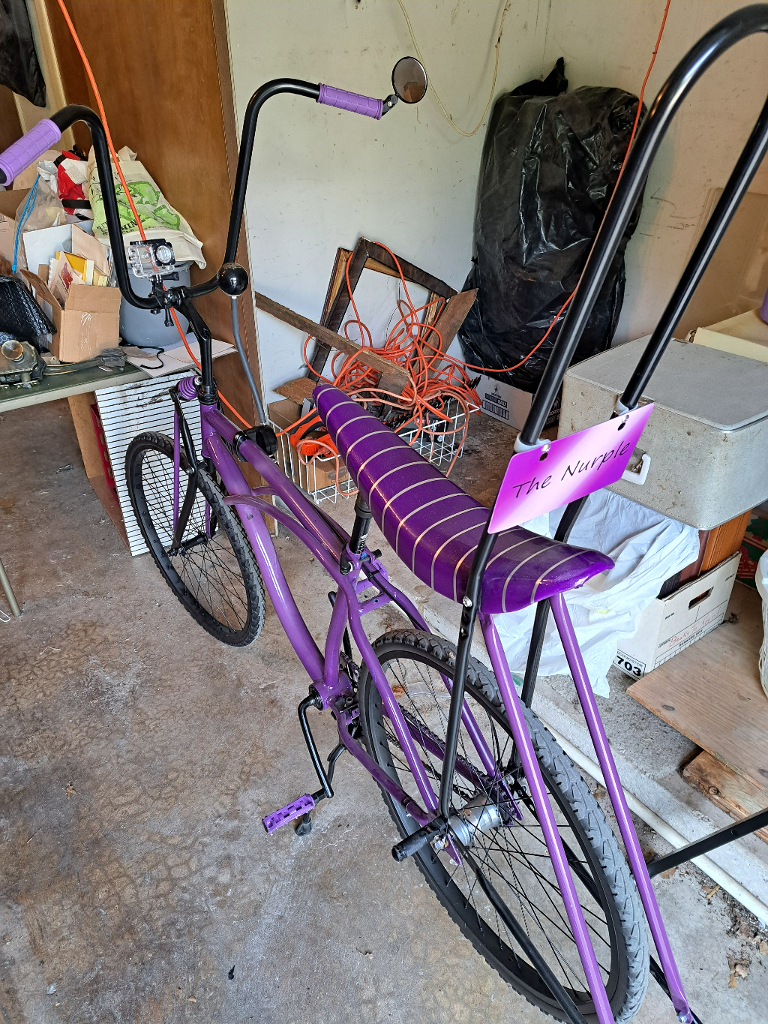

Then, I was sitting there looking at the bike and lamenting how un-rideable it is due to (tee hee... doo doo!) the seat being too low.  I was trying to think of how I could extend the sissy bar to raise the seat and decided that another bracket otter do the trick.  So I bunged a couple out and bolted them on...
thus raising the seat 2"...

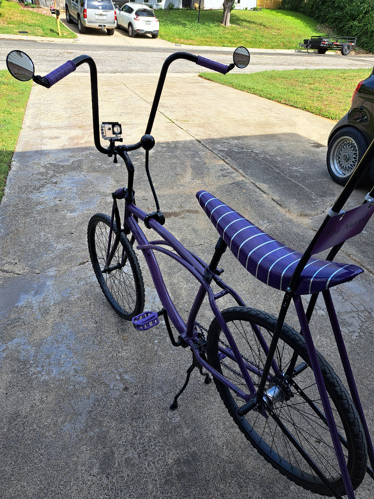

I rolled it out and had a quick ride around the parking lot...

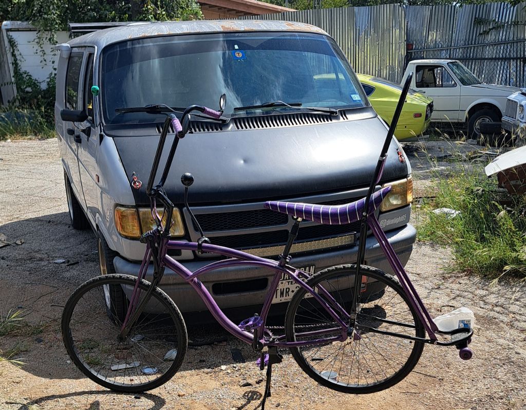

before taking a beauty shot and parking it inside...
It seemed like the extra 2" helped, but I won't know for sure until I get it back home and see how far I can ride it.
