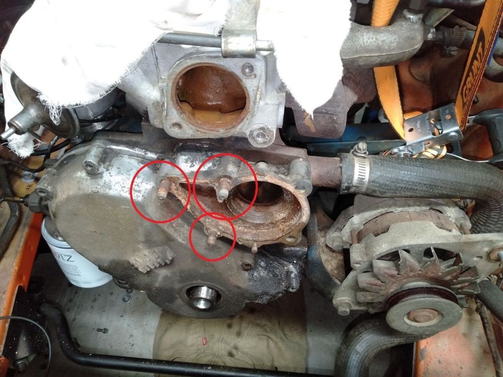

Thanks Morrisun. This was really helpful. I found the fuel pump and have posted pictures below.

The car won't stay running without some intervention. I am unsure whether:
- The hard fuel lines from the tank to the engine bay are free flowing or blocked,
- The fuel lines are perished and letting air into the system and prohibiting a vacuum,
- The fuel pump is not working properly.
That said, I can get it running and idling nicely with some very dodgy fuel-can-and-siphon techniques. But this just proves the engine runs (which is GREAT!) but doesn't help diagnose any of the above issues. There was fuel dripping out some of the lines, so that might indicate new fuel lines are needed.
Need to hit the rear hard line with compressed air to find out. Or just have someone blow into one end while you listen at the other end. This does happen, but usually on cars that sat for awhile with the lines disconnected.
Quote
Possible, but not very likely. A big enough hole to allow air to pass will allow fuel to pass also.
Quote
Highly likely, since there is a rubber diaphragm inside that perishes when you leave the car sitting for a long period of time. Easy enough to diagnose, though. Remove the line from the pump to the carb, put it into a clear container, and crank the car over for a few seconds to see if anything comes out.
I have owned a load of Datsuns that have sat for many years. They usually need all the rubber lines replaced, the fuel pump rebuilt/replaced, and the carb cleaned out.
Edited by datsunfreak
Indeed, replace the soft lines under the hood, if they haven't failed yet, they will soon.  I've also seen a number of bad pumps myself.
Throw a cheap electric fuel pump in the line in place of the mechanical one, if it runs well then you have your answer!
I won't say I haven't had to dump the crud out of a carburetor from time to time, but on the Datsuns I've wasted more time doing that when I should have been looking elsewhere.  It isn't a bad idea to back-flush your main fuel line with some compressed-air, just don't go crazy with the line pressure, I just tried to unblock some fuel lines on a Ferret scout car and damaged the tank through overpressure. 😞
To clarify, I was saying apply pressure back to front, not front to back. You DO NOT want to blow any debris INTO the fuel tank.
Quote
Datto tanks are surprisingly robust.  😁
Also something I did not see mentioned earlier, there should be a drain plug in the bottom of the tank, accessible via a hole in the floor, sealed with a round rubber plug just above the rear axle. No need to siphon the fuel out of these tanks.
Unless the Aussie cars did something different to the USDM/JDM cars with their fuel system.

I've made an educated guess that the hard lines are clear. As far as I can tell, the lines were always connected, even while the car sat for over 10 years. I also don't have access to a compressor. That's a future purchase!
Upon closer inspection, I did discover that many of the soft lines had perished, so they've been replaced.
I wasn't 100% certain the old pump wasn't working, but I replaced it as a preventative measure as I definitely do not want to be stranded. Like you mention, I've read everywhere that the diaphragms in these deteriorate if the car isn't used.
On 8/7/2020 at 4:16 AM, datsunfreak said:
In case it wasn't obvious, if you get fuel out of the pump, it likely needs the carb cleaned/rebuilt.
Sadly, I think you've nailed it. I've never rebuilt a carb, so this is scary new territory. In fact, there are very few car things I have actually done, so this car is a steep (but fun) learning curve.

Thanks also for this tip. Yes, I found the drain plug under the tank which was very helpful with the flush.
Posted (edited)
Thanks again to your help, and that of @slowlearner, Doris (as the car is now known as) moved under her own power for the first time in many years.
I finally pulled my thumb out and tested whether there was adequate fuel pressure at the carb. I don't know why I didn't do this earlier. Here are the results.
The car will start without any help, will run for a while especially with the manual choke pulled out, but once it returns to a normal idle it cuts out. I can't figure it out ... yet.
This went on all afternoon without resolution. I did manage to get the car to move up our driveway, but she soon conked out and I had to roll it back down. No pedal brake, just the handbrake. Sketchy as.
