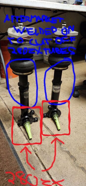

konig209 Posted December 22, 2022 Author Report Share Posted December 22, 2022 On 11/13/2022 at 5:46 AM, datzenmike said: The spindle is basically the strut itself. Unless one of the bearings seized and ruined the spindle, it probably just needs inner and outer bearings replaced and repacked with new grease. Bad bearings make a growling sound. Ehhhh the hub was bad to begin with. I said fuck it and put it together anyways. Now its kicking my ass. So im going to cut them off and start over. Quote Link to comment
datzenmike Posted December 22, 2022 Report Share Posted December 22, 2022 What is bad? The spindle runs on replaceable bearings mounted in the hub. Cut what off???? Quote Link to comment
konig209 Posted December 25, 2022 Author Report Share Posted December 25, 2022 On 12/22/2022 at 7:57 AM, datzenmike said: What is bad? The spindle runs on replaceable bearings mounted in the hub. Cut what off???? The wheel hub its bad. As in the bearing race just dropped in when i put it together. Would need to be cut and sleeved to fit the outer race right. So im just going to buy a new pair of used 280zx spindles and have them welded up to my struts again with new bearing and seals. Quote Link to comment
datzenmike Posted December 25, 2022 Report Share Posted December 25, 2022 There were two outer bearings and races for the 610. Earlier ones were the same as the 510 and were smaller. If you have a '74 and older hub but an early bearing and race it might appear loose in the hub. No one cuts the spindle off and welds them to their strut tubes. And certainly not those from a 280zx. The 280zx has a different caliper mount spacing so your 610 calipers won't fit, nor will the 280zx caliper fit the 610 rotor. What's usually done is the 280zx strut us entirely swapped for the 610 struts. Quote Link to comment

konig209 Posted January 22, 2023 Author Report Share Posted January 22, 2023 On 12/25/2022 at 3:26 PM, datzenmike said: There were two outer bearings and races for the 610. Earlier ones were the same as the 510 and were smaller. If you have a '74 and older hub but an early bearing and race it might appear loose in the hub. No one cuts the spindle off and welds them to their strut tubes. And certainly not those from a 280zx. The 280zx has a different caliper mount spacing so your 610 calipers won't fit, nor will the 280zx caliper fit the 610 rotor. What's usually done is the 280zx strut us entirely swapped for the 610 struts. What are you talking about?2023-01-21_10-26-04 by Carlos Ortiz, on Flickr 2023-01-21_10-26-40 by Carlos Ortiz, on Flickr Quote Link to comment
datzenmike Posted January 22, 2023 Report Share Posted January 22, 2023 8 hours ago, konig209 said: What are you talking about?2023-01-21_10-26-04 by Carlos Ortiz, on Flickr 2023-01-21_10-26-40 by Carlos Ortiz, on Flickr On 12/25/2022 at 1:08 PM, konig209 said: The wheel hub its bad. As in the bearing race just dropped in when i put it together. Would need to be cut and sleeved to fit the outer race right. So im just going to buy a new pair of used 280zx spindles and have them welded up to my struts again with new bearing and seals. Did I miss understand? Quote Link to comment
thisismatt Posted January 22, 2023 Report Share Posted January 22, 2023 20 minutes ago, datzenmike said: Did I miss understand? Seem to have? He's using just the spindles from 280zx, with new tubes welded on. Although, not sure why he's redoing that work if it's just the hubs that have spun bearings, but maybe the spindles we're damaged also 🤷♂️ Quote Link to comment
konig209 Posted January 22, 2023 Author Report Share Posted January 22, 2023 50 minutes ago, thisismatt said: Seem to have? He's using just the spindles from 280zx, with new tubes welded on. Although, not sure why he's redoing that work if it's just the hubs that have spun bearings, but maybe the spindles we're damaged also 🤷♂️ The hubs were bad. I drove on bad hubs did 1300 mile trip. Completely fried the spindles. Lotta heat marks on them now. So i replaced it all. Now i have a spare set of zx spindles and hubs to throw away. Or repair idk. 1 Quote Link to comment
datzenmike Posted January 22, 2023 Report Share Posted January 22, 2023 The strut tubes are welded to the spindles at the factory. If you get a set of zx struts just put them on as they are. Maybe these are the tubes you mean? Quote Link to comment
thisismatt Posted January 22, 2023 Report Share Posted January 22, 2023 mike, you're dense 😆 Quote Link to comment
datzenmike Posted January 22, 2023 Report Share Posted January 22, 2023 Apparently Quote Link to comment
