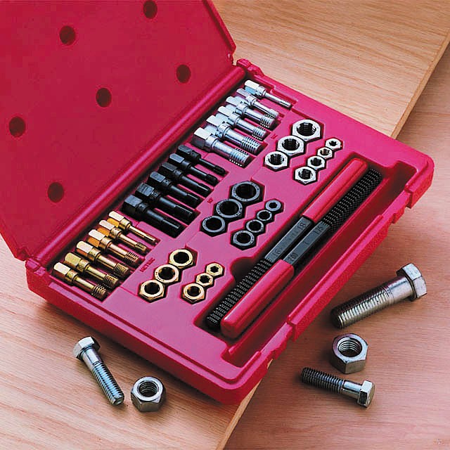

Thats true. To clean threads you use a thread chaser, not an actual tap.
Not a perfect answer but I have taken old head bolts and ground off the threads down 3 narrow strips along the thread length. Rub a little grease into these cavities and as you thread it in, the threads cut and push any debris into the ground out area and the grease holds it. Back it out, wipe it off and do it again till it comes out clean.
That's the tool. Couldn't think of the name.
Thread Chaser
Thread Chaser
I've already taken care of it but will check with NAPA and see if they can get me one if needed in the future.
Yeah, I bought a set from Sears. Invaluable for general clean-up.
