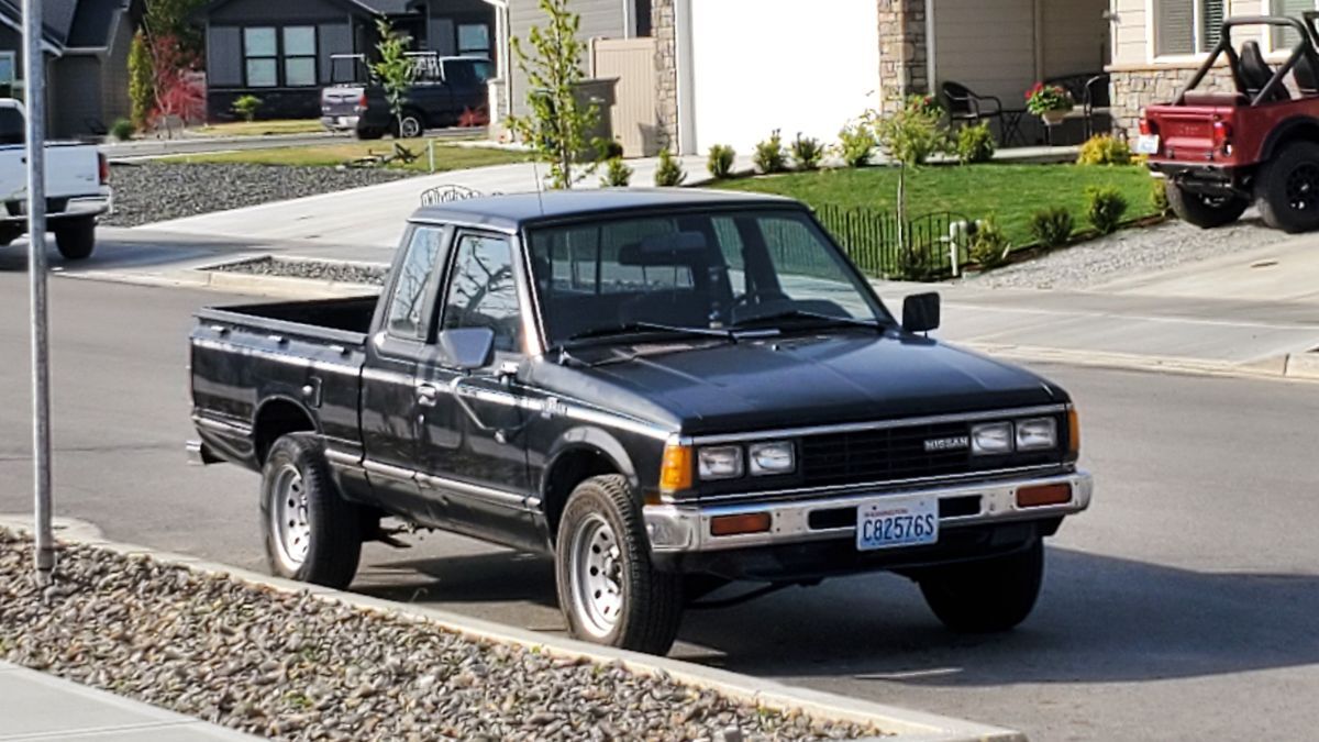

KELMO Posted September 4, 2021 Report Share Posted September 4, 2021 Looks like a fairly unmolested truck. I am curious, does the tailgate say Datsun? y girlfriend (at the time, long time ago) bought one of these new and I cannot remember what was on the tailgate. 1 Quote Link to comment
Charlie69 Posted September 4, 2021 Report Share Posted September 4, 2021 My 1980 720s Had Datsun embossed on the tail gate. I still have 1980 tail gate I will use on my 84 ST. Quote Link to comment
KELMO Posted September 4, 2021 Report Share Posted September 4, 2021 Just can't remember if '83 tailgate was Datsun or Nissan. Mostly sure '84 was Nissan. My attention at the time was focused on the back of something else. 1 Quote Link to comment
datzenmike Posted September 4, 2021 Report Share Posted September 4, 2021 '82 was the last year for DATSUN 11 '82 was the start of the '83 model year and the full change to NISSAN stamped tail gates. In a 'tip 'o the hat' to the earlier Datsun marque the '83s and perhaps the '84s had DATSUN decals on them. The '84 was similarly stamped but the '85 tailgate has a recess across the back with a finisher panel in it with NISSAN lettering. That said it's possible that a few '82 DATSUN stamped tailgates found their way onto some '83s. 1 Quote Link to comment

That Ol 720 Posted September 7, 2021 Author Report Share Posted September 7, 2021 On 9/4/2021 at 7:09 AM, KELMO said: Looks like a fairly unmolested truck. I am curious, does the tailgate say Datsun? y girlfriend (at the time, long time ago) bought one of these new and I cannot remember what was on the tailgate. Nope it says Nissan in all caps 1 Quote Link to comment
