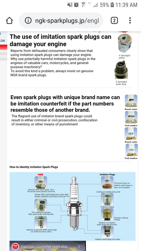

Crashtd420 Posted June 21, 2020 Report Share Posted June 21, 2020 (edited) I actually just bought some of the lazer iridium plugs for my wifes Subaru and just went to have a look.... I spent $40 for a set of 4, I did buy them off ebay so I was a little worried after reading this.. One thing I noticed was if you read the listing the cheaper ones while marked ngk were listed as unbranded.... The ones I bought stated they are ngk brand and they seem to be legitimate from the way ngk tells you to identify them.... This from the ngk website... http://www.ngk-sparkplugs.jp/english/techinfo/fake/index.html I could actually see the ngk marked In the wrong location in the ebay pictures.. Edited June 21, 2020 by Crashtd420 1 Quote Link to comment
thisismatt Posted June 21, 2020 Report Share Posted June 21, 2020 Just now, Crashtd420 said: I actually just bought some of the lazer iridium plugs for my wifes Subaru and just went to have a look.... I spent $40 for a set of 4, I did buy them off ebay so I was a little worried after reading this.. One thing I noticed was if you read the listing the cheaper ones while marked ngk were listed as unbranded.... The ones I bought stated they are ngk brand and they seem to be legitimate from the way ngk tells you to identify them.... This from the ngk website... I could actually see the ngk marked In the wrong location in the ebay pictures.. I made this mistake - bought NGK iridiums off ebay and they are counterfeit. Half of them wouldn't even fit in my normal spark plug socket. Unfortunately I waited too long and wasn't sure at the time that they were counterfeit, so I didn't return them. Bought real ones at the LAPS and really they weren't that much more expensive... 1 Quote Link to comment

Crashtd420 Posted June 24, 2020 Report Share Posted June 24, 2020 Out of curiosity I decided to look up other brands than Ngk as being counterfeit.... Guess what you can find counterfeit versions of every brand spark plug.... Ngk Bosche Denso and Champion to name a few.... I would still go with the ngk... Go to Ngks website and they should have a list of legitimate suppliers..... 1 Quote Link to comment
