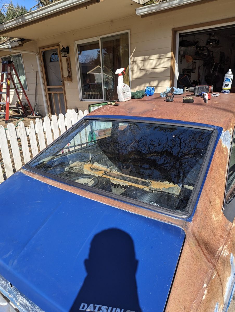

- Replaced the windshield, got a funky seal from thailand that I still need to change out

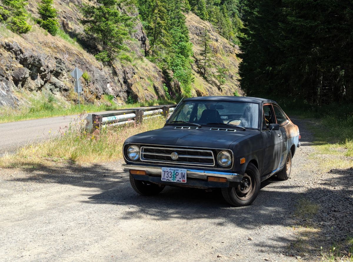

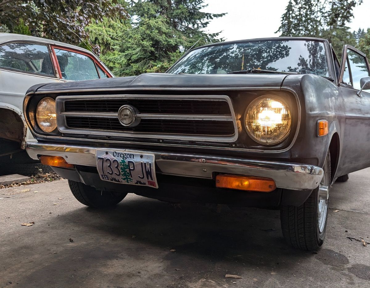

We'll kick off the photos where Aaron found it. I'll get to the orange car sometime too - I got it running first but I'm a sucker for a rusty car so it's a priority.
PXL_20240308_155725089.RAW-01.COVER(1).thumb.jpg.40f0817a9f20679bd11a877c10a2df02.jpg

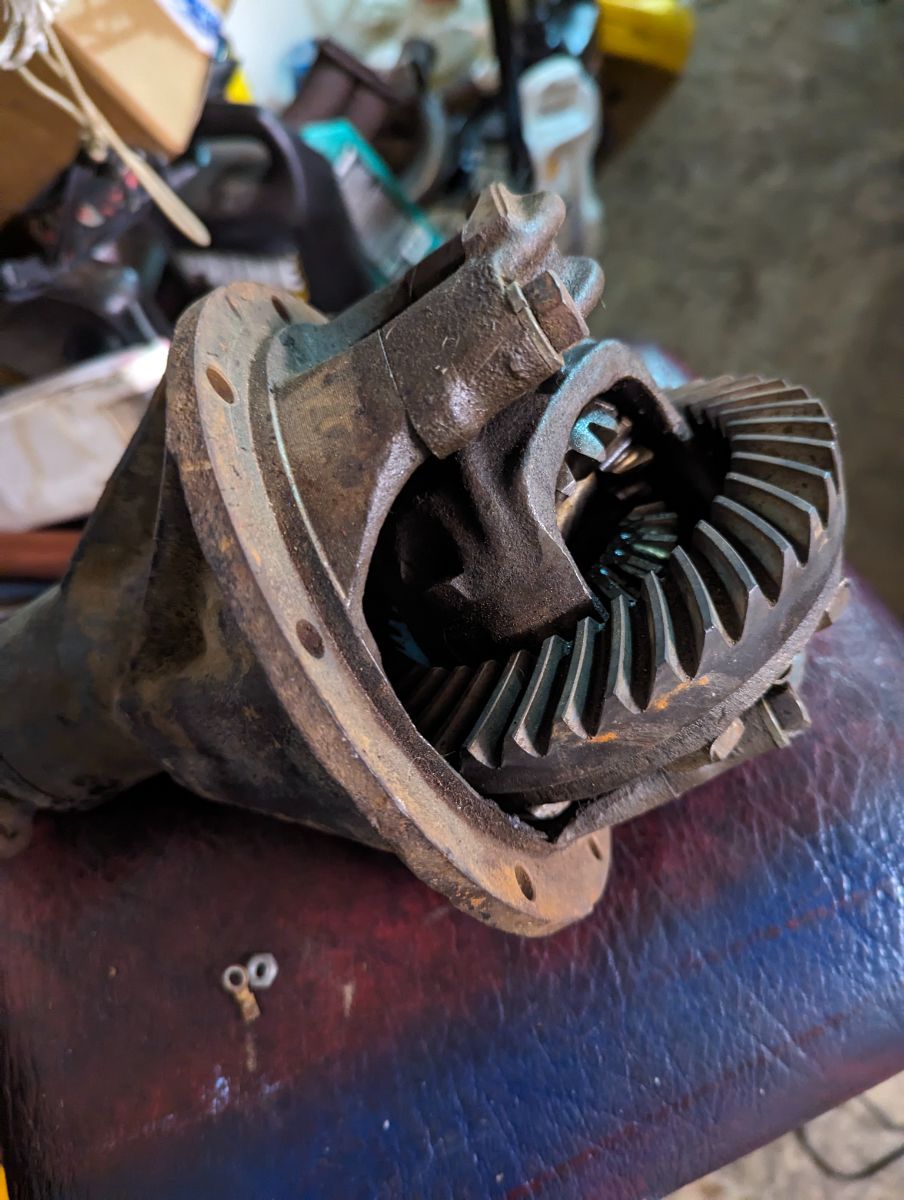

Got a clunk in the rear end and a whine at slight load that's been there since I got it but as I seal everything up and everything else gets quieter it's getting more annoying. We'll see how long that lasts, I've got a spare diff to clean up and try out at some point

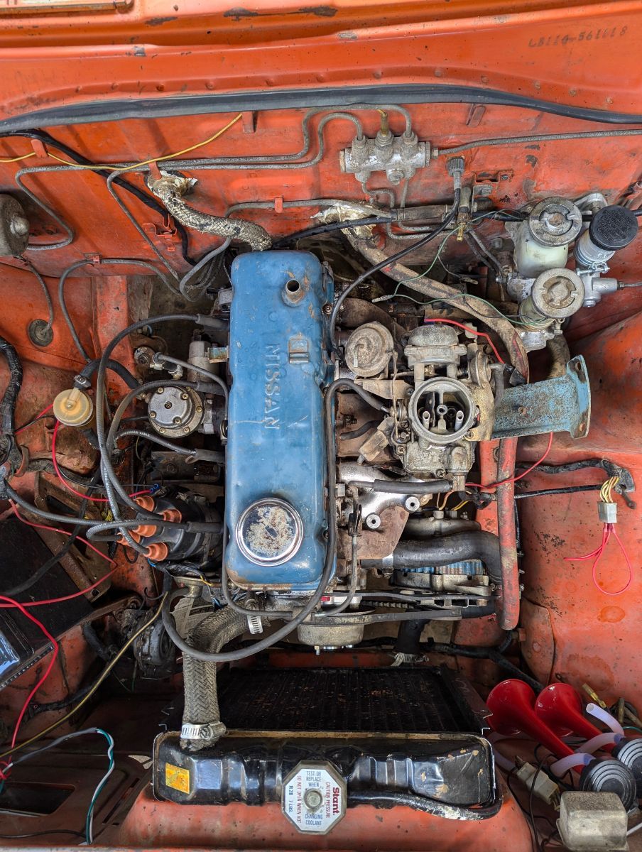

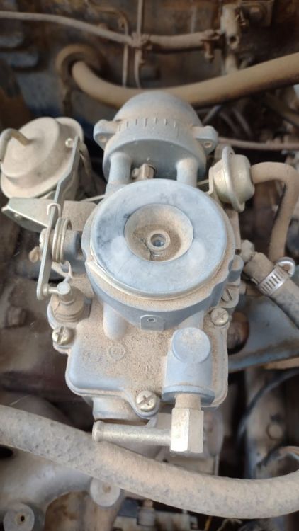

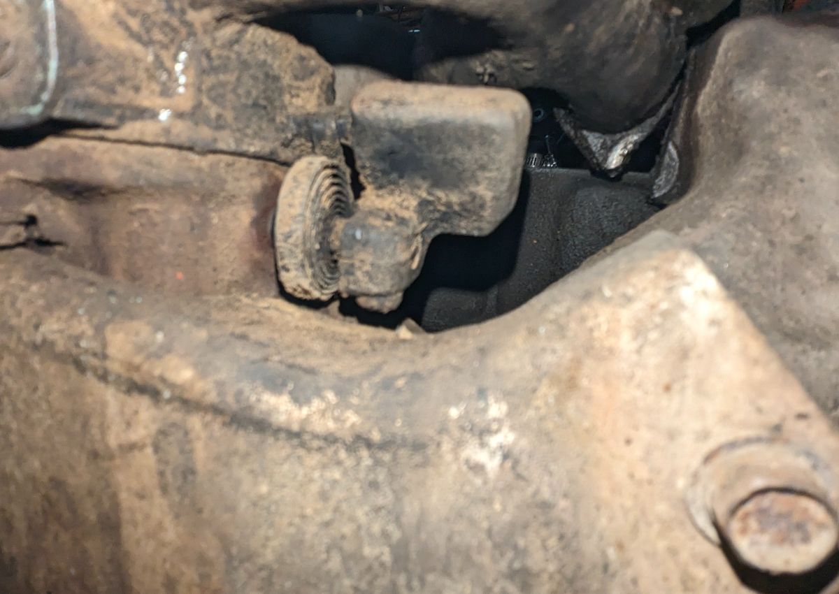

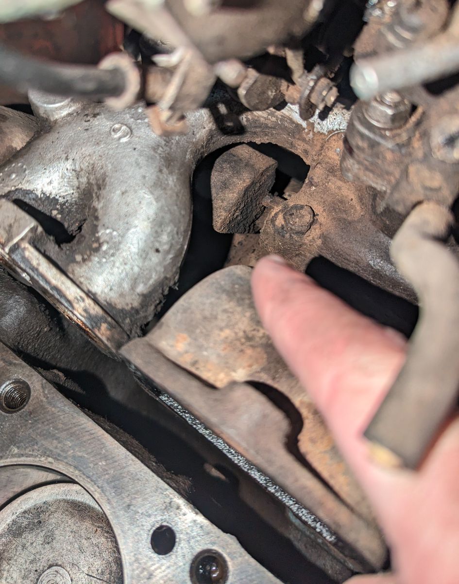

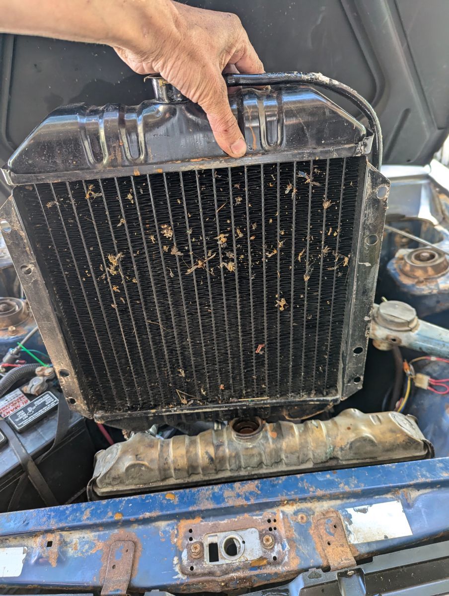

The heat exchanger gasket blew over the weekend, so I replaced that gasket and found out the little coil that makes the whole thing work was disconnected and the flap was just flopping around as I drove. No more exhaust smell and it cold starts like a champ!
Right under the carb, the gasket goes between the intake and the exhaust, but the flap is within the exhaust and held in the right spot with a little coil that's similar to an electric choke coil, so, until it's heated up it runs some hot air past a heatsink on the underside of the intake.
I didn't take and pictures when I fixed it but here's what it looks like on another engine.

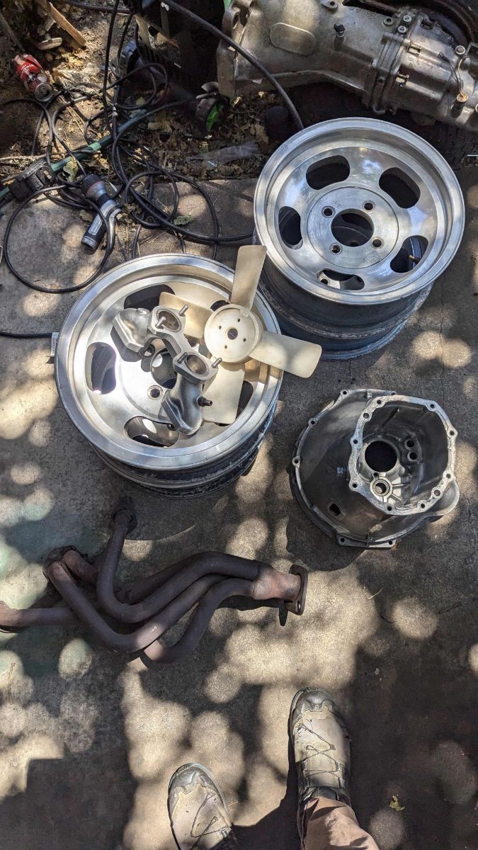

Scored some fun goodies at powerland. Thanks to Doug, Jerry and Draker! Should have a 5 speed together before winter!

Finally replaced the diff with the rebuilt unit that was in the back seat of the car when I got it and repacked the rear bearings. There was a 4dr 210 that had a known good 5 speed in town I've seen lately, so I bought it from the kid for a bargain after he somehow ran it dry on oil and spun rod bearing #1. 😅 The drive to Blue Lake was amusingly smooth and quiet.

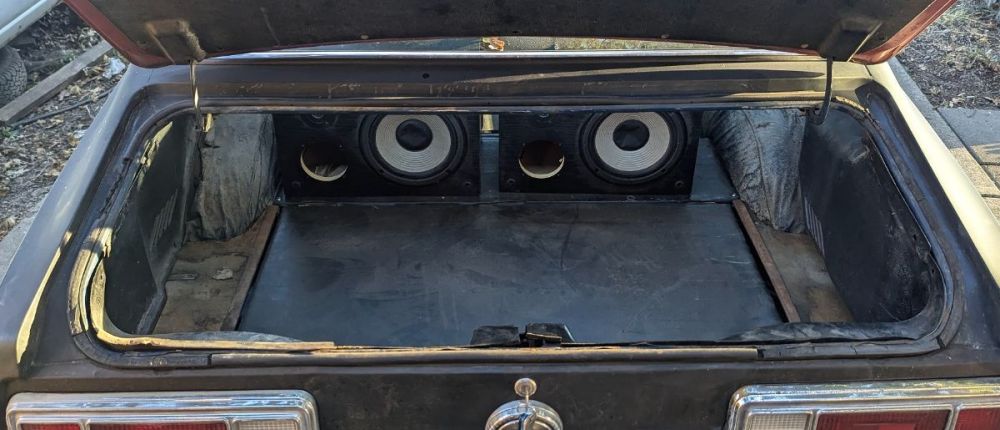

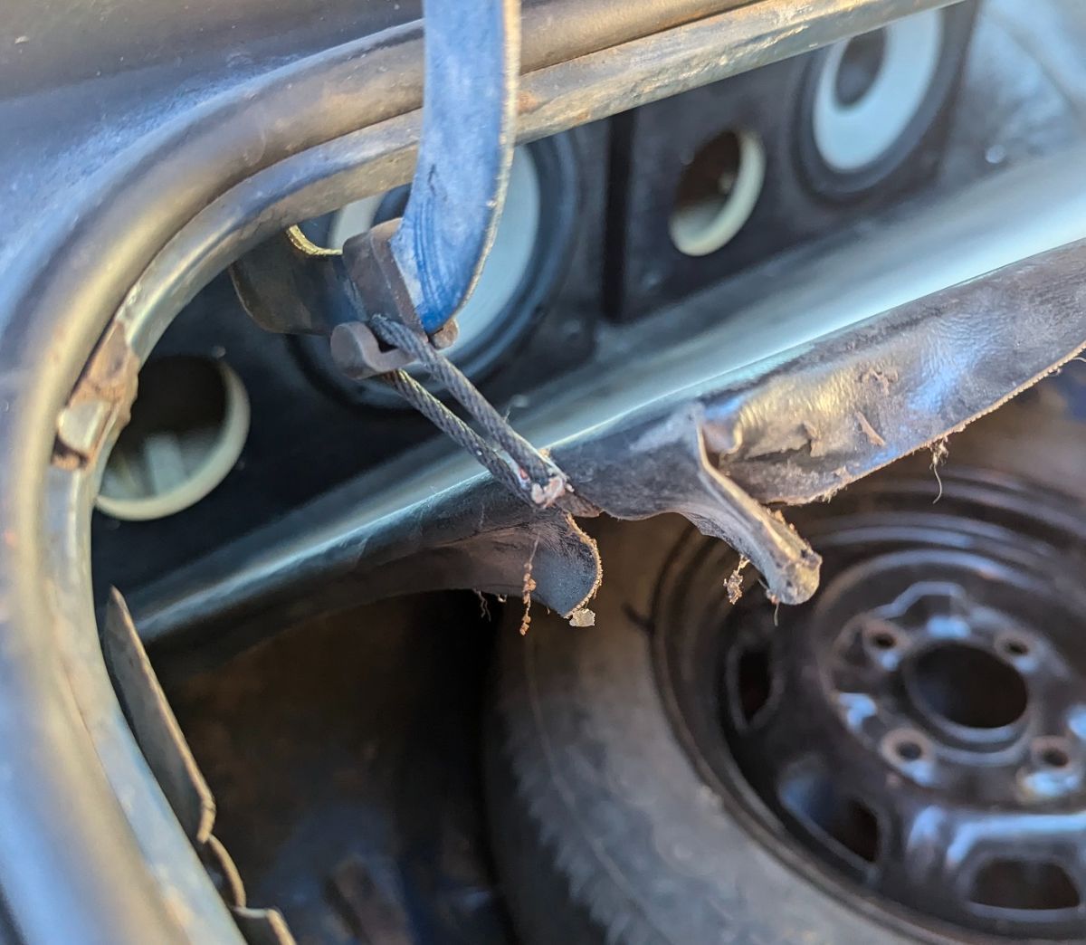

I believe this trunk floor is the last of the original pieces that were downright missing when I got the car. No more stuffing groceries into a rusty spare tire well.
PXL_20240812_023228868.RAW-01_MP.COVER.thumb.jpg.03a037b292eadf91076a9ac4161e0d37.jpg
Even have the little hook and loop intact

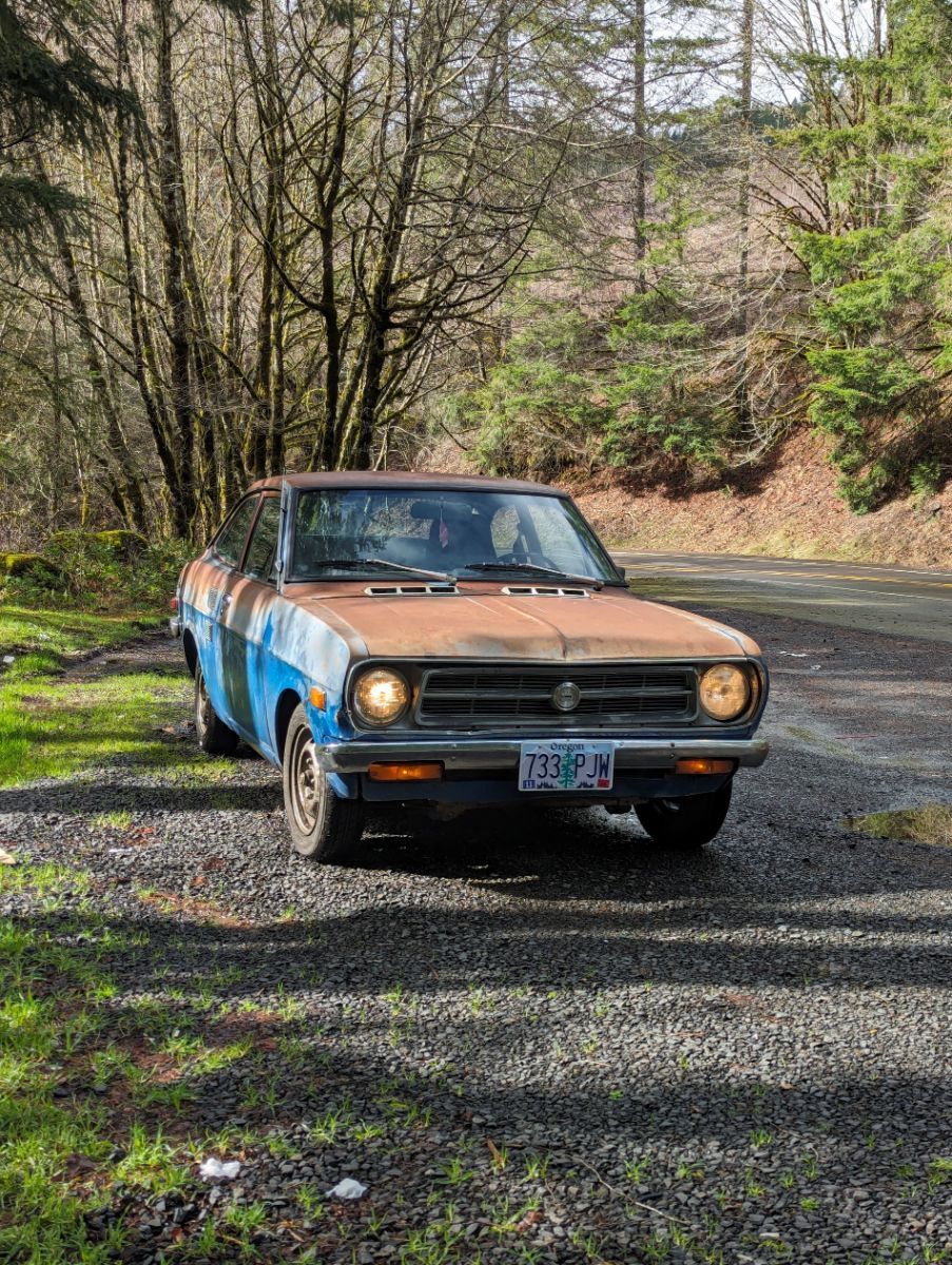

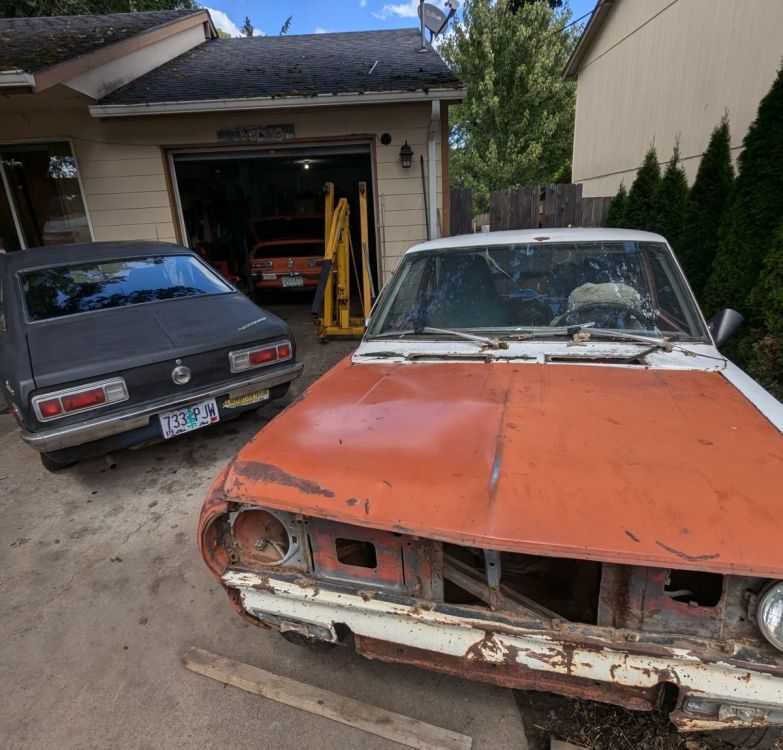

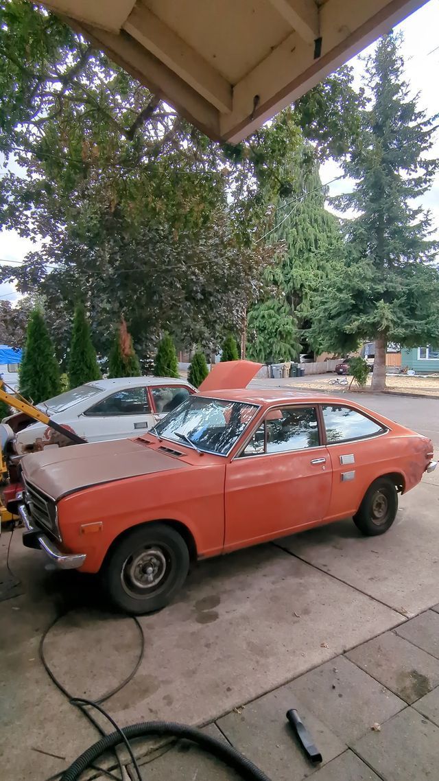

Pulled the orange coupe out today, finally back up and running to some degree! Dropped a matchbox dizzy and IR alt in from the 210 donor and she fired right up again, just gotta sort out the filthy gas tank. The original tank was rusted beyond repair - When Aaron dropped the car off it was sloshing a cocktail of rusty water and 30 year old gas out into the world and that smell still permeates the neighborhood a year later.
Also doing "bored in the garage" stuff like painting spare parts army men colors.

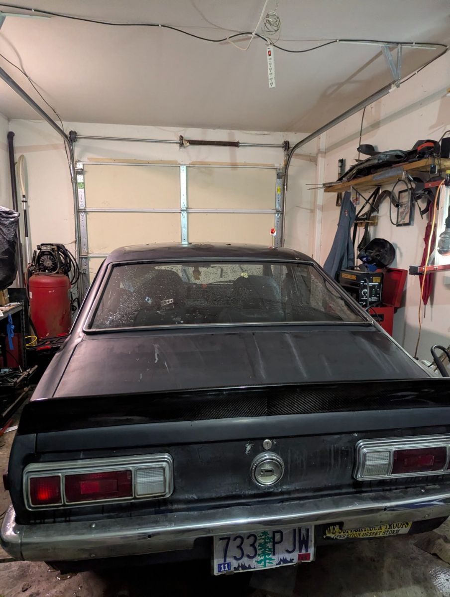

Took a look through the white car a bit more.

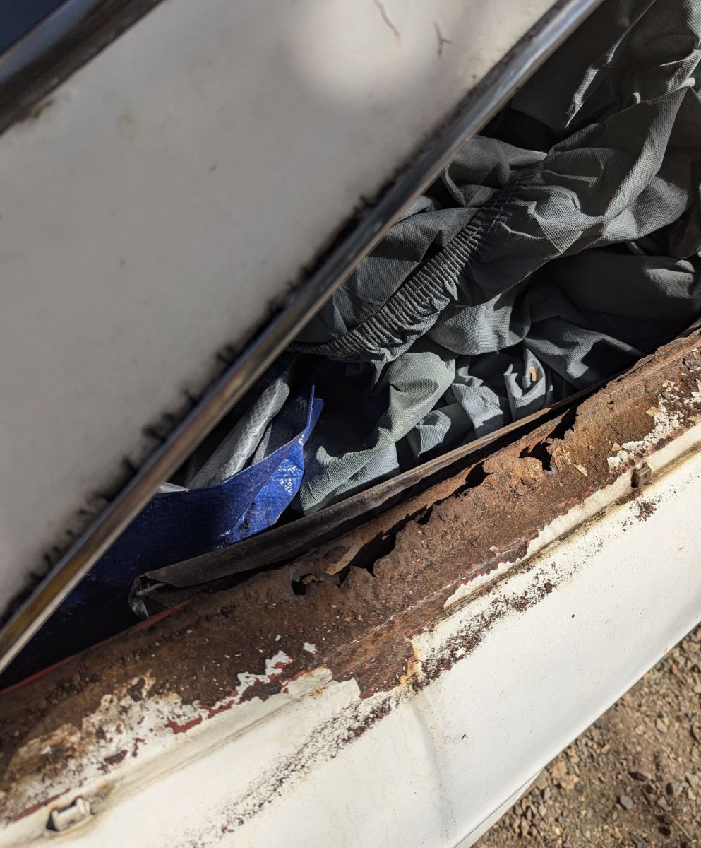

I was planning on making it strictly a parts car, but both other cars are almost parts-complete with spares and there's just a lot of bondo on the white car, making it tricky to cut spare corners from. so I'm leaning back towards patching up the most pressing rust and driving the wheels off it like the good lord intended. If there was ever a perfect candidate to try all my bad ideas out , this would be it. Too bad I traded off the trunk lid recently. 😆
This window sill is gone, and so are some of the rockers, but otherwise it's not the worst I've seen.

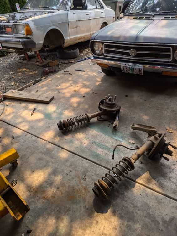

I picked up a pretty beat 210 for the 5 speed, and the 5 speed took a shit within a month or two but I figured I'd swap the suspension over to the 1200 to make something of it until I get the 5 speed fixed.

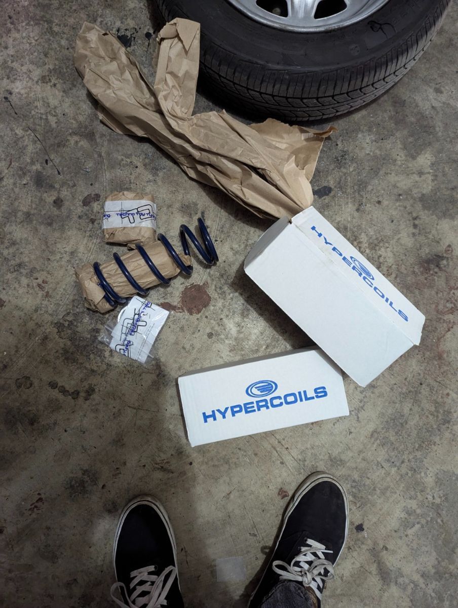

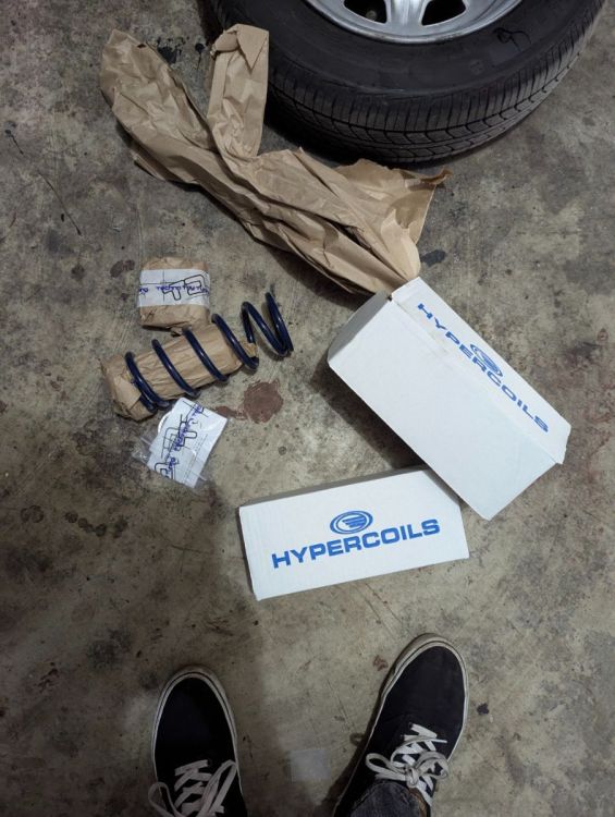

It wouldn't be right without some coilovers that I didn't even take a real picture of
