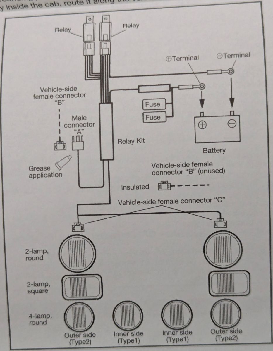

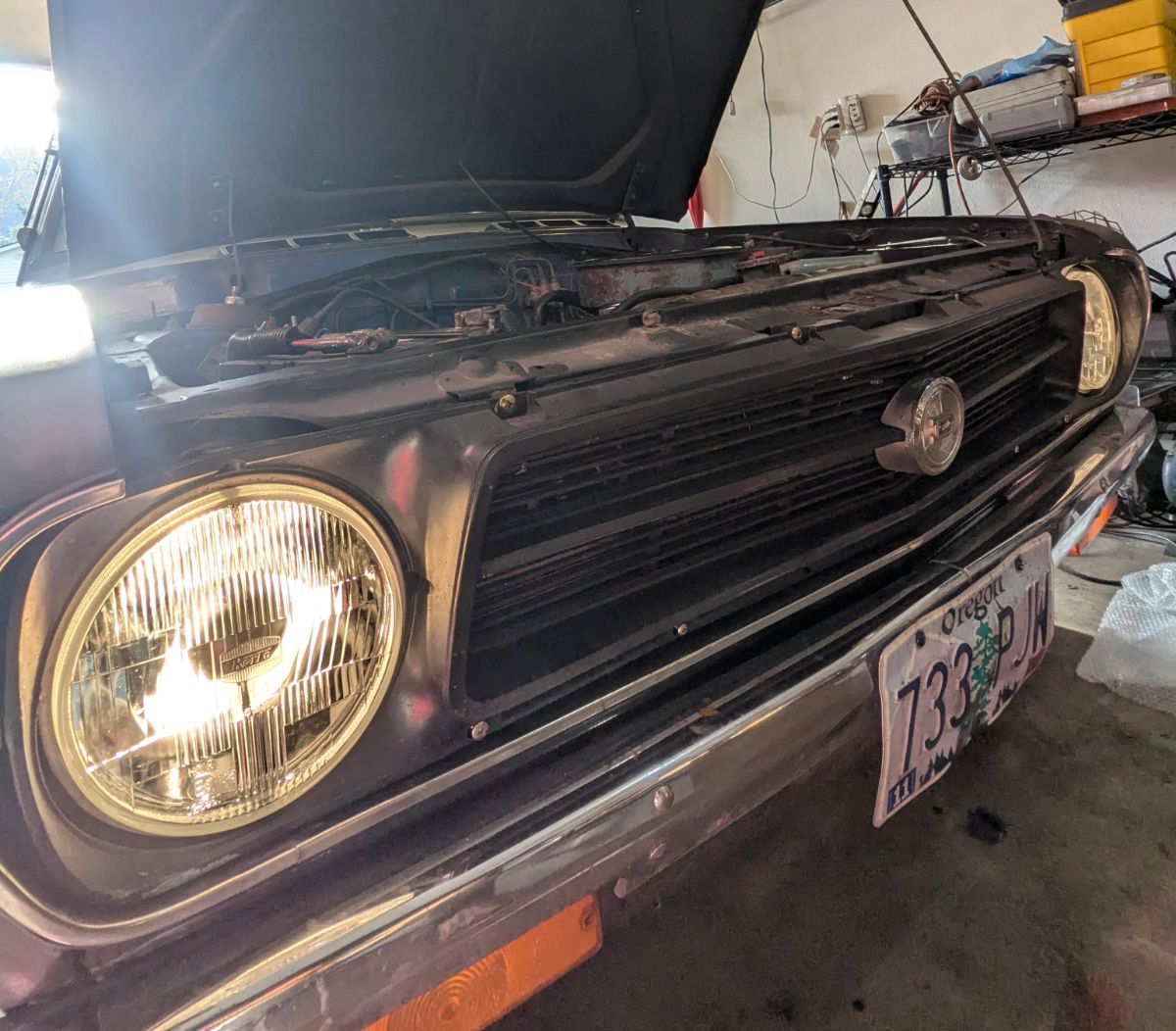

  2. I bet you could get it for $20 at the local Toyota dealer parts counter. All the relays and fuses are Koito labeled as well so I assume the harness is made in Japan. The harness kinda just seems like an OEM grade version of what people have been doing for a long time. Naturally there's 2 annoying feet of slack because it was made for an SUV but the extra length fits under the battery tray just fine. Indicator works great and the relays added a satisfying click:
  3. Hell yeah. Got a set and they're great. I hooked up the relay kit and now my lights are twice as bright from the test fit with stock wiring.

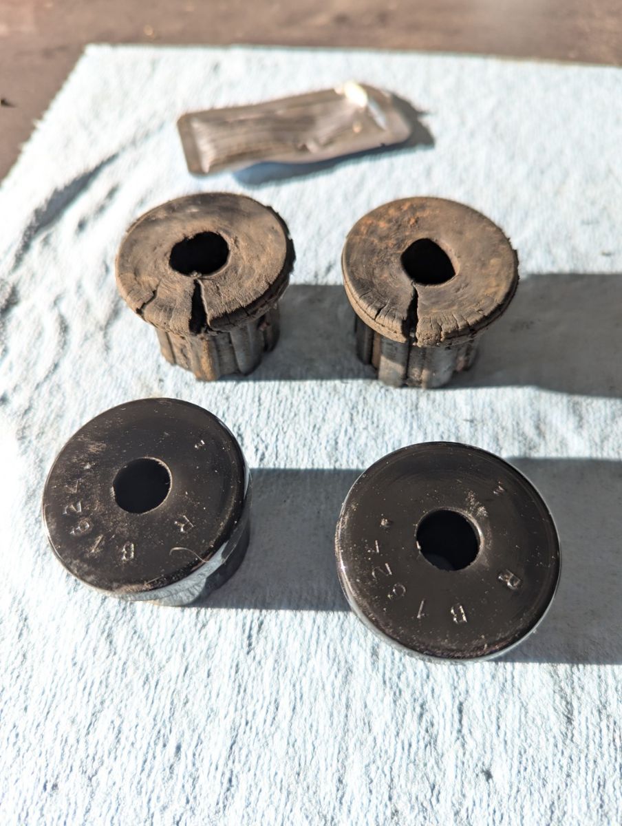

  5. I'm using NOS rubber bushings that I conveniently found under the back seat. I was looking at durothane but I can't get into the 1200 wiki to get part numbers to look up at the moment. I remember finding one or two matches on there. https://durothane.com/by-manufacturer/nissan

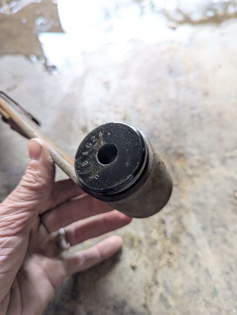

  6. Good deal Doug! Thanks for the washer tip, I'll have to give it a shot. These came with grease so I'm hoping that keeps things from binding up. Luckily I had a bunch of NOS rubber bushings for the rear so now the whole setup is almost new, minus the front uppers which were in suspiciously good shape. Went for a drive on them today and it feels like a different car. The parking brake used to pull the axle forward a little and any roughness in the road on a turn would be a roll of the dice for traction...

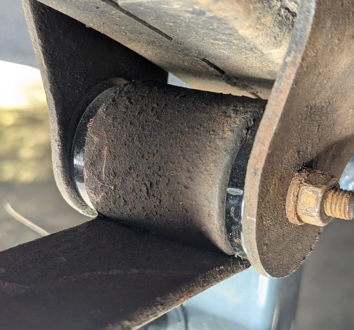

  7. They showed up this morning and fit perfectly. In usual 1200 fashion it took about 30 minutes to pop the shackles off and get it all back together. You can see the rub mark from how far offset the old bushing was sitting. No idea how they ride yet but the holes are the right shape. Test fit on the springs I'm cleaning up. Yikes for comparison

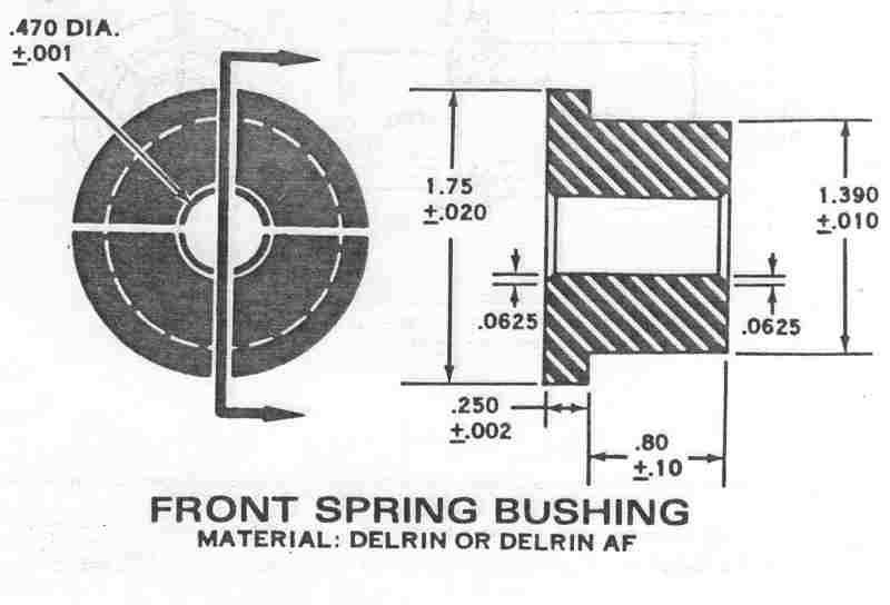

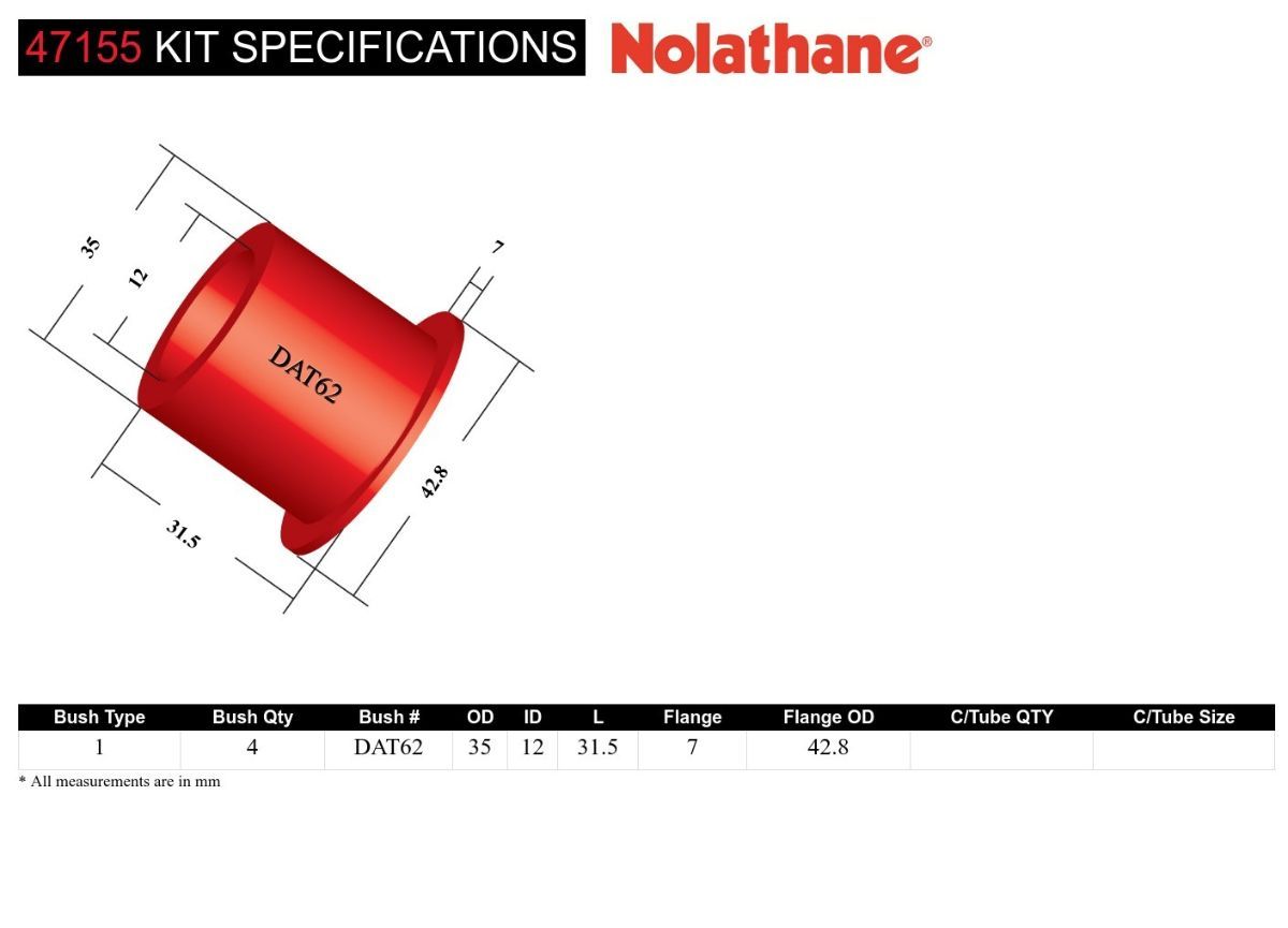

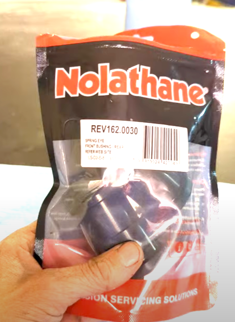

  8. Nolathane sells a lower front leaf spring bushing kit out of California for the 1200 for $15. I ordered a set and some spares while they were on sale a couple days ago, still waiting to see what the scoop really is because they seem a little handwavey online but I hope they fit, hold up, and don't rattle my car apart. I looked into this way too much because I was expecting to have to spend an arm and a leg on some NOS bushings or ship a repop from another country. The dimensions on their Australian site for the part number seem to be about the same as the old Nissan competition drawing. Assuming a lot, here's the $15 + shipping alternative, hope this helps someone in the future and this isn't just a well known thing that I searched for wrong. US Store: https://www.nolathane.com/collections/all/1971-nissan-1200-base-esi8574044 AU part with more info: https://www.nolathane.com.au/product_detail.php?part_number=47155&sans_vehicle=1&foreign_match=1&foreign_part=REV162.0030
