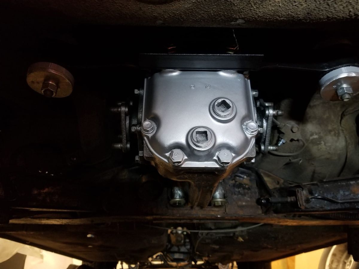

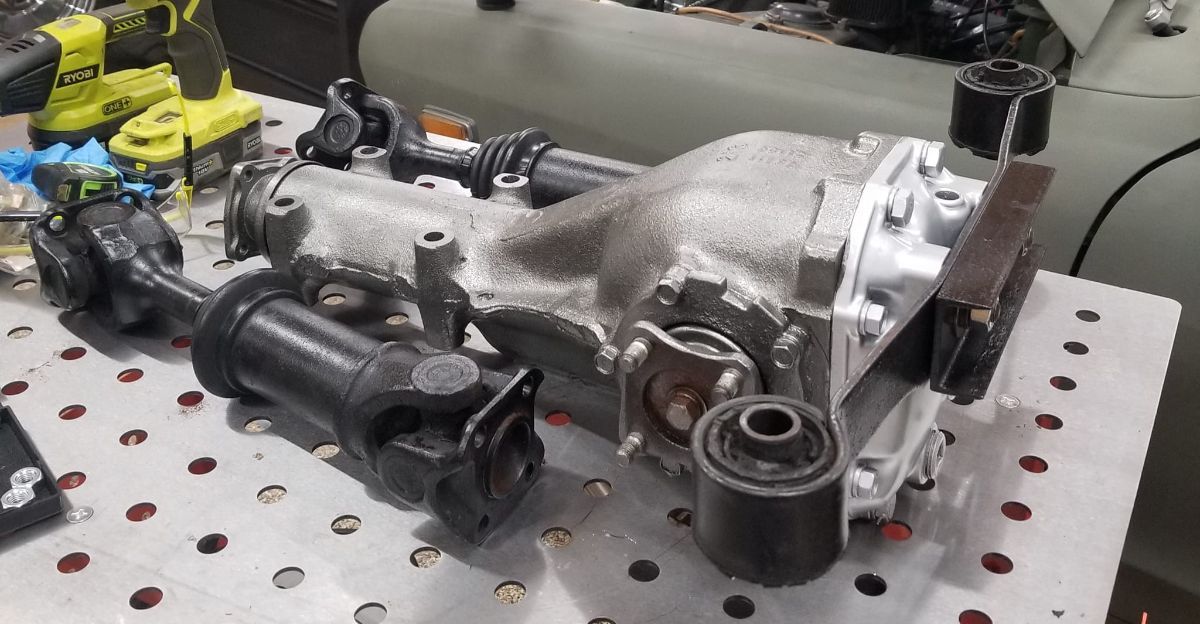

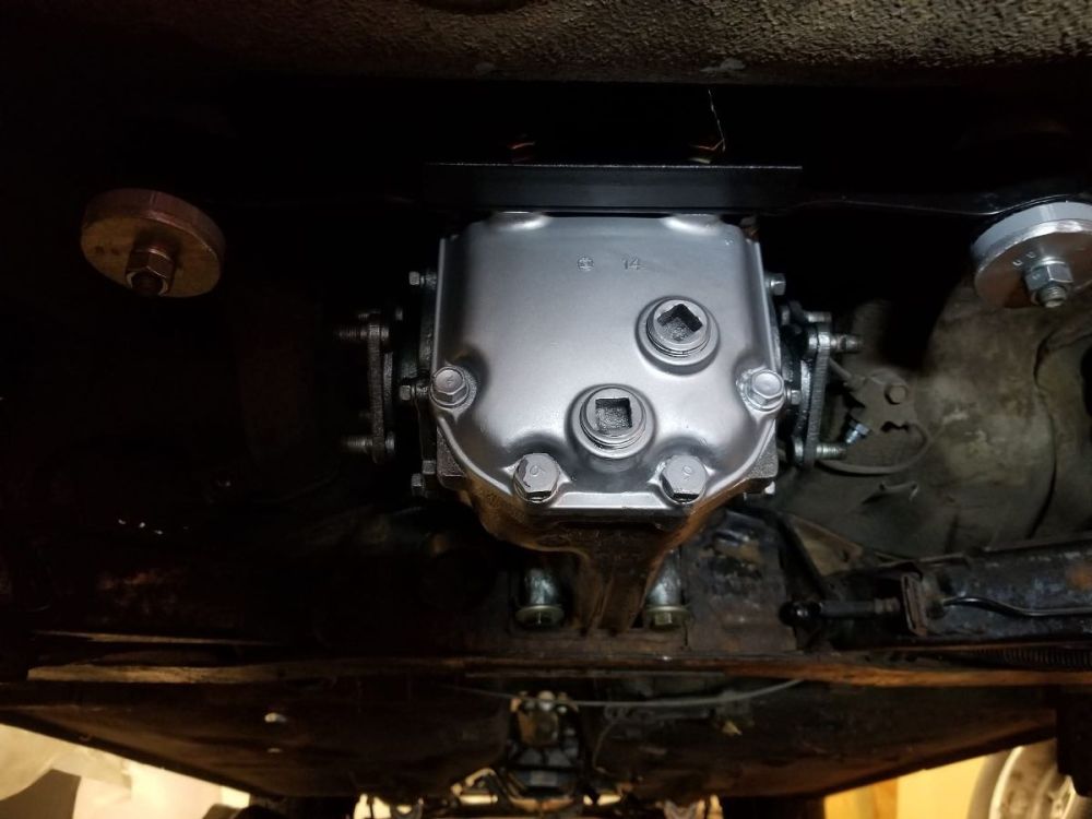

Dguy210 Posted January 5, 2025 Author Report Share Posted January 5, 2025 (edited) I'm missing some random hardware as I put this back together. Ended up making new urethane spacers for top and bottom and made new large fender washers also. Cramming it in was fun. Edited January 5, 2025 by Dguy210 2 Quote Link to comment
