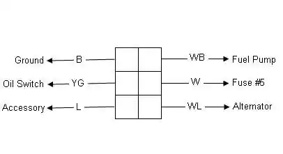

Tinman Posted July 11, 2013 Report Share Posted July 11, 2013 OK.... if a "Mechanic" is having problems with a truck THIS simple, you need another mechanic. The pump has a ground wire, and a plus to the relay. It's super simple to troubleshoot. Measure a few points with a meter and see if it's a fuse, the relay, or a missing signal from the alternator and oil sender. The 720 is designed to shut off the fuel if the oil pressure drops or the engine stops. (no alternator signal). A single jumper in the fuel relay plug will run the pump right off the ignition switch. To keep a 720 reliable: Do NOT use aftermarket parts. Mine is 28 years old, original fuel pump and relay. New filters every few years, as a clogged one can burn up the pump from overworking it. The only thing that goes wrong with the fuel pump relay is a bad solder connection. Easy fix, and generally permanent. Make sure the ground wires are good between the pump and the frame, and the frame and the battery. BTW, I had to get a new account... my email changed. I'm not as new as I seem. Don't let the low post count scare you. I DO know the 720 quite well in 28 years owning them. Quote Link to comment

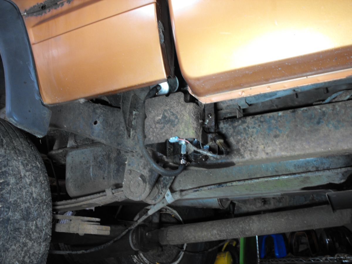

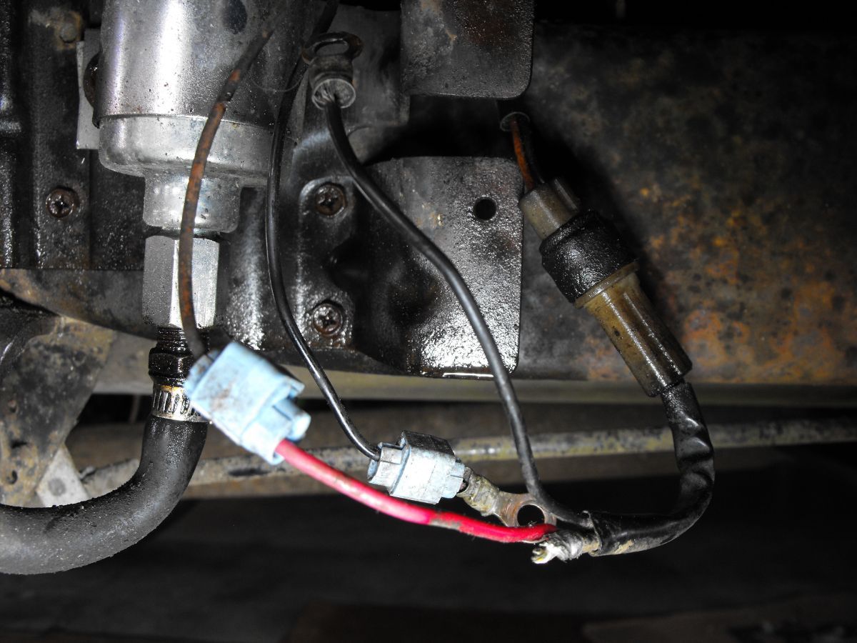

RandyR Posted July 2, 2015 Report Share Posted July 2, 2015 I am posting this because I have referred to this forum numerous times and it helped me, so I hope this helps someone else. READ THIS BEFORE BUYING A NEW FUEL PUMP!! I now own 3 working Nissan 720 fuel pumps! Here's why: About 6 months ago, I am driving my '84 720 to work. I barge into a snowdrift and it throws me 180°. Weee what fun. About the time I have to get out and lock in the hubs and get back in, the truck dies - WON'T restart. I have someone from work pull me to the shop. Troubleshooting the problem, we discover it's not pumping fuel (took the larger of the 2 fuel lines apart in the engine compartment (after cleaning out the packed snow). No fuel being pumped there. We test voltage at the fuel pump and it's OK. Assume the fuel pump is bad. Bought a new fuel pump. I kept the connector plug in place and spliced the wires leaving the plug onto the new fuel pump so that in the future I could easily swap out the pump by simply unplugging the connector. $60 later, I'm happy it's running. I stow away the old fuel pump because I'm a hoarder. Fast forward 6 months. I'm driving along and notice the truck sputters occasionally, and often dies - won't restart. It seems to happen on occasion, but getting more and more common. At this point, I keep in the back of my mind this COULD be an intermittent electrical problem. I found a forum that talked about checking the solder connections on the circuit board of the fuel relay (mounted to the right of the glove box). I took it apart, and notice the solder connections are OK. Finally I had my chance - I happened to be at home when the problem was occurring, and I had a few minutes to look at it. When I take the fuel line off in the engine compartment and put the hose into a bottle, no fuel is pumping. So I test voltage where the fuel pump is and I get +12V. OK - the problem HAS to be either clogged fuel filters or another bad fuel pump. Since I ran out of time, and I HAVE to get the truck going again, I order another new fuel pump. This time I also order both filters along with it, because the warranty won't cover the pump unless the filters are also replaced. Another $60 plus $20 worth of filters. The filters come one day before the pump, so I change out the filters (original ones were OLD). Truck starts right up, runs for a few seconds then shuts off and won't restart. I again test the voltage to the pump, and of course, it is OK. Test fuel flow under the hood and again it is NOT flowing fuel. I am confident it is a bad fuel pump. Next day the fuel pump comes. I put it in and the truck fires up, runs for a few seconds then shuts off. Won't restart. I ONCE MORE test the voltage at the fuel pump. THIS TIME - NO VOLTAGE!! When I jiggled the wires where the plug connector is at the fuel pump, I can get the power to come on-and-off. Ah that stupid little plug connector! Third fuel pump, numerous breakdowns, and lots of education about Nissan 720 fuel systems, and the problem the whole time was I didn't cut out that little plug connector. So lesson learned: If you suspect your fuel pump has gone bad, first test the voltage BEFORE the little plug connector, and if it is GOOD there, put your test probes AFTER the plug connector and jiggle the wires at the plug and see if you can get the voltage to be intermittent. Anyone need a slightly used Nissan 720 fuel pump? 2 Quote Link to comment

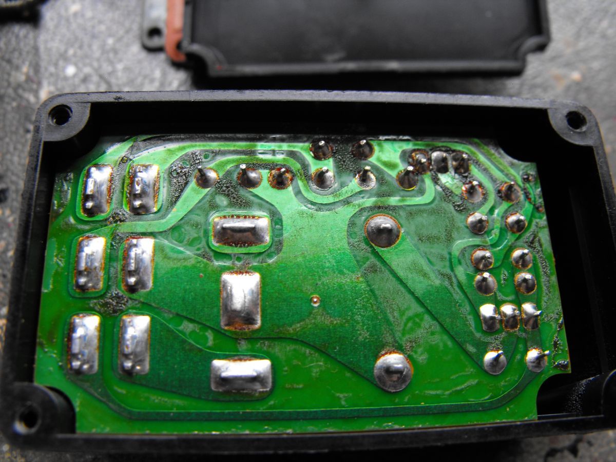

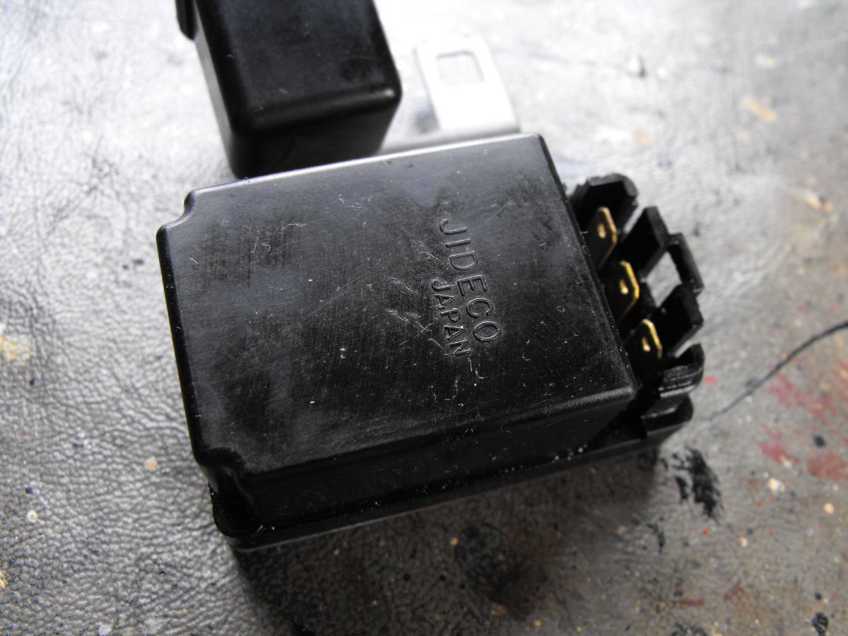

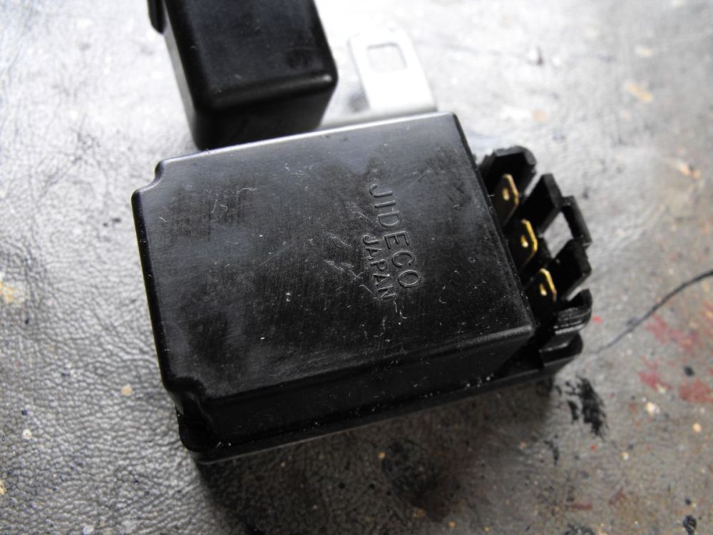

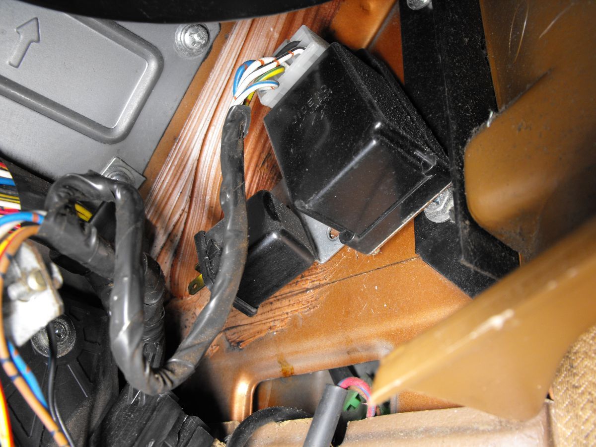

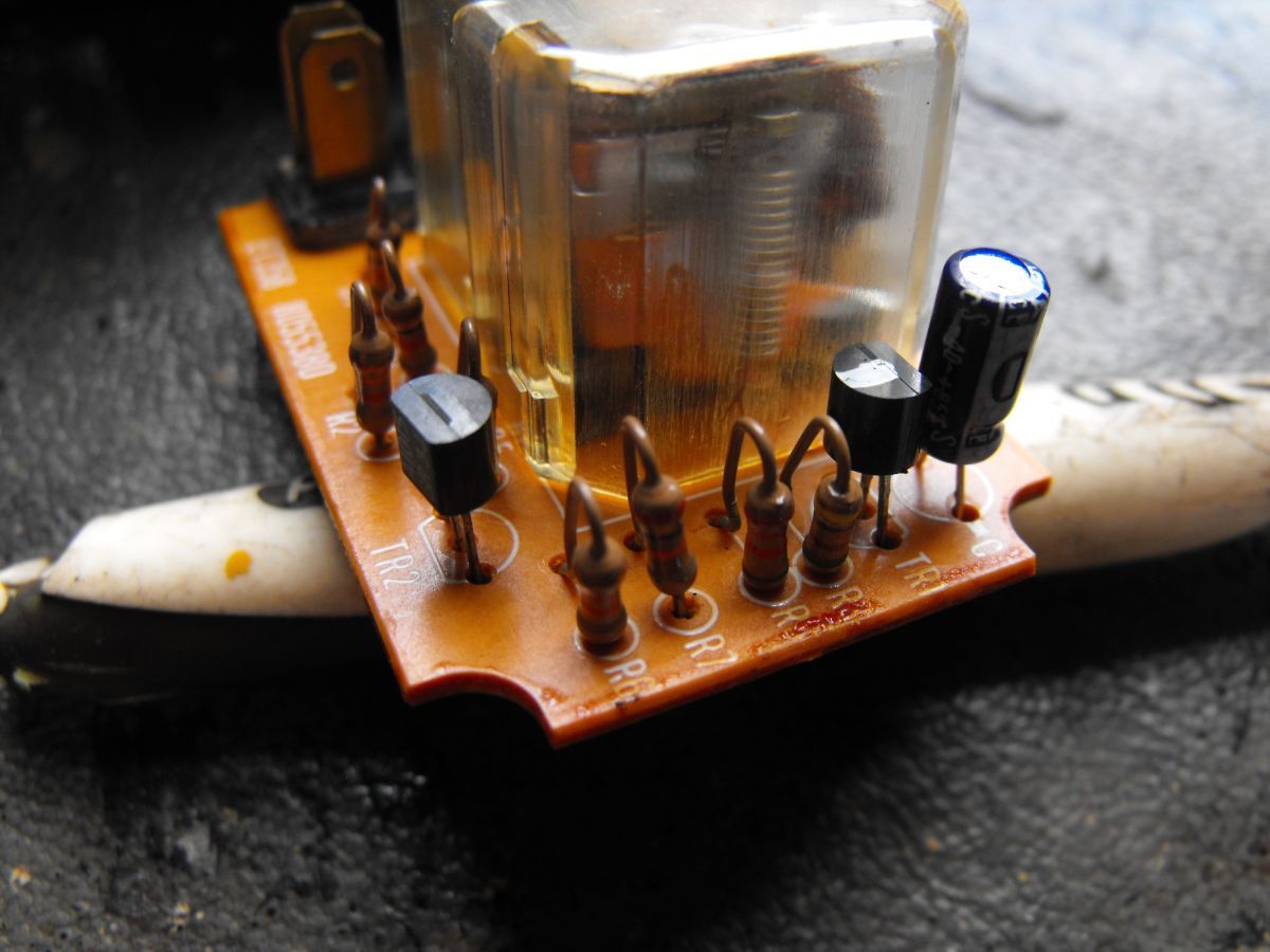

Studebaker1960 Posted July 18 Report Share Posted July 18 That last post by Randy R. is very helpful. I have the exact same truck....'84 Nissan 720 4x4, and fuel pump issues as he describes. The last guy had done the same thing as Randy did when replacing the fuel pump......cut the positive wire between the "connector" and the pump, and soldered the new pump to that cut wire. The existing pump and filter are not that old, but not working. I get no power at the pump wire, but have not pulled the connector to see if there is corrosion or a short there. However, I removed the Fuel Pump Relay, took it apart, and it looks brand new, no cracked solder joints, etc. When I turn the key to "On", I hear this relay "click". There is power coming to it on the dark blue wire, as it should. However, there is no power going out of the relay on the white/black wire that goes to the fuel pump. There is power at the yellow/green wire which is beside the white/black wire, and I dont know why that is. I ordered a new $50 relay, but I am betting that this is not the problem. Until it arrives, I will go ahead and pull that connector beside the fuel pump, and check for a short or corrosion. There is a "Timer" control unit under the passenger seat......does that have any impact on the fuel pump? Will repost what I find out. Here are some pics of the relay and connections: Quote Link to comment

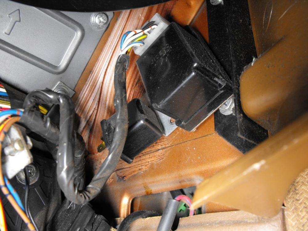

datzenmike Posted July 19 Report Share Posted July 19 Timer under the seat is the interior light timer. After closing the drivers door the interior light stays on for 30? seconds then goes out. Make a jumper and connect the L (Nissan code for Blue) to the WB (White/Black) wires. This will send power from ignition switch to the fuel pump around the pesky fuel pump relay. This will get you going but is not a fix of the relay. The pump relay is there to shut off the fuel pump in the event of an accident. You don't want fuel pumping when you are not in control. Quote Link to comment
banzai510(hainz) Posted July 19 Report Share Posted July 19 nIce truck. i wouke have depinned the power wires bypassed using the current function of the meter. meter will be in series and 10anp should be enuff scale. Quote Link to comment
