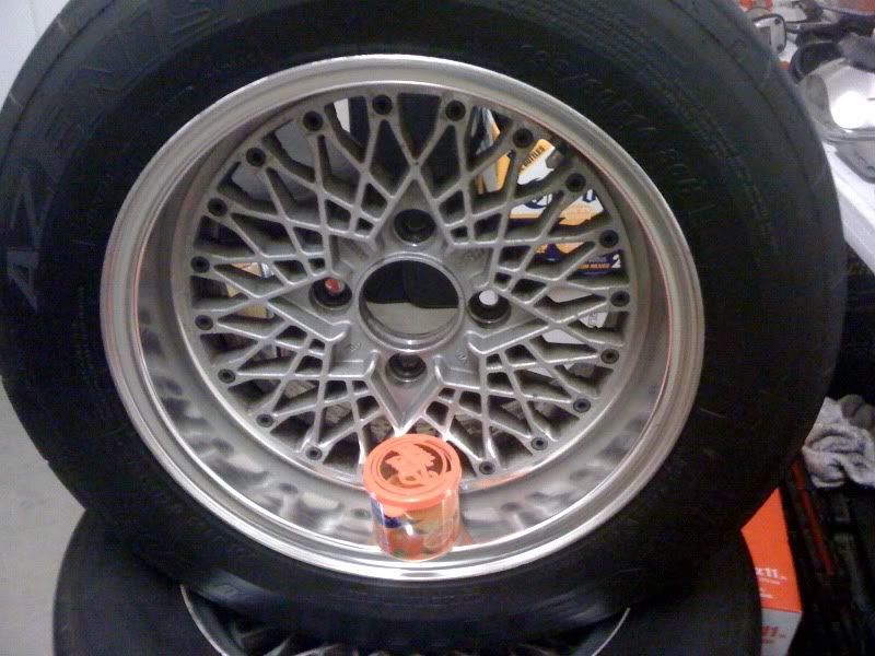

Docsis510 Posted November 25, 2009 Report Share Posted November 25, 2009 I want to buy these rims but im not shure they will fit my 2dr. they are 14x7 +1 offset. Quote Link to comment
NorCalDime Posted November 25, 2009 Report Share Posted November 25, 2009 (edited) yes. with plenty of room Edited November 25, 2009 by NorCalDime Quote Link to comment
ichorid Posted November 25, 2009 Report Share Posted November 25, 2009 True facts. I have 14.7 +1 on mine. 280zx up front 0 probs Quote Link to comment
Docsis510 Posted November 25, 2009 Author Report Share Posted November 25, 2009 Cool thanks guys. What tires should I run on these? Quote Link to comment
banzai510(hainz) Posted November 25, 2009 Report Share Posted November 25, 2009 fit ck first. I had Panasports with 0 offset and would not fit my 510. Fit a 280Z perfect. Quote Link to comment
datto510 Posted November 25, 2009 Report Share Posted November 25, 2009 Autobahns? Quote Link to comment
Cuts metal like mad Posted November 25, 2009 Report Share Posted November 25, 2009 Had 14x7 0et on an old 510, fit fine in the rear and stuck out about 1/4" in the front. Tucked all around after 280zx strut swap. Quote Link to comment
mazdat Posted November 25, 2009 Report Share Posted November 25, 2009 I want to buy these rims but im not shure they will fit my 2dr. they are 14x7 +1 offset. these will fit for sure, and i'm in Irvine, real close to you http://forum.ratsun.net/showthread.php?t=17466 :D:D:D Quote Link to comment
Docsis510 Posted November 26, 2009 Author Report Share Posted November 26, 2009 yeah i saw yours they look good. i text you about them. the other guy is willing to take 500 for them thats why im going that route. im thinking its a good deal. Quote Link to comment

mazdat Posted November 26, 2009 Report Share Posted November 26, 2009 yeah i saw yours they look good. i text you about them. the other guy is willing to take 500 for them thats why im going that route. im thinking its a good deal. 500 is ok, but you won't be able to run those tires on your 510, by the time you get tires, you're close to my price:), i PM'd you, thanx Quote Link to comment
NorCalDime Posted November 26, 2009 Report Share Posted November 26, 2009 500 is ok, but you won't be able to run those tires on your 510, by the time you get tires, you're close to my price:), i PM'd you, thanx i dont see why those tires wouldnt fit? I had 195 60 15s on my car in rear , then i had 205 55 15 rear and 205 50 15 front. Quote Link to comment
mazdat Posted November 27, 2009 Report Share Posted November 27, 2009 i dont see why those tires wouldnt fit? I had 195 60 15s on my car in rear , then i had 205 55 15 rear and 205 50 15 front. what size are the tires? i know that they are 14's, on the pic they look a little too big. Quote Link to comment
NorCalDime Posted November 27, 2009 Report Share Posted November 27, 2009 what size are the tires? i know that they are 14's, on the pic they look a little too big. they look like 195 60 14 Quote Link to comment
mazdat Posted November 27, 2009 Report Share Posted November 27, 2009 so they should fit then Quote Link to comment
