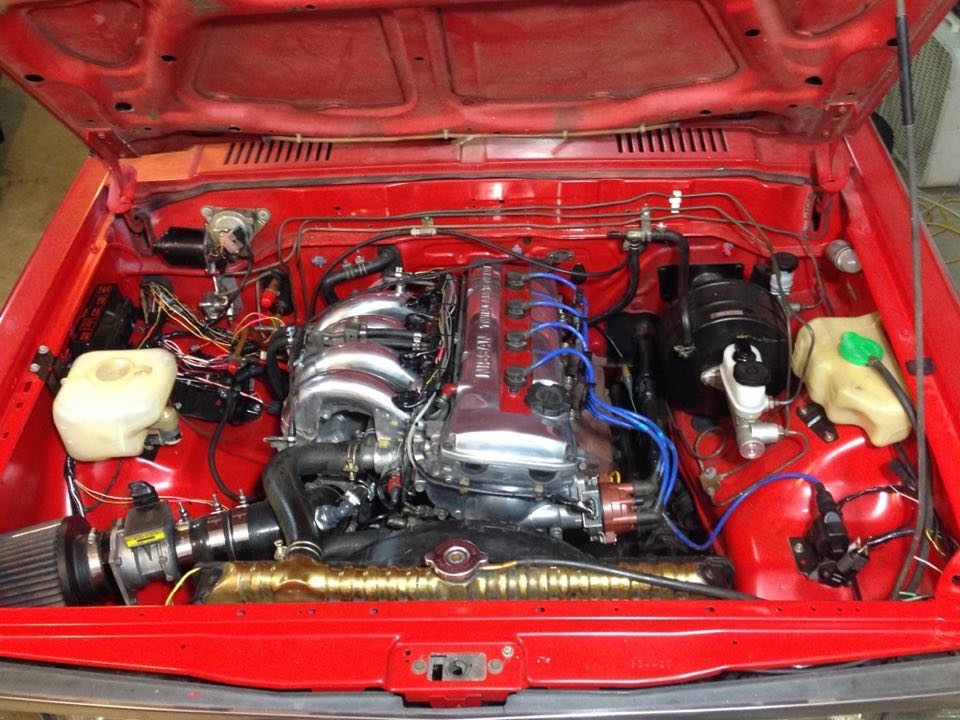

Wildcat Walker Posted April 12, 2023 Report Share Posted April 12, 2023 (edited) I did one of the first KA24DE swaps into 720, and SR20det into 620. Wiring the 720 was twice as hard as the 620, the engine and chassis harnesses on 720 are far more complex than the 620. And I didn't use a can am box. If you don't have the ability or patience to interpret schematics and translate that into a dirty old harness, then don't try it. Edited April 12, 2023 by Wildcat Walker 1 Quote Link to comment
