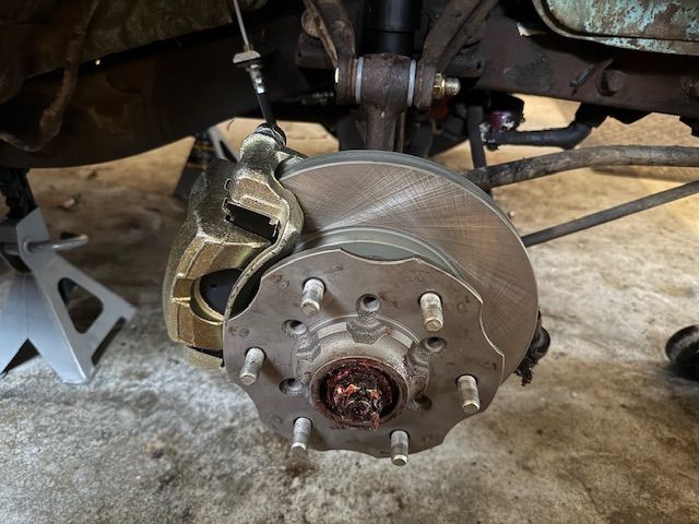

Slow Loris Posted March 16, 2025 Author Report Share Posted March 16, 2025 Long cold winter! Been sitting on some hyper rare NLA Mike Klotz stuff—disc kit and UCA bushings finally installed. Not quite done, have to finagle a brake line a little better and test it out. Conveniently though already had the 620 master and hoses in place so no need to fork around with changing out adapters or flare nuts. I won’t count my chickens yet but…not too hard! It seems in hammering out the old uca bolt I’ve uncovered some kingpin slop I didn’t know I had or else I upset something. So, that’ll be fun. Oops forgot the dust cap. Big thanks to @mklotz70 for tech support! 3 Quote Link to comment

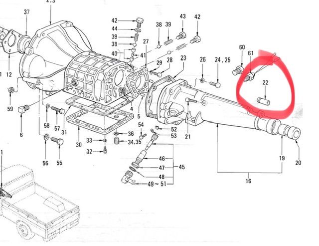

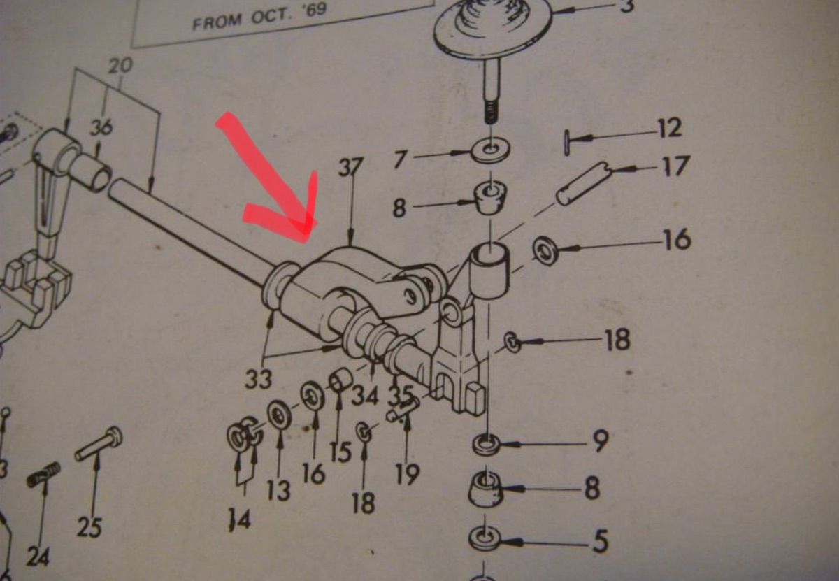

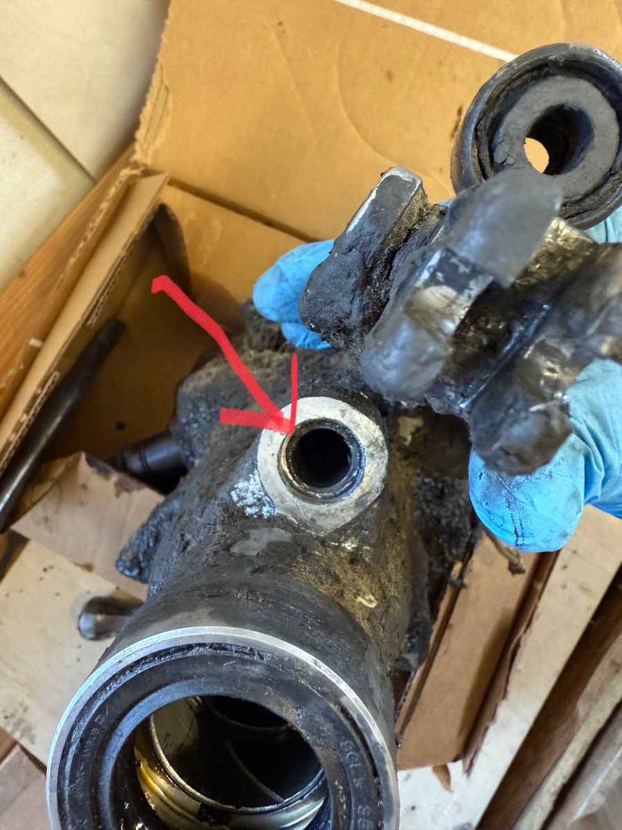

Slow Loris Posted March 23, 2025 Author Report Share Posted March 23, 2025 Some time ago I broke one ear off my #37 here, so it’s all held in by one side with a bolt now, I would like to fix it but I can’t quite figure out how this #22 comes out: Is it just pressed in there? Bang it out with a drift? I have a donor transmission tail section on my bench so I have a pretty good look at what’s going on in there: Looks like a pretty thick sleeve with a little seal on the end. I see others who have had this problem had the ear welded back on. Probably because they are smart and this isn’t worth it. My other thought is…is it possible to install the donor tail section I have while the rest of the trans is still on the truck? Quote Link to comment
