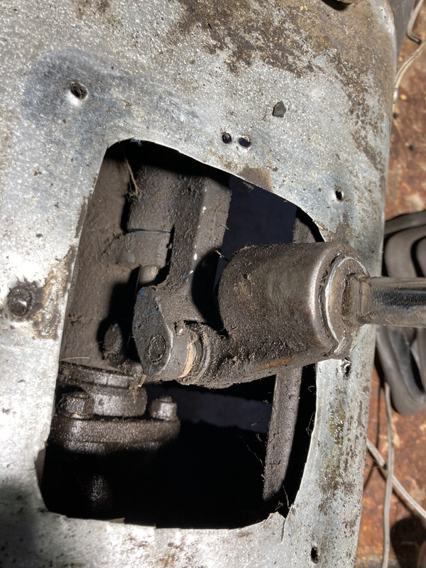

Slow Loris Posted October 18, 2022 Author Report Share Posted October 18, 2022 Any thoughts on where to source a shift lever for my Monkey Butt shifter?…PO put a short one in and it’s not ideal in my mind. I don’t see them as very widely available, but maybe they are more simple than I’m thinking? Looks like there’s a slot down near the base so I can’t just thread and bend a rod myself without that right? 1 Quote Link to comment
pidge Posted October 19, 2022 Report Share Posted October 19, 2022 The shifter arm itself? I’ve seen them on eBay. -Pidge 1 Quote Link to comment
Slow Loris Posted October 19, 2022 Author Report Share Posted October 19, 2022 Oh, yeah for an arm and a leg. $150 I think on eBay. Beggars can’t be choosers I guess. On principle I can’t do it. Can’t find anything older than ‘78 in the junkyards and those would only run me $5 if they fit. 1 Quote Link to comment
Crashtd420 Posted October 19, 2022 Report Share Posted October 19, 2022 (edited) 9 hours ago, Slow Loris said: Oh, yeah for an arm and a leg. $150 I think on eBay. Beggars can’t be choosers I guess. On principle I can’t do it. Can’t find anything older than ‘78 in the junkyards and those would only run me $5 if they fit. I think I have what you need on my shelf in the garage.... it's just the rod with the bushing... I'll check later... I'll just take the arm no leg.... No seriously cover the shipping and its yours.... I'll message you later.... Oh dont mess with the pivot pin... its held in by a tiny roll pin and you can break the aluminum ear if not careful.... the bottom pin is removable, should be a c clip.... that can be shimmed to take out some slop also.... Edited October 19, 2022 by Crashtd420 1 Quote Link to comment
Slow Loris Posted October 19, 2022 Author Report Share Posted October 19, 2022 @Crashtd420 really that would be awesome! Much appreciated. Sure sure an arm, shipping, whatever! Okay good to know I haven’t fiddled with anything yet. I’ll be careful with it. Yes seems like I will inevitably be pursuing the slop sooner or later…there sure is an awful lot of character in these trucks.. 2 Quote Link to comment
Crashtd420 Posted October 19, 2022 Report Share Posted October 19, 2022 So this is what I have.... I got it with some other stuff just like you see it... not sure how stuck the shifter knob end is, looks like someone just pulled the knob off... Should come off with a little heat.... I can separate both ends just to make sure they come off and its something you can use.... I'll probably do that either way for my own piece of mind... If you want it it's yours, send me a private message with your info and I'll see what it takes to ship it.. 2 Quote Link to comment

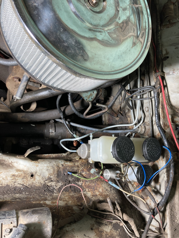

Slow Loris Posted February 8, 2023 Author Report Share Posted February 8, 2023 Whooooeee it’s been so cold in that there garage hence no update. Been fiddling with a few things: Found a very slight leak from brake m/c dripping into the cab so decided to convert to a dual res master cylinder. I went with a drum/drum setup I’m sure one day I may regret but it worked well. Big thanks to @mklotz70 for the pushrod! Ended up bending all new steel lines for the front half, left the rear alone. Had to use two new blocks because the original was f’ed up when I removed one of the flare nuts. All went off without a hitch. I used a m/c from Centric that rock auto says fit I think a ‘73 620 drum/drum truck. Also stripped one of my banjo bolts on the front brake but found that a ‘94(?) D21 hose fits perfectly you just don’t need the fitting anymore and matches up with the nut as is. Neat tip in case anyone else has a screwed up 521 banjo. Also widely available. put in a new clutch master too as that was REALLY leaking into the cab, and did the slave too as cobwebs and skeletons were falling out of the old one. Found some seats that work well. Volvo S40 2007(?) they re a little thick in the back but very comfy and what I really like is the spacing was perfect for the mounts I already had from PO (who also had buckets in—they were just trashed). Had a fun gremlin where only high beams were on no low beams and found that my steering column was not acting as a good ground for some reason. The spline was a really good ground, but the contact between collar of switch and column wasn’t doing it, so fixed that and now have four working lights as they should but god knows where they aiming. More floor grinding to be done working on taillight wiring now…so much good advice here I don’t even have to post questions! Thanks all! New masters test fit of Volvo bucket and shiny floor plus a much better shifter courtesy of @Crashtd420 2 Quote Link to comment
