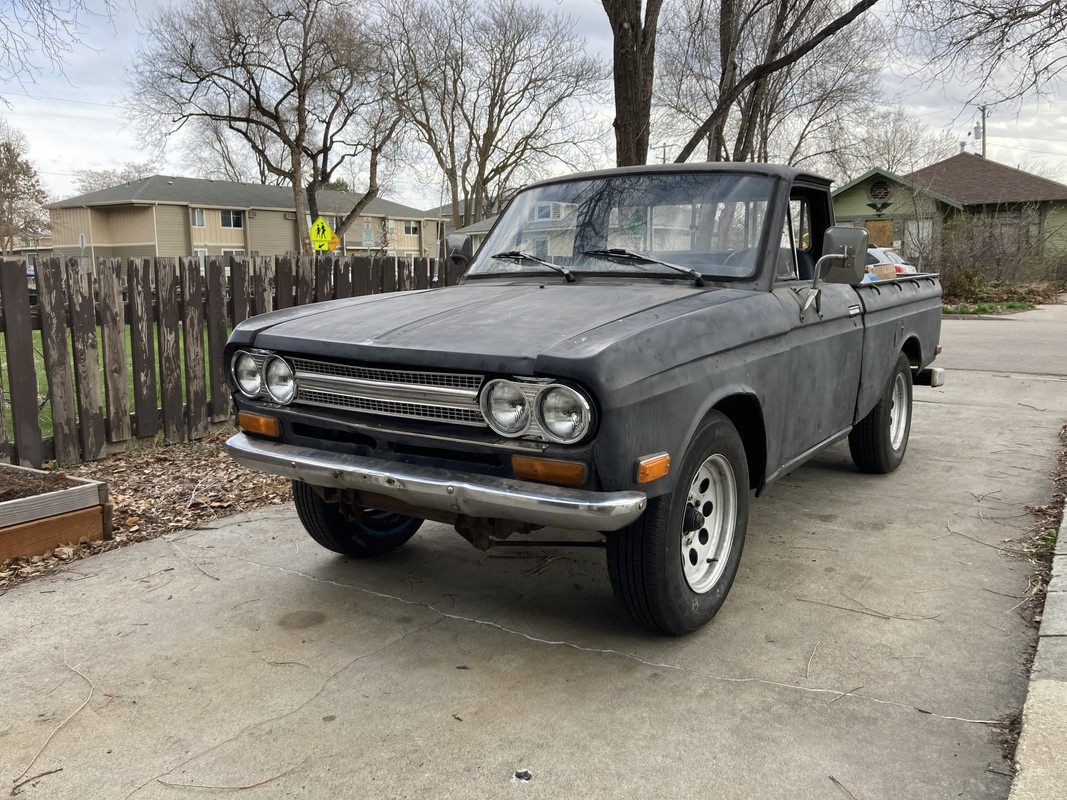

Slow Loris Posted March 31, 2023 Author Report Share Posted March 31, 2023 On 9/18/2022 at 5:38 PM, datzenmike said: See if the build date is on the driver's door jam. If the build date is July '69 or after then it's a '70 model year truck. You definitely have an L series engine and that's a lot of work to replace a J13 in a '69. Cylinders 3 and 4 really jumped when oil was sealing the rings. Compression down near 100 is not good. Get running and check the choke does shut off, check the valve lash. Does it over heat? Does it use coolant? Drive it a few miles and retest. Some compression may come back but don't hold your breath. So when you said that’s a lot of work to replace a J13 in a ‘69 with an L series…a lot of work like you’d do a frame/body swap?? Seems extreme… I just uncovered the spot on the frame with the car number and it’s a PL…obviously non-matching to the car number on the engine bay plate. Or maybe the cab/cowl is what was swapped and most of the truck is more like PL and less like 1969? Curious. Quote Link to comment
sick620 Posted April 1, 2023 Report Share Posted April 1, 2023 (edited) Our truck is a 69. I thought that they all came with l16 in 69 I guess I was wrong. Also 69 had the little round side markers. Not the square ones that yours has. So some things have obviously been swapped around on this truck.. If you need any parts or help working on it we are in Payette Idaho. Come by some time and we will lower it 😉 Edited April 1, 2023 by sick620 Quote Link to comment
thisismatt Posted April 1, 2023 Report Share Posted April 1, 2023 My 69 that came with a J13 and has 1300 emblems says otherwise Quote Link to comment
sick620 Posted April 1, 2023 Report Share Posted April 1, 2023 (edited) 39 minutes ago, thisismatt said: My 69 that came with a J13 and has 1300 emblems says otherwise Hmm edited my comment... I guess 69 had L16 as an option? or possibly 1st half of 69 trucks were L521 and second half were PL521? That's crazy. A little ratsun research and I see now that 69 and before had the round markers, and 70 and after had square, So your truck has different fenders and bed, or someone titled it as a 1969 slow loris. Edited April 1, 2023 by sick620 Quote Link to comment
thisismatt Posted April 1, 2023 Report Share Posted April 1, 2023 51 minutes ago, sick620 said: Hmm edited my comment... I guess 69 had L16 as an option? or possibly 1st half of 69 trucks were L521 and second half were PL521? That's crazy. A little ratsun research and I see now that 69 and before had the round markers, and 70 and after had square, So your truck has different fenders and bed, or someone titled it as a 1969 slow loris. There seems to be crossover with a lot of Datsuns. Another thing on 69's is they still had the lever actuated locks, but already had the bosses on the top of the door for the lock knobs that would start the next model year. Quote Link to comment
Slow Loris Posted April 1, 2023 Author Report Share Posted April 1, 2023 10 hours ago, sick620 said: Hmm edited my comment... I guess 69 had L16 as an option? or possibly 1st half of 69 trucks were L521 and second half were PL521? That's crazy. A little ratsun research and I see now that 69 and before had the round markers, and 70 and after had square, So your truck has different fenders and bed, or someone titled it as a 1969 slow loris. Oh, the bed too? The front fenders definitely non matching to the rest of the truck I’m guessing from the paint underneath the black.The bed is the same color as most of the rest but I guess odds are pretty good you’d find a baby blue Datsun bed. Yeah so the cowl id plate indicates an Oct 68-Jun 69 date (J13) while the frame would be an Oct 69 to Jan 70, according to thread..somewhere. The doors also don’t match…Ha! someone tried pretty hard to keep this truck on the road! Now it’s my turn. Quote Link to comment
Stoffregen Motorsports Posted April 1, 2023 Report Share Posted April 1, 2023 Automotive mysteries keep them interesting. Changeover years are always a free for all where specifications are concerned. All vehicle manufacturers have been known to build vehicles that aren't supposed to exist during those transitions. New models get parts meant for older models and vice-versa. Quote Link to comment
sick620 Posted April 2, 2023 Report Share Posted April 2, 2023 (edited) 12 hours ago, Slow Loris said: Oh, the bed too? The front fenders definitely non matching to the rest of the truck I’m guessing from the paint underneath the black.The bed is the same color as most of the rest but I guess odds are pretty good you’d find a baby blue Datsun bed. Yeah so the cowl id plate indicates an Oct 68-Jun 69 date (J13) while the frame would be an Oct 69 to Jan 70, according to thread..somewhere. The doors also don’t match…Ha! someone tried pretty hard to keep this truck on the road! Now it’s my turn. So the frame was a PL521 frame and no modifications were needed to run that L18 and transmission it all bolted up correctly. Your cab is definitely a bit earlier "J" cab as indicated by that cowl plate since your floor had to be cut to accommodate the L Series transmission. Fenders are later model like your frame or later, as well as bed. So possibly someone had a wrecked or beat up PL521 that needed a cab and they found a parts truck.... Our 1969 truck was from florida originally and although spec wise it is obviously a 1969 it is titled as a 1970 simply because it took so long to get them across the country so by the time it sold it was titled later. I tell everyone we have a 1969 521 because that is technically what it is... Seems like you are in the opposite situation, titled as 69 because of your cab, but it is really a 1970 because of frame, fenders, and bed. Also I want to add that there is a reasonable chance that is an imported JDM motor. My first datsun was a 79 620. It had an L18 with A87 peanut head (not a combo that came in that year). Ended up being a "peanut head" and was a jdm imported motor. In the 80's and 90's it was sometimes cheaper to import a low mileage Jdm motor for these trucks apposed to rebuilding, and L18 is a rare motor in the USA otherwise... If so I have a running L20B on an engine stand I'll trade you 😉 haha JK but worth taking apart for rebuild and seeing if it is in fact a peanut head. Edited April 2, 2023 by sick620 Quote Link to comment
thisismatt Posted April 2, 2023 Report Share Posted April 2, 2023 Door locks, fender & bed marker lights, frame...all indicating a 70-71 1 Quote Link to comment
Slow Loris Posted April 2, 2023 Author Report Share Posted April 2, 2023 Very interesting! Thanks all, for the history lessons. What other secrets are in there…oh yeah maybe this one: 13 hours ago, sick620 said: Also I want to add that there is a reasonable chance that is an imported JDM motor. My first datsun was a 79 620. It had an L18 with A87 peanut head (not a combo that came in that year). Ended up being a "peanut head" and was a jdm imported motor. In the 80's and 90's it was sometimes cheaper to import a low mileage Jdm motor for these trucks apposed to rebuilding, and L18 is a rare motor in the USA otherwise... If so I have a running L20B on an engine stand I'll trade you 😉 haha JK but worth taking apart for rebuild and seeing if it is in fact a peanut head. Only one way to find out I guess! Quote Link to comment
Stoffregen Motorsports Posted April 2, 2023 Report Share Posted April 2, 2023 15 hours ago, sick620 said: Also I want to add that there is a reasonable chance that is an imported JDM motor. My first datsun was a 79 620. It had an L18 with A87 peanut head (not a combo that came in that year). Ended up being a "peanut head" and was a jdm imported motor. In the 80's and 90's it was sometimes cheaper to import a low mileage Jdm motor for these trucks apposed to rebuilding, and L18 is a rare motor in the USA otherwise... If so I have a running L20B on an engine stand I'll trade you 😉 haha JK but worth taking apart for rebuild and seeing if it is in fact a peanut head. Used to buy them for $300 from a shop in Oakland. I forget the name if the shop. Quote Link to comment

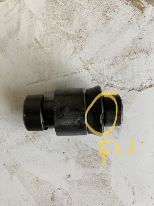

Slow Loris Posted April 17, 2023 Author Report Share Posted April 17, 2023 (edited) We are running. We are driving. And now…most ELUSIVELY…we are STOPPING! Brakes brakes brakes! I pretty much started from square one after somehow still not having brakes. It seemed like my (new) master was defective as I went to bench bleed it again, and the front circuit would push fluid out…then suck it right back in, bubbles and all. So I had a replacement, different model, and that bench bled just great. Hooked it up and…still no brakes. So…took off the drum on my first guess and found this little turd: Nice little chunk taken out of the rubber there. Replaced it. And now… BRAKES!!! OH YEAH. Edited April 17, 2023 by Slow Loris 6 Quote Link to comment
