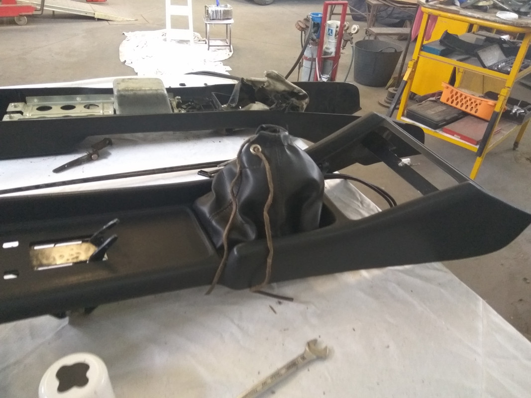

Things to do…
And we all star the mechanical part…new parts arrive…
Meanwhile they arrive and put in place…
Cleaning parts…

Center console up-grade
https://i.postimg.cc/xTzpF7Q5/IMG-20181117-143117.jpg[/img]
My car is a second series from March 1971, but the previous owner changes some details, and the center console was one of them.
I bought a series II to make this up-grade to make the car as much original I can. This console is much more attractive than the other…I’m extremely happy with the final result.
Even the leather pattern has small disserences…

The center console got the texture too and the result was great!
