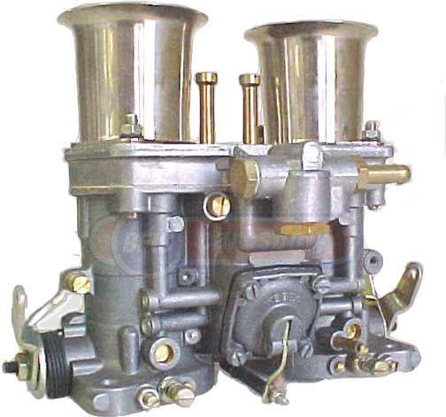

ricky Posted July 7, 2011 Report Share Posted July 7, 2011 Hey I found this on a web site but there way to much new. So I hope some one here has one. In Sacramento here's a pic 1 Link to comment
Wide14u Posted July 7, 2011 Report Share Posted July 7, 2011 is it side draft to a regular manifold Link to comment
ricky Posted July 7, 2011 Author Report Share Posted July 7, 2011 Yes either with a manifold made for dgev or stock manifold with adapt plate Link to comment
nismo dr Posted July 7, 2011 Report Share Posted July 7, 2011 that seems like a lot of weight to hang off suck small fasteners Link to comment
ricky Posted July 7, 2011 Author Report Share Posted July 7, 2011 Well I was thinking it would allow a single side draft run better on a l20b then the Other options out there Link to comment
DISLEXICDIME Posted July 7, 2011 Report Share Posted July 7, 2011 the fuel vapor will have to make it around to many bends Link to comment

datsunaholic Posted July 7, 2011 Report Share Posted July 7, 2011 Well I was thinking it would allow a single side draft run better on a l20b then the Other options out there Not with the air having to make 2 90° turns. Plus added distance. A straight sidedraft manifold is the way to go. Link to comment

hobbes_the_cat Posted July 8, 2011 Report Share Posted July 8, 2011 I have heard that the lynx single is the best side draft mani. that adapter looks counter productive for sure. Link to comment
