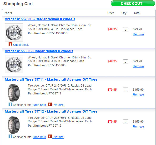

g-mam Posted June 16, 2009 Author Report Share Posted June 16, 2009 Do you think I can fit these size wheel/tire combo on with the suspension stock? Found these in another post. Still having a hard time gettin the size. Quote Link to comment
g-mam Posted June 16, 2009 Author Report Share Posted June 16, 2009 Whill this all work on stock suspension/height? Quote Link to comment

g-mam Posted July 3, 2009 Author Report Share Posted July 3, 2009 My new wheels have been ordered. Fronts, 15x7 In, 6x5.5 Bolt Circle, with 3.75 Backspace. Rear, 15x8 In, 6x5.5 Bolt Circle, with 3.75 Backspace. I didn't know what lugs to order with it. Suggestions? I did get the center caps too. Will be mounting 215/60-15 and 245/60-15 tires on them. Will get them local. Quote Link to comment
