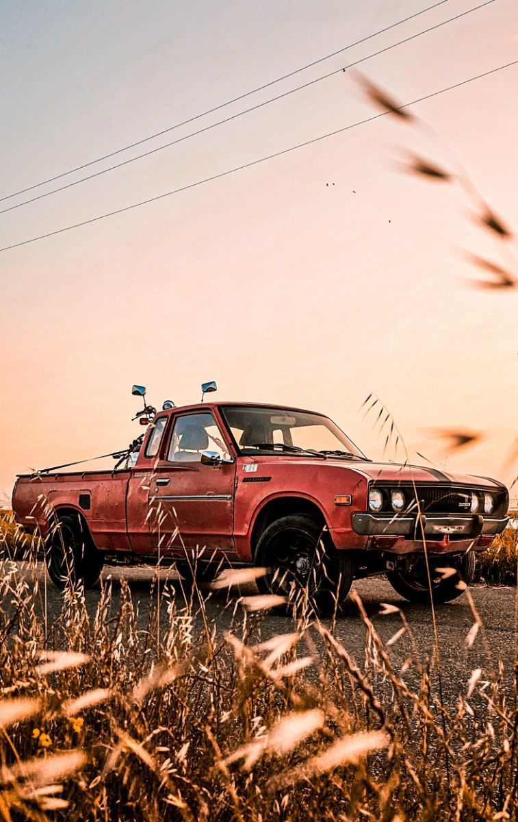

BiLiONS Posted September 5, 2023 Report Share Posted September 5, 2023 Hello everyone! I recently purchased this 620 that has only had one owner since its purchase! (I'd be the second ofc) It has 96k original miles.. im so stocked! It's completely stock and it's definitely mis matched in different areas.. runs and drive but I'm gonna work on it as it is. Any suggestions on first steps? I'm definitely going to get it tuned up this weekend. Thinking about struts since it bounces with a slight push.. im open to suggestions, ideas, thoughts and everything! 3 Quote Link to comment

BiLiONS Posted July 1, 2024 Author Report Share Posted July 1, 2024 Hey everyone! Been a while. So, ill start by saying thank you to explaining the suspension components! I really only want to lower it maybe an inch or so but that would be one of the last things I want to do since its not a priority. I got the datsun driving perfectly and I use it to commute 30 minutes to work and back over a bridge.. little sketchy but its fiiiine. Sometimes I haul my rebel in the bed when I gotta move it from one side of the bay to the other. https://imgur.com/a/R7T2ckW Recent picture I took of it and current interior Changed out: - the old wheels and put on these wider wheels with way newer tires - wasn't a fan of the bigger side view mirrors so I installed these smaller chrome ones - inside was stripped of the old carpet and since it had mismatched seats I took those out and put in some leather seats that are very comfortable - I grabbed some free carpet floor mats and put them inside just for looks - Original steering wheel was cracked and super thin so I got a grant steering wheel and installed it with the horn wired up too - Did the basic tune up and it idles fine, picks up fine, and runs fine as far as I know I use this truck 2 or 3 times a week and its done pretty good for me. Only concern I currently have is that after driving for maybe 10 to 20 minutes, I start hearing a light ticking noise. As revs go up, ticking noise gets quicker. This started after the oil change.. or maybe before that but never noticed. I used Rotella T4 15w-40.. could that have cause that noise to start up? Its a light ticking as the car idles and drives. If it sits for a few hours and turns on, the ticking isn't heard. Its only after it warms up completely If anyone may know of possible causes or what I can do to fix any issue this may sound like, please let me know. I love this thing. Quote Link to comment
