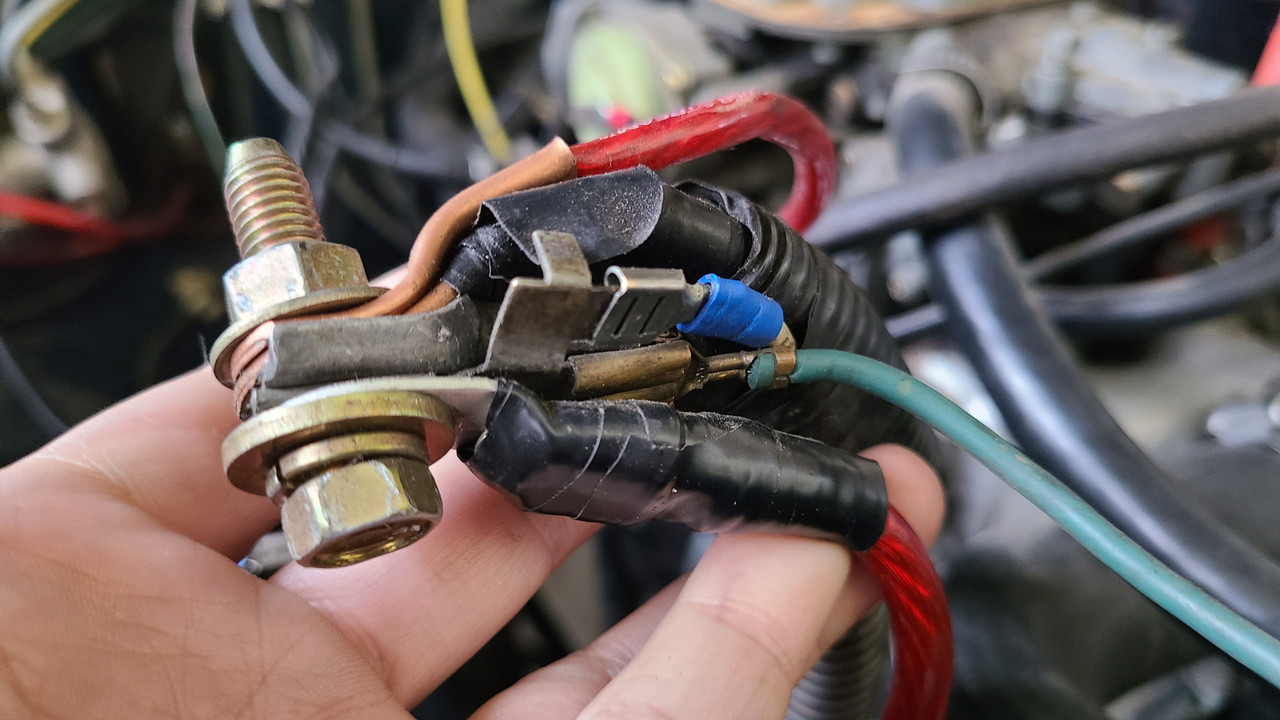

https://postimg.cc/64vVR90n
Closer up
https://postimg.cc/47rVXDgd
Right now all I can tell is that one end of the positive cable goes to the alternator and one goes to the battery cutoff switch in the cab then back to the battery.
Once the rain lets up a little I can  start tracing some more of it, and move the battery to see if I'm missing anything. But I definitely don't see any of the "connectors" (2 white, 1 black) that show up on images of the fusible link, connected to the battery positive.
Does the fusible link show up on any circuit schematics? In my Haynes manual there's only two sentences about it.
  • Like 1
The metal piece in the middle looks like the piece that goes on the positive battery cable clamp screw.  The fusible link wires connected to it.  I would get a longer battery cable bolt and put that mess back on the battery terminal where it belongs.  By doing this it will eliminate the cable the come off the battery terminal lessening the mess.  Never safe to have a bolt with a bunch of positive cable and wires hanging around looking for a way to short out.  Start by cleaning up that mess and when you take it a part clean al terminals.  If you just have to have that setup at least use this instead of the bolt.

Thanks for the clean up recommendation Charlie. This mess was inside of a big rubber tube, not ideal, but a little isolated.
Datzenmike, it goes from the battery terminal, to the cutoff switch, Then back to the 'mess' pictured here.
