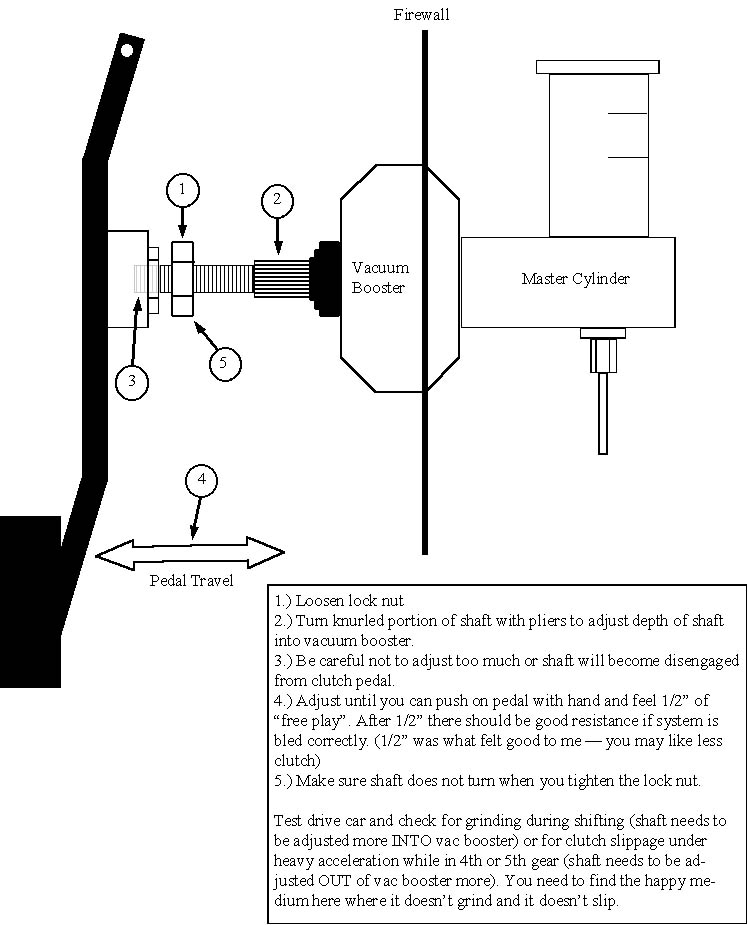

Dawa Posted July 19, 2013 Report Share Posted July 19, 2013 ive never actually looked at my clutch pedal, but i assume it is similar/the same to other, younger nissan clutches. in a z32/s14, sometimes if you swap out clutch components, where your clutch engages/disengages is different. one thing it might be is with the components youre using, your clutch isnt able to disengage all the way. look under your dash at your clutch pedal. if you are able to adjust the rod in there, do it. adjust the rod OUT, as in away from the engine and into the cab (counterclockwise.) heres the link. again this is for a z32, idk if this is your problem but it sounds like it might be http://www.twinturbo.net/nissan/300zx/faq/FAQpages/clutchadjustment.html Quote Link to comment
PineClone Posted July 19, 2013 Author Report Share Posted July 19, 2013 Dawa - yes this is a good idea. However, the problem can't be at the pedal because i completely removed the slave cylinder so that i could be sure the fork was returning the full distance. I really wish the problem was this simple. I'm 99% sure it is internal. Another thought: Some of these trannys had an internal clutch return spring. Based on all that i've read here, it is not needed. And i did not have that part with the tranny that i got from my buddy B210GX. The return spring is shown in my shop manual. I'm beginning to wonder if this was something i should have had. Quote Link to comment
