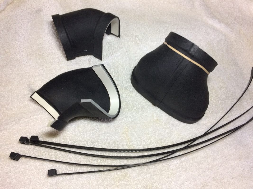

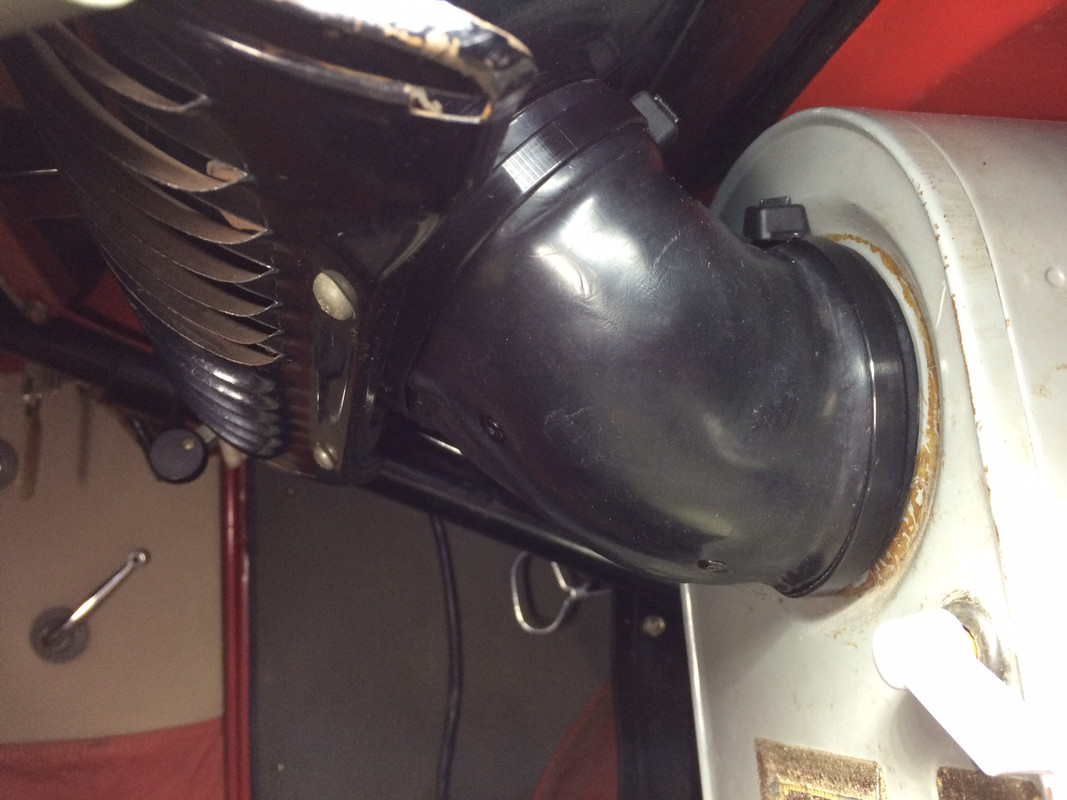

difrangia Posted September 7, 2020 Report Share Posted September 7, 2020 For the defroster hoses I went to a couple of local auto part stores with the diameter and length dimension and found a generic black accordian air-flow hose that fit right in for about $6 each. I do have a couple of the two-piece elbows that connect the heater inlet to the under-dash-fresh-airbox that I made up. Easy to install with two included Zip-Ties. Quote Link to comment
320 Newb Posted September 7, 2020 Report Share Posted September 7, 2020 Steve that elbow looks great! Jake, who's 3D printing the steering boots said he'd also do that elbow if enough people are interested. Does anyone know if that elbow is used on other Datsuns? Roadsters maybe? 1 Quote Link to comment

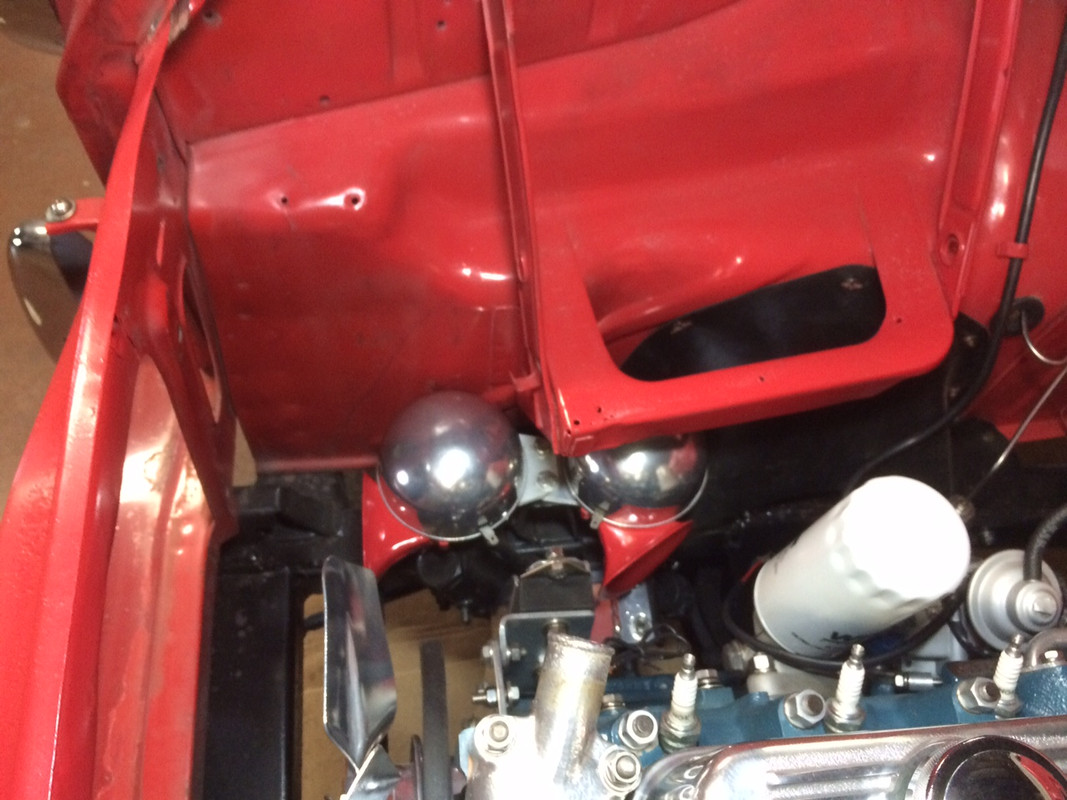

difrangia Posted September 7, 2020 Report Share Posted September 7, 2020 What I've seen so far is that the 320 elbow is common only to the 320. The 520 is similar (I have a pic or two of the 520 elbow) but different on mounting surfaces. I've no idea on the size, shape, and relation of the intake/exhaust openings on the 520 relative to the 320. Anything that we can get re-popped is great for the 320 owners. I also developed a pattern for the front fender inner panel skirts a few years ago. I cut mine out with scissors from 1/16" neoprene. If anyone wants the pattern, message me. That would be a good laser-cut project for someone. I believe that i might still have a cad model for it on one of the old computers. The right skirt is visible in this pic: 1 Quote Link to comment
