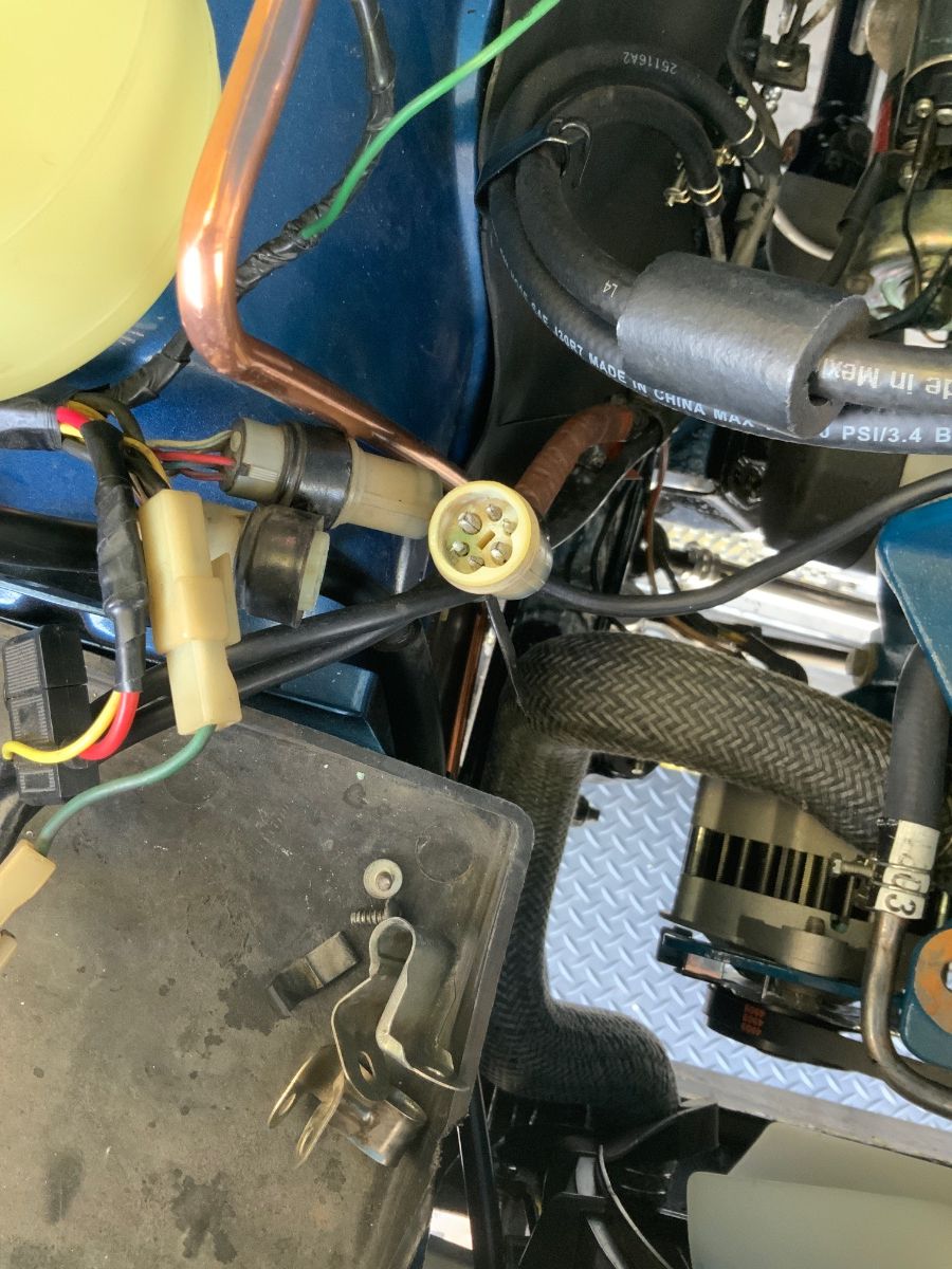

Danz Posted July 4 Report Posted July 4 I have a pin that corroded in the 6 pin connector in the engine compartment of a 1979 Datsun 620 king cab. Does anyone know if the corroded one can be extracted and replaced? Quote
datzenmike Posted July 4 Report Posted July 4 Just polish with some sand paper. Just unplugging and plugging it back in is usually enough to make contact. The pin has a barb the lets it get pushed in to the plastic connector but won't let it be pulled back out. I have had good results with a metal hair pin, hardest part was finding one. Pull or burn the plastic end off and you can slide it down beside the pin and this will push the barb in enough to pull the pin out by the wire. Just clean with emery cloth or SOS pad. These might work... https://racespeconline.com/collections/connector-kits/products/gtr-yazaki-connector-kit-6-pin Your pin is unlikely to be used these days. Quote
Danz Posted July 5 Report Posted July 5 It is not evident in the photo but the pin is barely intact. It wobbles and is ready to fall off. In the aerospace world we have extraction tools to remove pins from the backshells of connectors but the back shells and locking mechanisms are all made of metal. I am not sure automotive uses are the same since they do not have to be maintained in the same manner. Quote
datzenmike Posted July 5 Report Posted July 5 I found the hair pin the thinnest to slide down beside the pin and depress the barb. Quote
banzai510(hainz) Posted July 6 Report Posted July 6 I used tweezers to pull the pins out before. unless the pins are superglued in there they can come out. sometimes the removal is from the front like a old Deutschpin. extraction tools Quote
Danz Posted July 8 Report Posted July 8 All, thanks for all of your suggestions. It turns out it was so corroded all I had to do was tug on the wire to get it out. I have ordered a new pin on Amazon and hope it is the right size. 1 Quote
