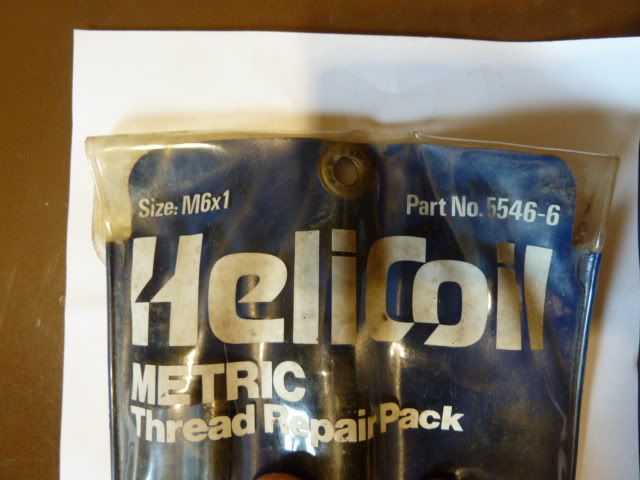

DanielC Posted February 15, 2012 Report Share Posted February 15, 2012 You need a M6 x 1.0 Helicoil kit. The repair is to drill out the damaged hole with the drill recommended by the kit. You then retap the hole with the special Helicoil tap. Then there is a stainless steel insert that looks like a spring, that is screwed into the freshly tapped hole. The outside of the insert matches the new threads, and when screwed into the hole, the inside of the insert form new M6 x 1.0 threads that match the calve cover bolt. When you get the kit, if it does not have the drill. make sure to buy one. It probably is a special size. This is my kit. This is the parts in it. They are really easy to use. The biggest issue is to drill out the damaged hole straight. I suggest you get a small square, and use that to line up the drill before you drill out the hole. Keep drill chips out of the engine, also. Quote Link to comment
