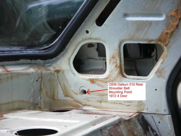

Eriks Posted July 22, 2013 Report Share Posted July 22, 2013 Anyone tried to mount seatbelts in the backseat of the 510? Got two kids... Appreciate all ideas (mounting locations etc...) Quote Link to comment

Eriks Posted July 22, 2013 Author Report Share Posted July 22, 2013 Didn't know that. I have a 71' with no belts in backseat. Want shoulderbelts. Found this photo of upper mount. Lower mounts I assume is underneath the seat? Quote Link to comment
Tristin Posted July 22, 2013 Report Share Posted July 22, 2013 Yes, they are under the seat. They get bolted into the floor... I can provide a picture for you in the morning here. Mine would be a little different as mine is a 69 which is only lapbelts, but the lower mounting is mostly the same. Quote Link to comment
Eriks Posted July 22, 2013 Author Report Share Posted July 22, 2013 Tristin, that would be very kind of you. If you have the time ... :) Quote Link to comment
Tristin Posted July 22, 2013 Report Share Posted July 22, 2013 Of course. My seat is already out so it wont be that big of a deal. Glad to help. Quote Link to comment
Tristin Posted July 24, 2013 Report Share Posted July 24, 2013 I apologize for the delay i pictures... I completely spaced. As promised here are pictures of how my belts mount: One in each corner- Here are the centers mounted: Like I mentioned, mine are only lap belts, but it should point you in the right direction. If youre going for 3-pt belts, you could utilize what I showed you along with the picture you already have and those should be good mounting points. Good luck. Quote Link to comment
