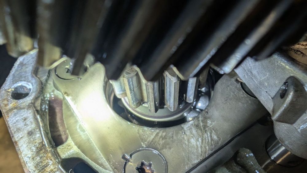

PsychoNaut04 Posted October 3 Report Posted October 3 Was driving on the highway and heard ad odd noise. Suddenly it escalated to a rattling noise. Any advice? It used to make a loud whining noise prior to giving out. And currently im able to change gears with no resistance https://imgur.com/a/l6HXgsd Quote
datzenmike Posted October 3 Report Posted October 3 Most common failure point on the FS5W71B is the front countershaft bearing. Gets noisier over time, usually in all gears but fourth. If not replaced, the bearing comes apart and can damage the front cover or the transmission case. Not much you can do from the outside. Take the fill bung out and check the oil level. You should be able to reach in with a finger and touch the oil if full. If low, top it up, it may quiet down but the damage may already be done. Drain the oil and inspect the drain bung which has a magnet on it that collects ferrous metals. Check the oil for suspended metal particles, if oil is milky that's water that got in. This one has a piece of bearing cage on it. I've pulled one that had ball bearings on it. This is a front counter bearing that has failed. Likely can be saved by replacing it. Quote
PsychoNaut04 Posted October 3 Author Report Posted October 3 9 minutes ago, datzenmike said: Most common failure point on the FS5W71B is the front countershaft bearing. Gets noisier over time, usually in all gears but fourth. If not replaced, the bearing comes apart and can damage the front cover or the transmission case. Not much you can do from the outside. Take the fill bung out and check the oil level. You should be able to reach in with a finger and touch the oil if full. If low, top it up, it may quiet down but the damage may already be done. Drain the oil and inspect the drain bung which has a magnet on it that collects ferrous metals. Check the oil for suspended metal particles, if oil is milky that's water that got in. This one has a piece of bearing cage on it. I've pulled one that had ball bearings on it. This is a front counter bearing that has failed. Likely can be saved by replacing it. Awesome. Thank you Mike. I used to get a sort of turbine noise. And before changing gears it used to make a unique sound. I know there was something off about it. I think it may be bearings. Ill drain the oil today and check. Quote
datzenmike Posted October 3 Report Posted October 3 Check oil level first. If low or empty that's the problem. Topping it up might, I say might, quiet it. It should hold two liters or close to two US quarts of oil. I drained one that had what looked like thick silver paint in it. It was the bearing chewing up the case and two ball bearings came out with it. Quote
PsychoNaut04 Posted October 3 Author Report Posted October 3 1 hour ago, datzenmike said: Check oil level first. If low or empty that's the problem. Topping it up might, I say might, quiet it. It should hold two liters or close to two US quarts of oil. I drained one that had what looked like thick silver paint in it. It was the bearing chewing up the case and two ball bearings came out with it. I remember I did the oil change on my trans not long ago. The oil did seem muddy. So ill check it today. Honestly, i feel the bearing is the issue. Ill confirm. Quote

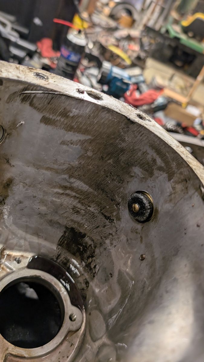

ElliotV Posted Wednesday at 03:10 PM Report Posted Wednesday at 03:10 PM On 10/3/2026 at 8:21 AM, PsychoNaut04 said: Awesome. Thank you Mike. I used to get a sort of turbine noise. And before changing gears it used to make a unique sound. I know there was something off about it. I think it may be bearings. Ill drain the oil today and check. That turbine/howling noise is the front housing getting eaten because your gears are moving. Mine did the same thing before I rebuilt it. My center countershaft bearing went out and the balls remained, if they didn't center perfectly the shaft would move and the gears were eating the aluminum housing. bad bearing worn into housing Quote
PsychoNaut04 Posted Saturday at 05:18 AM Author Report Posted Saturday at 05:18 AM On 10/7/2026 at 8:10 AM, ElliotV said: That turbine/howling noise is the front housing getting eaten because your gears are moving. Mine did the same thing before I rebuilt it. My center countershaft bearing went out and the balls remained, if they didn't center perfectly the shaft would move and the gears were eating the aluminum housing. bad bearing worn into housing Is this something I can fix myself? I’ve been reaching out to shops and it’s around 1k for labour. Quote
