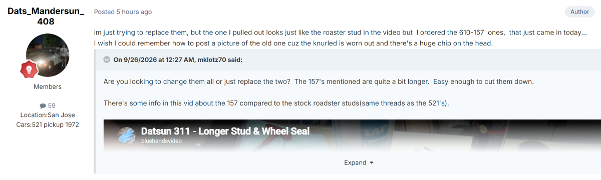

Dats_Mandersun_408 Posted September 29 Author Report Posted September 29 im just trying to replace them, but the one I pulled out looks just like the roaster stud in the video but I ordered the 610-157 ones, that just came in today... I wish I could remember how to post a picture of the old one cuz the knurled is worn out and there's a huge chip on the head. On 9/26/2026 at 12:27 AM, mklotz70 said: Are you looking to change them all or just replace the two? The 157's mentioned are quite a bit longer. Easy enough to cut them down. There's some info in this vid about the 157 compared to the stock roadster studs(same threads as the 521's). Quote
mklotz70 Posted September 29 Report Posted September 29 If you can't get them to work, pm me, I have some extra lugs from an axle I just bent. They'd be $15 shipped....most of that is the flat rate priority shipping. I have a print screen program that allows me to copy a section instead of print.....then I can paste what I've copied into the response.......like below. I typically take pics, send them to my FB messenger, then when opened there, I can do the print screen shot. I've got about 8k of pics on here that are originally stored on photobucket....but that is a complete PITA to use! lol 1 Quote
